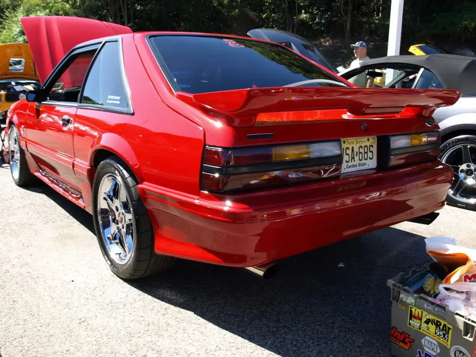

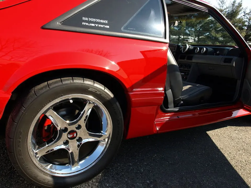

I have Cobra Rs with 275/40/17 Nitto 555 drag radials with my quad shock on and in the stock position with no rub at all, this is why i went with Nittos instead of Mickeys, Nittos in the same size are not as wide.
and this is what it will look like
