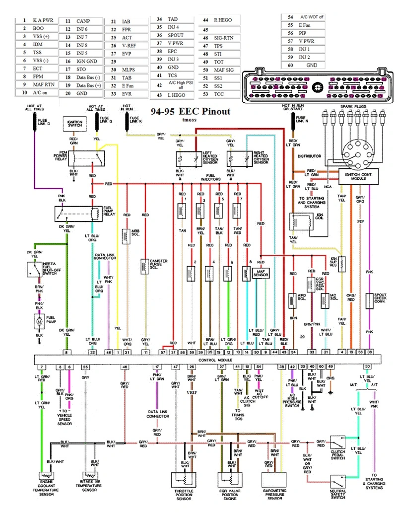

Attached is a wiring diagram showing the fuel pump circuit. Suggest you use it to figure out why you do not have power at the pump.
Check to see if the inertia switch which I believe is behind the left rear tail light was accidentally tripped. If so, reset it.
When you turn the key on you will have power to the pump for about 2 seconds only unless you are cranking the engine. This is to prevent the pump from running when the engine is not.
Check the red and light blue/orange wires which is supposed to pull in the fuel pump relay. Also check the red wire on the relay to make sure it is hot all the time. If these 3 wires check out but you do not have power on the dark green/yellow fuel pump power wire,, it is likely the relay.
Make sure the fuel pump ground wire is properly grounded.
Disconnect the fuel line coming out of the filter and use a rubber hose with hose clamps to attach your pressure gauge to the filter. Verify you have proper pressure there. I have seen bad aftermarket pumps.
