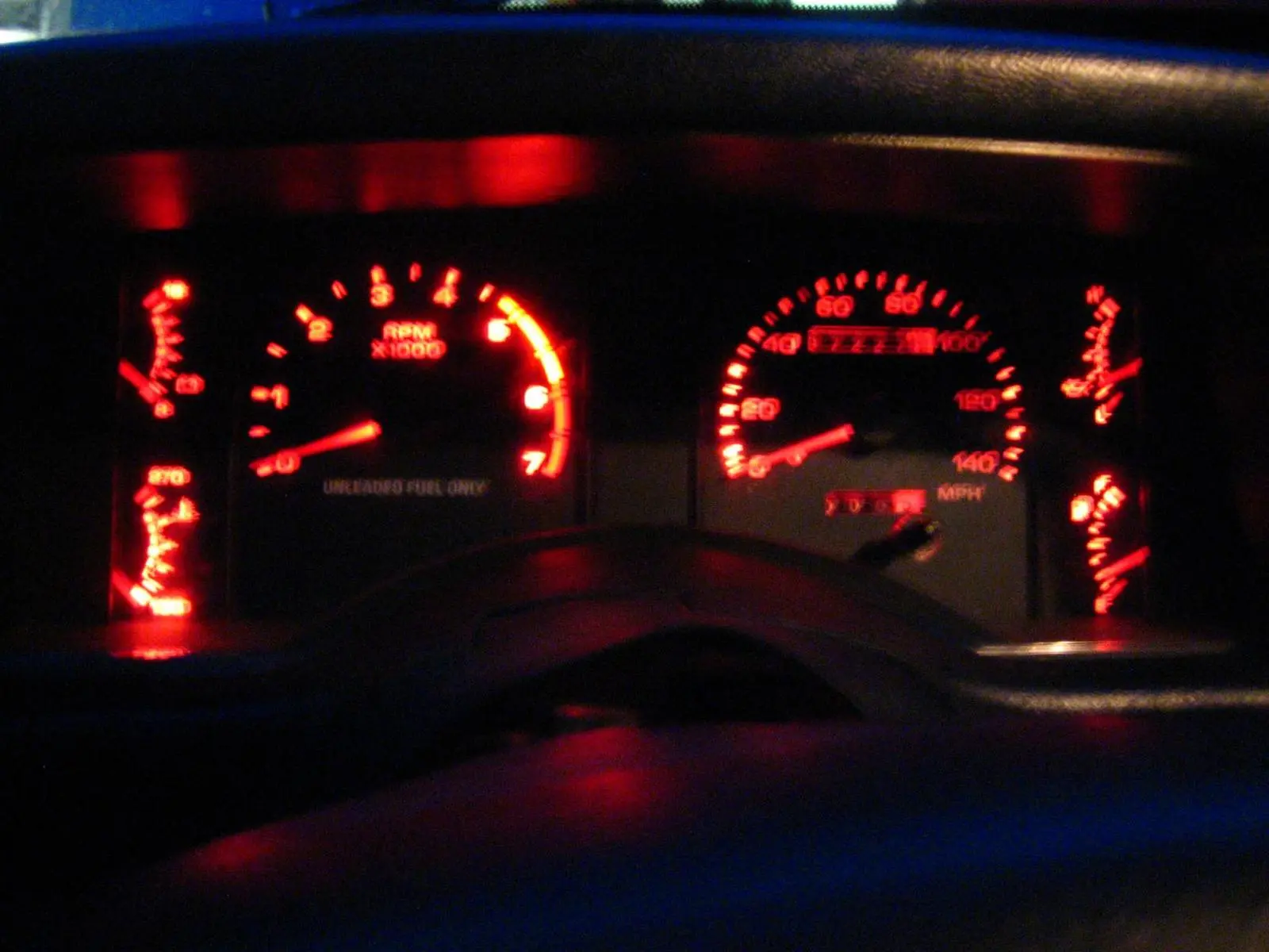

Not as bright as I'd like but it should be a lot better when I get some LED's.
These are just the red 194 bulbs you can get at your local auto store.
Time consuming, but pretty easy.
Rip apart your gauges, scrape off green paint from back with an exacto knife (yellow and red too), strip white off of needles (carefully), paint needles your color (I did red), put back together with your new colored lights!
HVAC are green due to a green paper like backing. I cut this off and pulled it out and added red bulbs.

not to bash on you but i read from another post for someone who did that u didnt have to scrap or remove anything just changing bulb color illuminates everything that color without all the scraping and removing of other stuff
