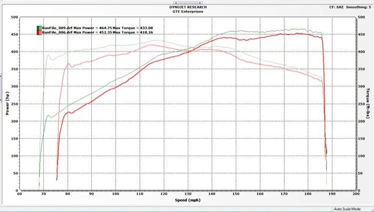

In searching the web this guy did a dyno before and after deleting cats on his 2018GT
EDIT: won't let me link direct to thread
454HP/420TQ with cats and 467HP/434TQ with them deleted. +13HP, +14TQ. Roughly a 3% gain in power.

13hp and 14tq is less than can be gained with a handheld tuner while retaining the cats. There's no real reason to delete cats on a modern car. Some of them are so well engineered that you'll lose power from doing it.

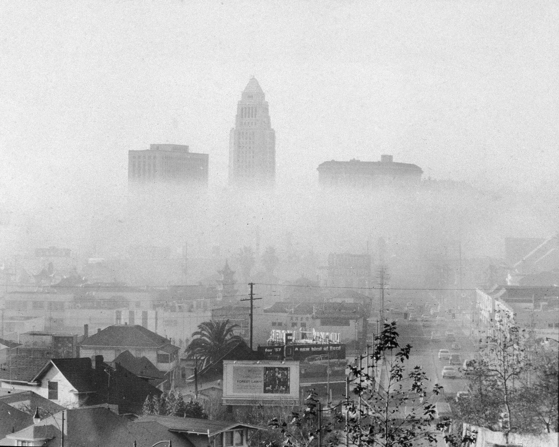

All this talk of cats and off-road pipes got me wondering what it must have been like to walk down a busy street in a crowded city in 1970 with all the leaded gas and lack of catalytic converters.
