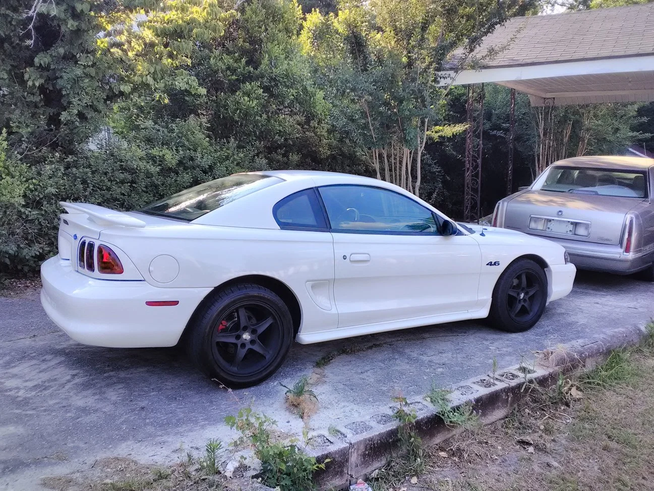

My baby! Side note...... who wants to buy a Cadillac DeVille????? I need to get it out from under my carport so I can put BlancaStang in there. South Georgia hail storms are BAD NEWS for paint and body!
