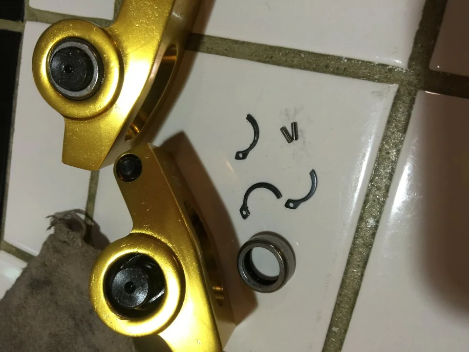

Q: how much rocker arm noise should I expect with .588 lift on a FTI custom cam. I was breaking rocker studs until I swapped the stock AFR ones with ARP's.
If anything I'd say they're border line too tight as I reset them to quite them down, and it did (3/4 turn from zero lash), 1/4 turn is where I started and they were pretty clackity
I'm just wondering if you guys think that much lift would make an audible clicking, I plan to reset them again soon and Mr Curtis says "higher lift will cause a louder valvetrain" which I get.
Just want some input from you guys who are running close to what I am maybe. Dur. is small- 219/[email protected]
it's his "street beast 34xl-hr11" cam with +3* if I'm reading card right.
At any rate I'm going to recheck the rockers but wondered if pretty loud chatter is relatively normal(almost sounds like slight exhaust leak from inside) I have no one to compare to that I know currently.
Thanks guys
