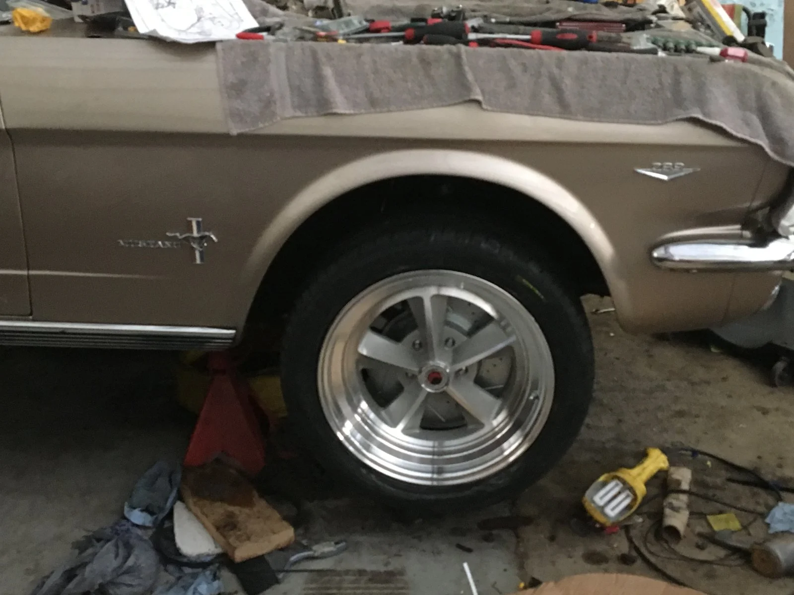

I have 17x8, 4.75 bs Scott drakes. Had to grind on my calipers and still run a .250 spacer. They look great but a pain in the ass to make them fit.

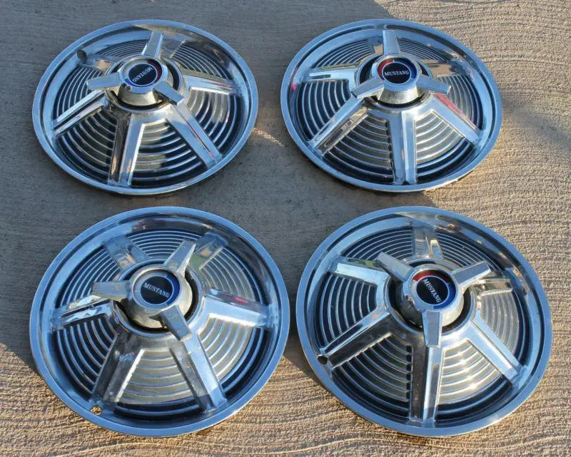

Like this one a lot but only in 13 and 14 inch but will need little brakes for 14 inch tire

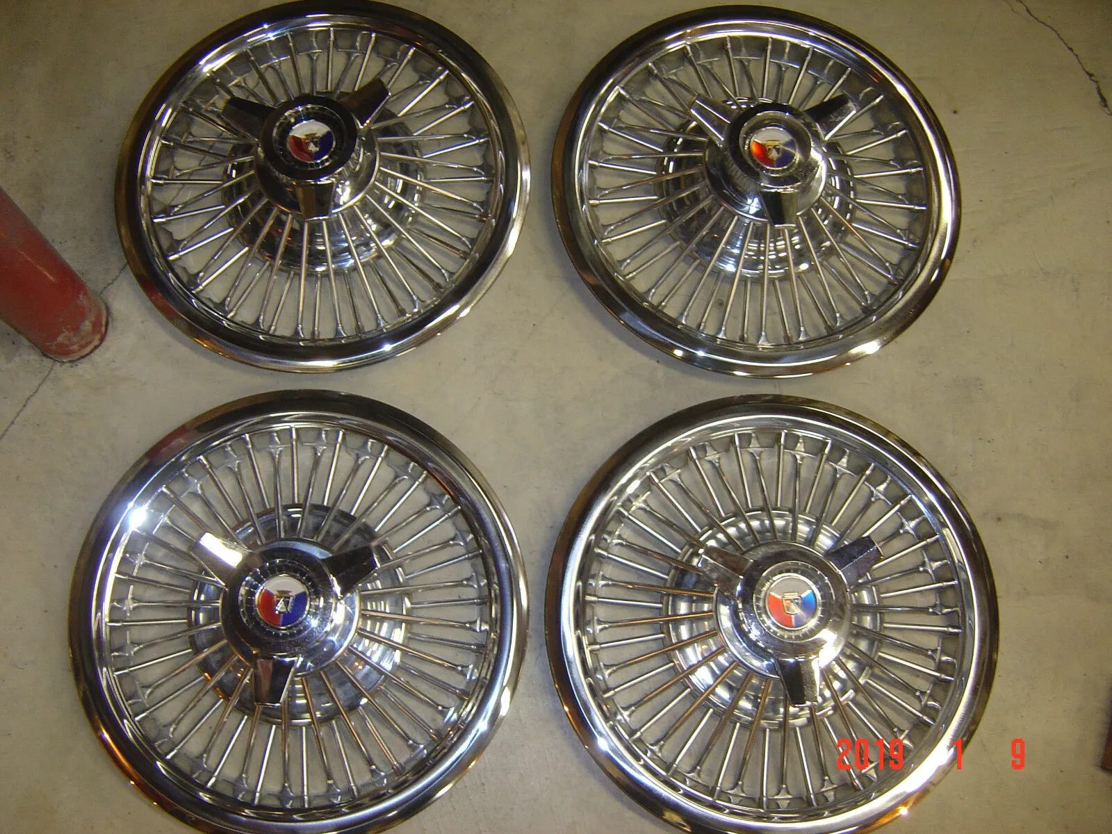

This 15 inch Galaxy is close to one available on the 65
