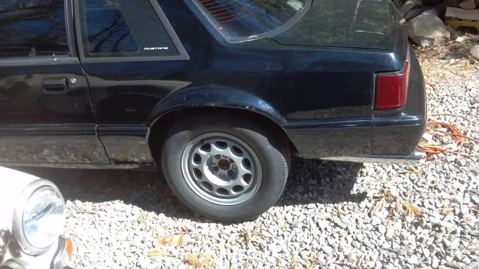

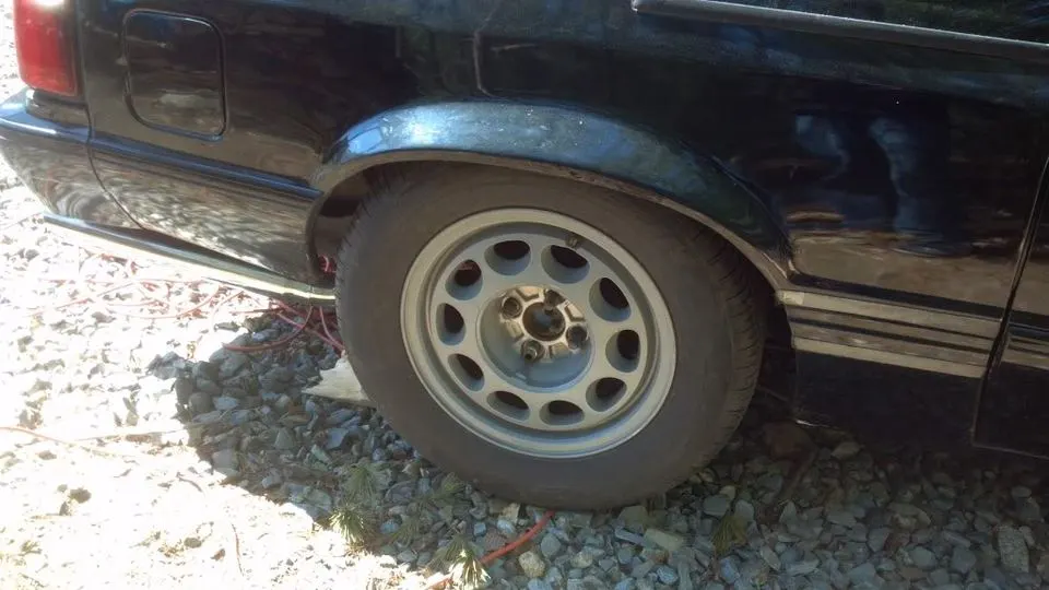

Im about to buy a notch of my buddy and the only thing holding me back is that the right rear sits close to 3-4 inches lower than the left..all other corners of the car sit the perfect height. It was a former drag car so my concern is that its just been launched so hard that it twisted bad. But on the other hand it has aftermarket suspension. What im thinking is that they cut the spring to make it launch straight? Also all body panels, doors, and trunk lid line up perfect. ive attached pics but idk if they will work.

If the car was launched so bad that it twisted the uni-body so much that it sits like that then you most likely wouldn't be able to open and close the doors and/or the body panels would be out of line.
Likely broken spring, bent LCA or something suspension wise. If it is then i'd jack it up and at least check the floor pans and make sure they don't look wavy like a potato chip and the seats are still sitting normal and aren't twisted either.
