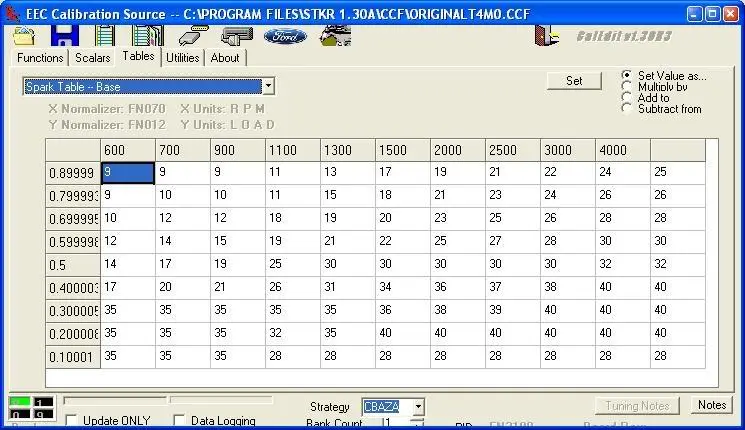

Under tables
"Spark_base_table"
You'll see rpm and load, adjust it accordingly
how many degrees should i add to each, though? should i just add it on the top 2 or 3 rows so it'll only add under wot? and all the way to the end of the row from 2500 to 4000?

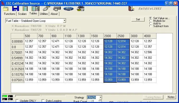

For the fuel, another table
"fuel_table_stabilized_OL"
You'll See rpm and load agian, adjust where u leaned out, adjust the AFR number lower, now since you dont have a wideband and have no way to see your actual AFR, i would normally suggest not to mess with this but since your adding fuel not taking away you may be able to get away with it, but you'll have no way of seeing the effects.
so lowering the first number in the a/f ration (the 14.7 in 14.7:1) adds more fuel?
should i just lower it to, say, a conservative 1 unit in the highlighted columns in the top 3 rows since i can't really tell what my a/r ratio is?
stock cbaza fuel table w/ where i lean out highlighted:
well you see how it says 12.128 in the first highlighted block, lower that number down to say 11.7 for now and it will richen that part up, you really need only be concerend about the top row as that is the WOT row, maybe the top 3 for part throttle blasts, but once you go so low it goes into closed loop. but agian you really have no idea whats going on, a wideband and R/T is a must, I know ive said it and other have said it to you alot, but you have no way of really telling at all what is going on.
Here is what I would do Paul since you have no way of seeing .............
1) Things as they now are ... or a baseline of reference
and
2) Things after tweecs which verify you did either ......
Right :nice:
or
Wrong :notnice:
For now ... I'd only work with the top load row in the spark table
You don't wanna go down 3 rows :nono:

and ... About that fuel table ............
For a stocker ........
The default values are OK ... I guess :shrug:
Although ... everybody knows ... the GT could use a bit more fuel :rlaugh:
however
I don't feel those fatter values as the rpm's climb is optimum for
maximum NA performance.
Now I wanna be very clear with this next part here :D
That statement has to be followed up with .......
Provided one has two things in place ;)
1) a wb to ensure accurate wot readings
2) knowledge of how the fuel table, maf curve, and high speed
enrichment if using the j4j1 file, all work together to determine
your final wot ratio.
anyway ... the fuel stuff can be a later thing

For a conservative first time spark effort you could try :shrug:
top load row only ... btw
2000@22
2500 and above@26
I'd be willing to bet the other three tables and possibly
some other scalars or functions could be adding a bit
more spark as well
Soooo
Just take is easy and listen for ping
DO NOT use this table method and Global Adder together :nono:
