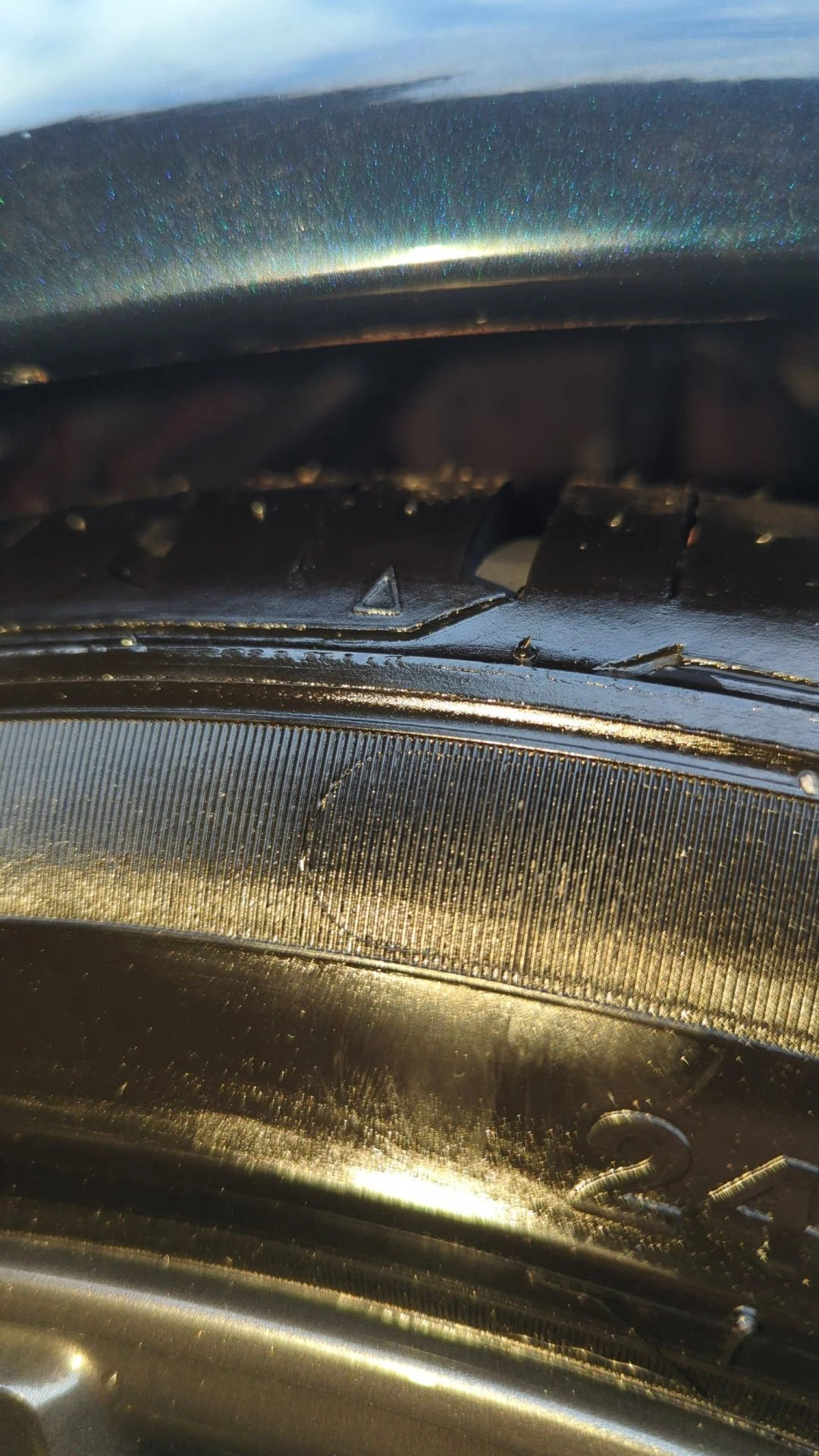

FYI the calipers don't clear the wheel with out some flap wheel finesse but that's a separate problem

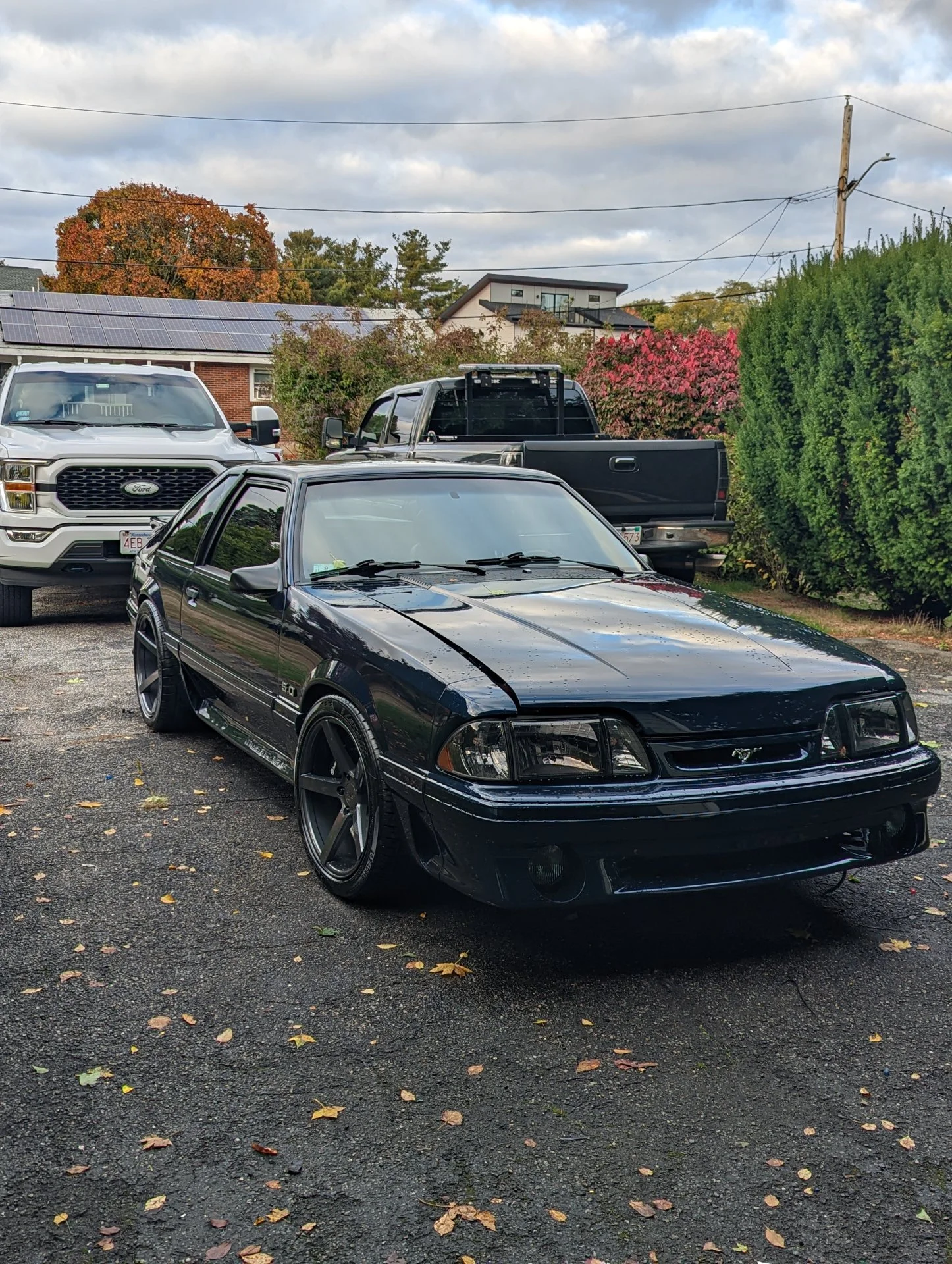

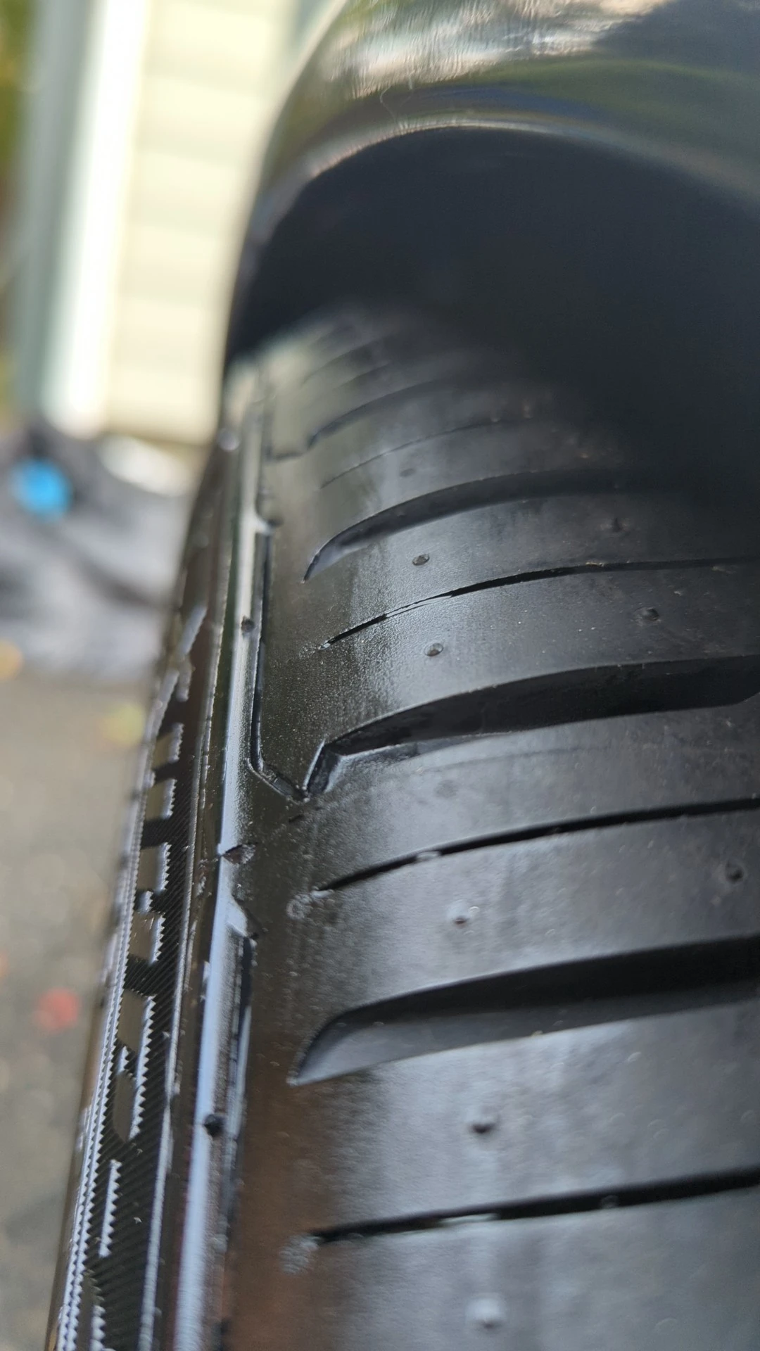

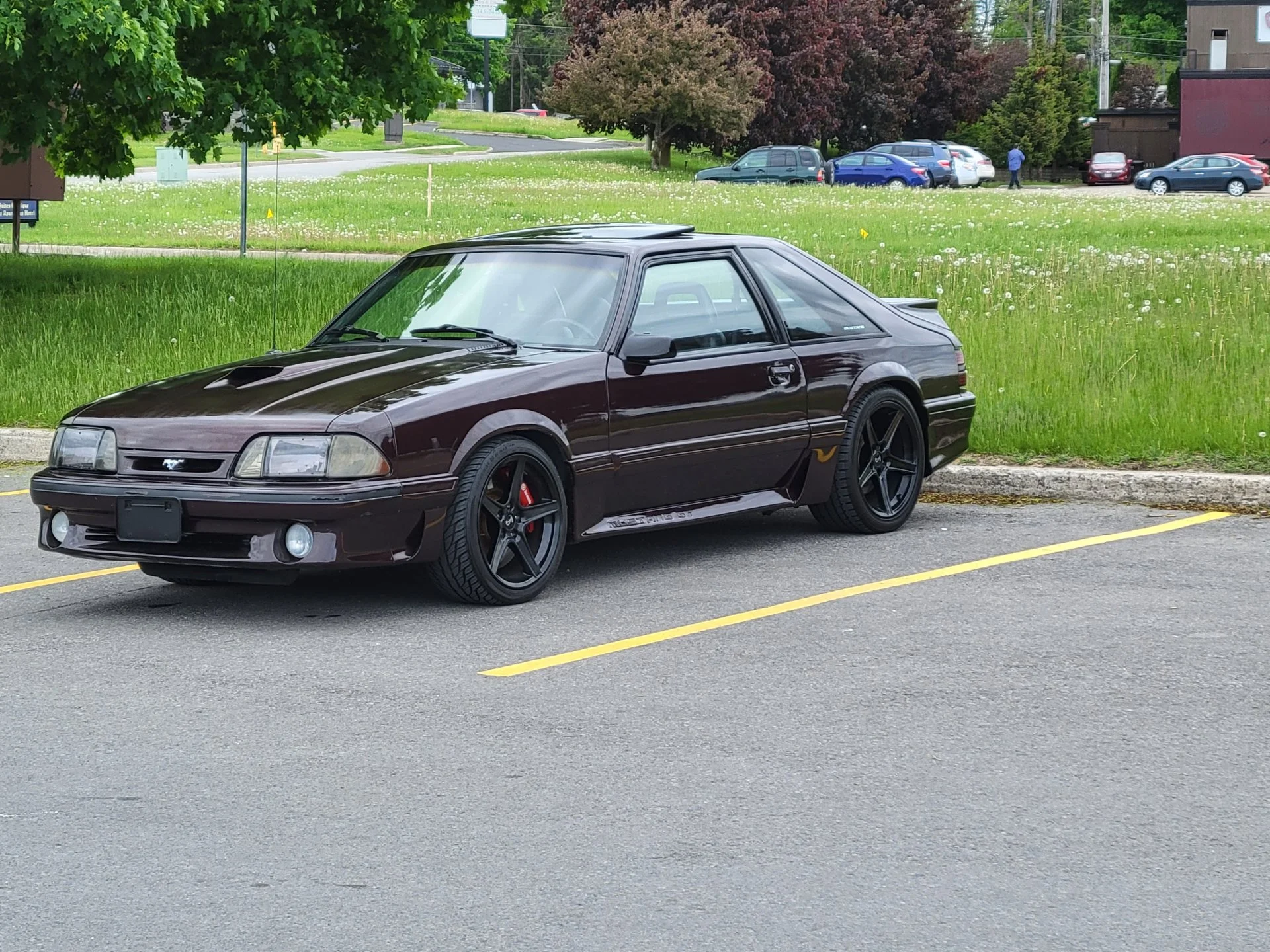

Originally I had second hand Steeda springs on the car(I don't know if they were the sport or the competition ones) and it was too low up front. wheels would rub on the fender lip at the top of the arch. I then bought a brand new set of Ford motorsport B springs and put them in this morning. They are supposed to be less than an inch drop compared to 1-1.25 from the steeda.
Well... They dropped the car as much if not a little more than the steedas.
I'm at a loss on how to fix the clearance other than stock springs but I don't want it that tall
Here is a pic with the steeds springs

Are you using poly spring isolators? They can raise the car a little. You can also install Steeda spring spacers to get more room between the tire and the fenders. I cover them at the 6:00 mark in this video:

Springs aren't going to solve your problem.
Those wheels look like they stick out in the front, just doesn't work on a foxbody.
A 245 35 18, may help.
Not sure what spindles you have, but if it's 96+, switching to 94/95 would help assuming you have clearance on the inside.
If they are 94/95 spindles, you could can probably put the blame on the wheels and tires.
I have Steeda sport springs on my car, 94-95 spindles and use an SVE Series 1 18x9 22mm offset wheel with a 245/40/18 tire up front and don't have any rubbing issues. I see that the NVX wheel has a 24mm offset, but I can't imagine that +2mm would make such a difference.

They stick out due to the S&S kits rotor spacer. (3/16")
I should have done better research, I didn't realize the spacer would be that thick to use the s197 rotor. But now that's what I have so I'm going to make it work.
Based on the 1010 tires calculator (which i love), it looks like a 245 35 18 is nearly an inch shorter.
Should be close to solving your problem.

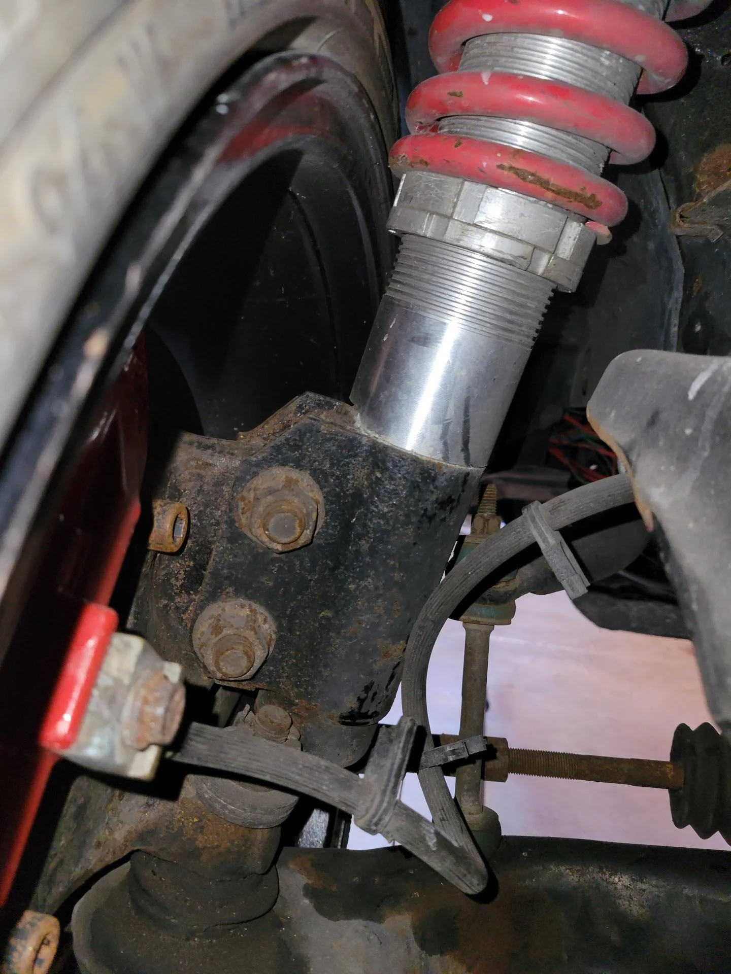

I have Saleen Reps - 18x9 with 24mm offset running a 255/35/18 front tire. I have 14" rotors and XTS Brembos. I have no issue caliper to wheel clearance but I needed to add a 8mm (5/16") spacer between wheel and rotor to keep from inner wheel lip from rubbing on my coil-over spring. Pic is with the spacer.
I am running 96+ spindles with stock control arms moved in 1/2".
The caliper clearance issue is due to the design of the NVX wheels... They have a significant step down in the drum of the wheel.... So while they are 18" they have less clearance than some 17" wheels

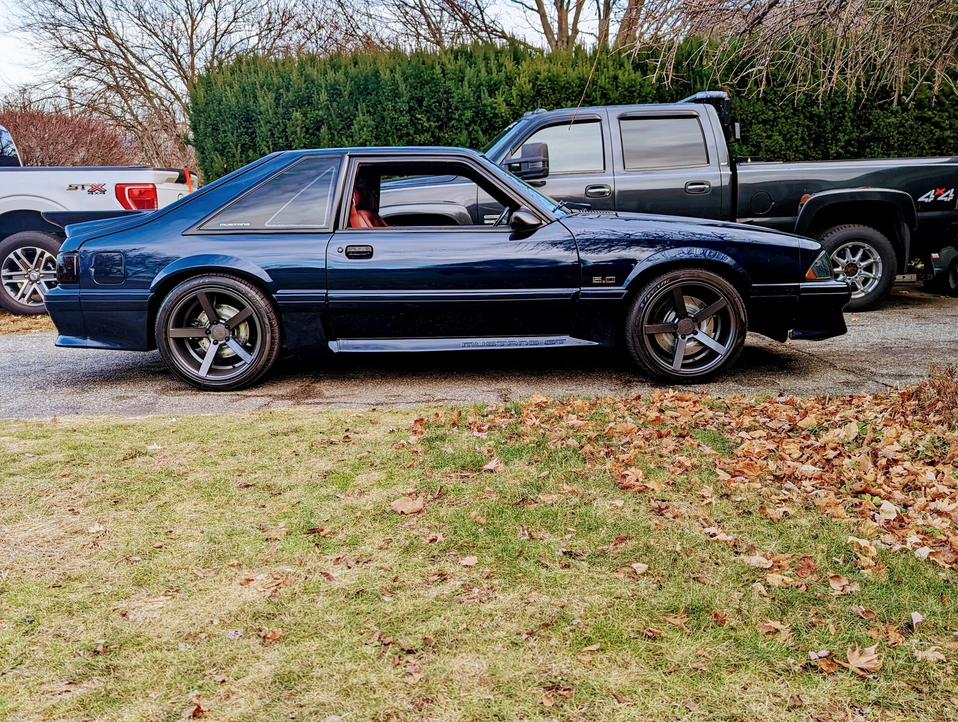

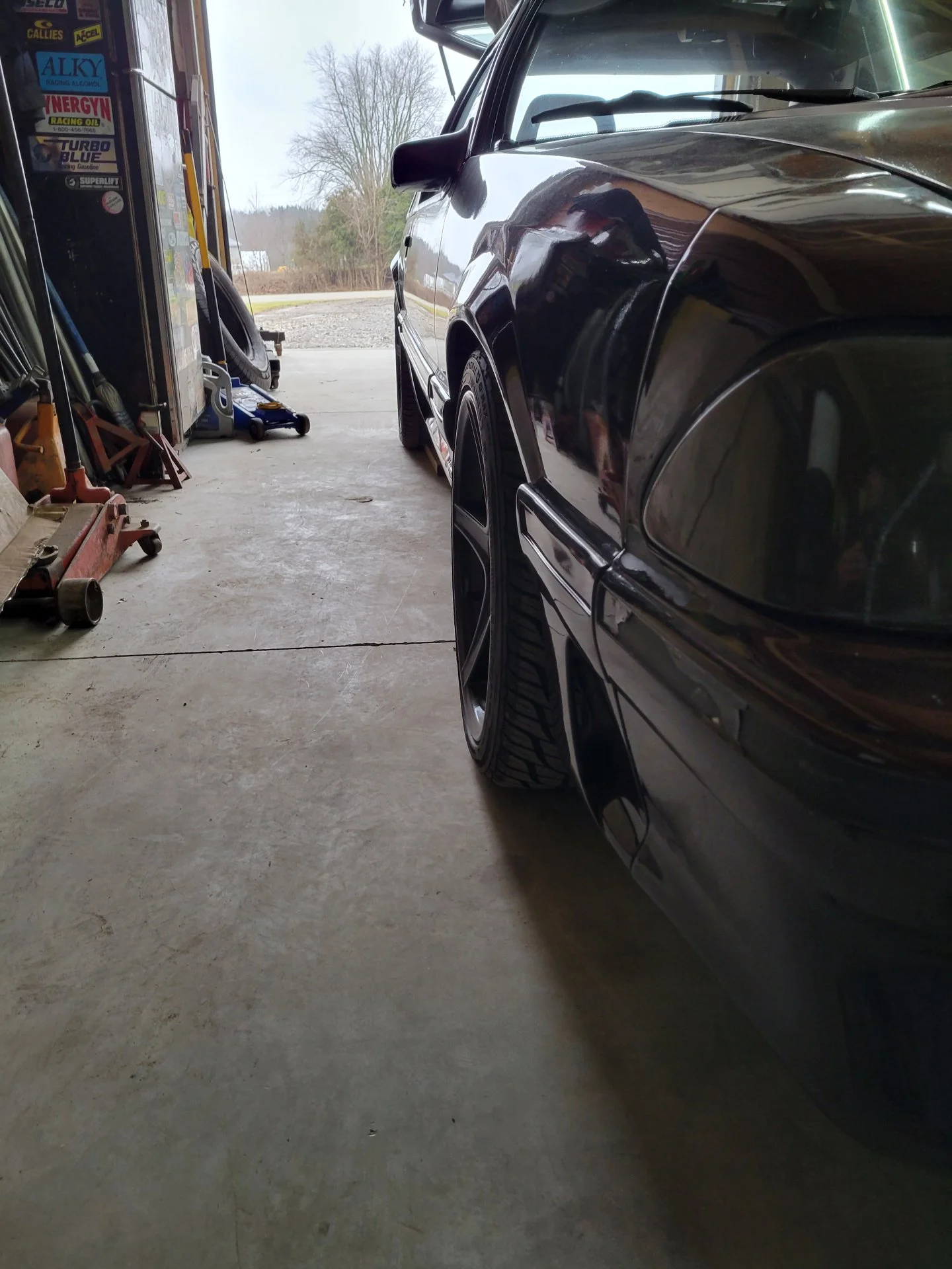

Ok put the spacers in ... Sits too high for my liking... I can raise the back with the weight jackers, I just haven't yet.
Also the tires now hit the front bumper skirts because they are at the peak of the tire diameter
I'm going to swap to the regular cobra brake set up to try to bring the wheels in and drop the car back down
(so the brembo/Taurus will be for sale probably in the spring at this point)

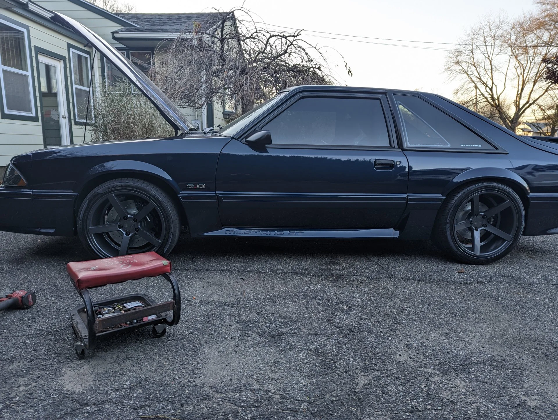

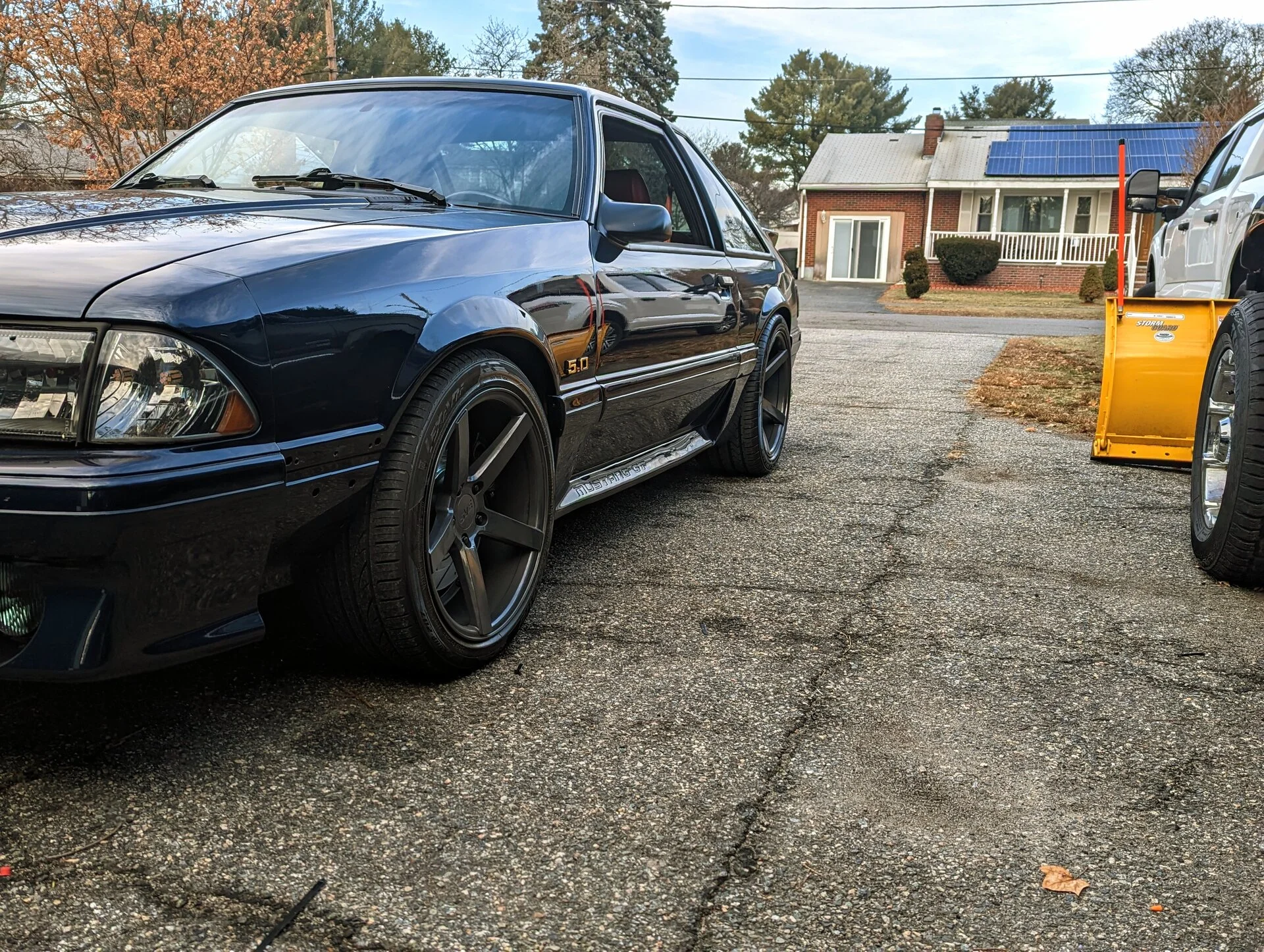

UPDATE:
switched to the 03/04 cobra front calipers and rotors, and removed the spacer.... Still had some rubbing on the fender arches during braking.
Fab'd up 1/4” spacers for on top of the coils(the first ones were 1/2”) and that did the trick. Car sits level(and low enough for my liking) and no more rubbing.
I so far have kept the Taurus rear calipers. I did a few panic stops on the test drive(after pad break in) and didn't notice and issues with them locking up. Car stops great.
I will be selling the ats brembos and 13.2 rotors if anyone is interested
