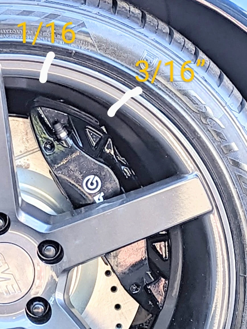

I had to take off a good amount (and it still only clears by millimeters) but not enough that I have any worries about the integrity of them.
If you do the NVX wheels for your 88 don't do the ATS setup stay with the cobra calipers

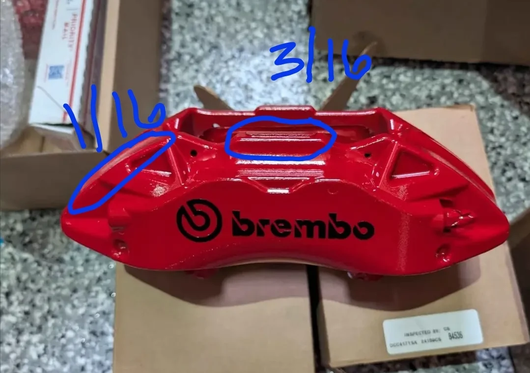

I machined the calipers on the 85 so I didn't have to use any spacers like what the S&S kit comes with. If you had to guess, did you take off a 1/16th, 1/8th, or more off the calipers? I already have all the ATS stuff for the 88 and I can always order the Saleen wheels for it...but I'm kinda hung up on those NVX wheels. I have a machine shop, so manipulating a couple mm here and there on the calipers or spindles is not a big deal. But if you thinks it's too much of a pain to deal with I'll stick with your advice. Thanks for getting back to me!
Oh with a machine shop it would be easy. I'd say I took off 3/16” towards the middle of the caliper and maybe 1/16" at the outer part of the arch.
I lightened the picture up as much as I could to try to see the clearance
I know this is old, but is there any chance you could clarify where you ground down the calipers?

Sorry I don't have any other pictures and I ended up not using them because I wasn't happy with the clearance, and amount I had to grind.
I went with standard cobra calipers...
