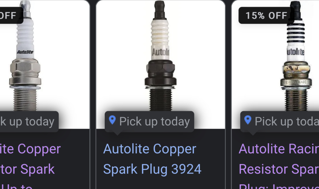

So I went and bought the plugs and it turns out both the 3924 and the racing 3924 have resistors so I just ended up getting the normal 3924s that I see everyone else in the forums gets to play it safe. They have the little metal seal separate and I believe the larger diameter half of it goes towards the plug and the smaller diameter piece that protrudes more goes towards the head but in online images I see pictures where it’s that way and some where it’s the other. Could anyone verify this for me?
I just run the 3924's and that is the way I install the metal rings. I have a lot of stereo in the car with zero noise. I have also replaced all of the grounds and charging cables in my car so that is most likely why I do not have the issue.
I cannot speak on the spark plug gap as my combo is different than yours (more inches, port work on the heads and intakea, and probably shift at a higher rpm) so listen to Mike.
