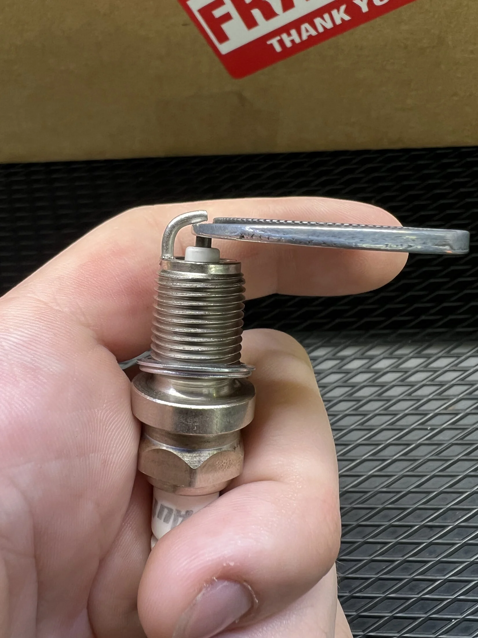

Sorry guys another dumb question. I’m gapping the plugs right now and I’m wondering what’s the right way to do it. You can see when I fully slide the plug over the tool it’s actually reading the gap farthest left from the puck since the ground isn’t parallel. Is that where I want the gap to be .054 or should the gap be .054 centered over the puck?

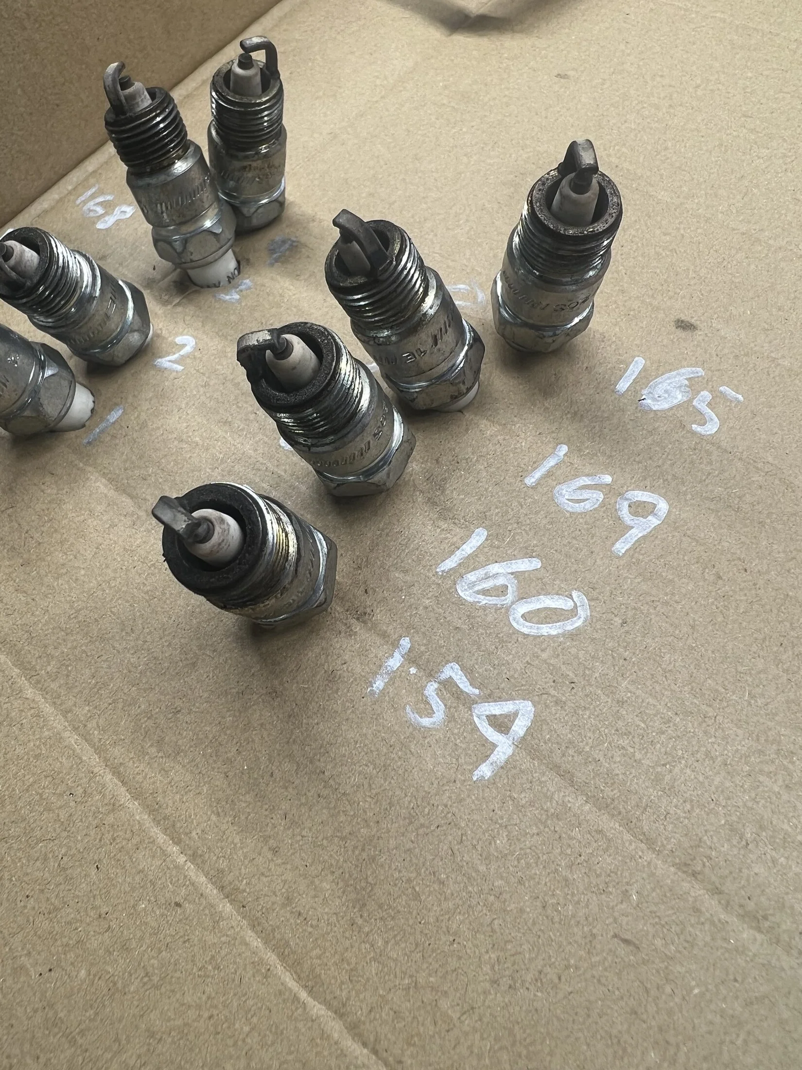

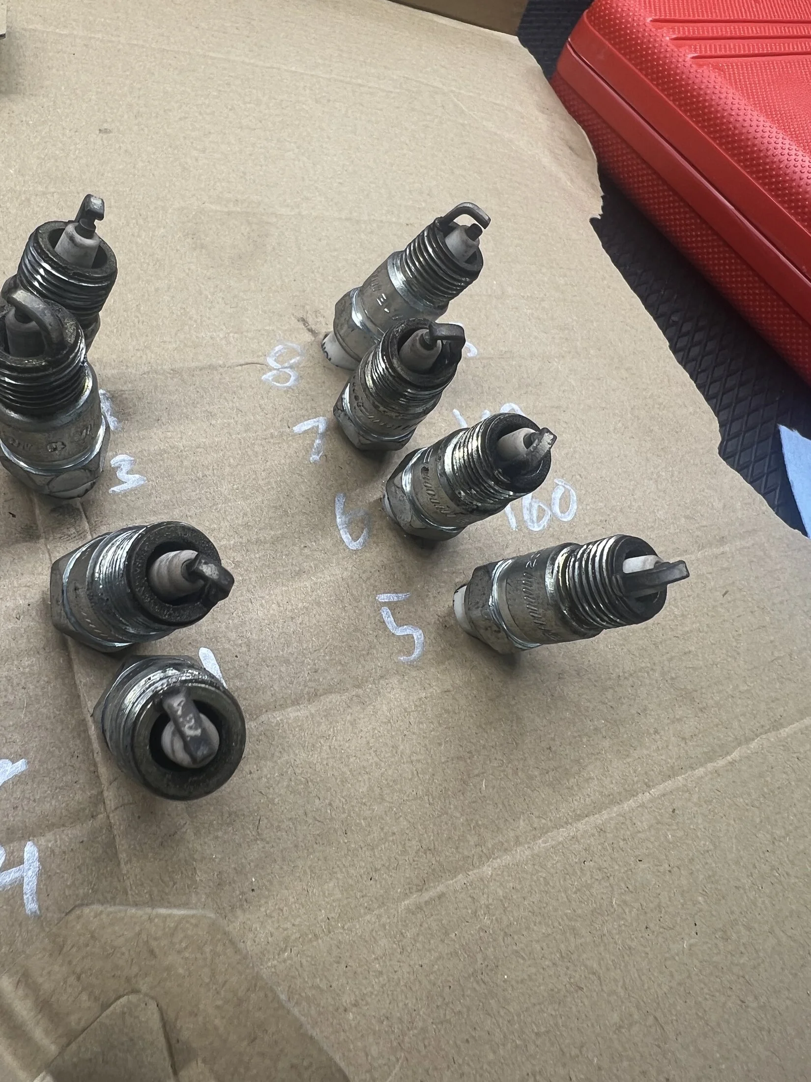

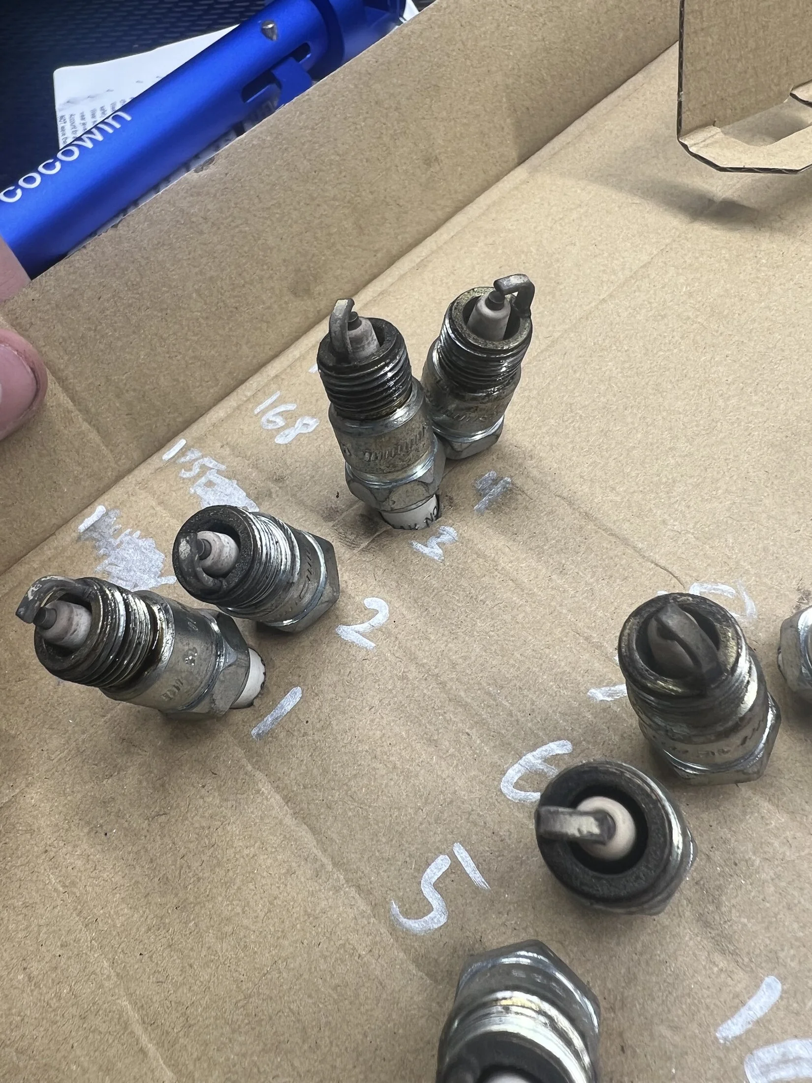

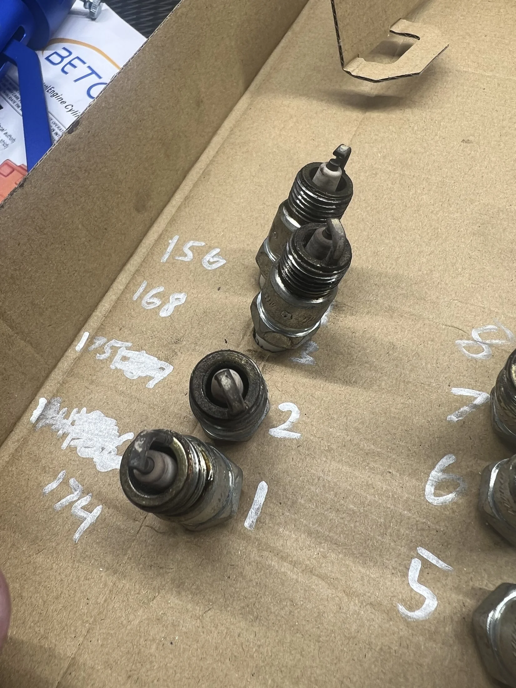

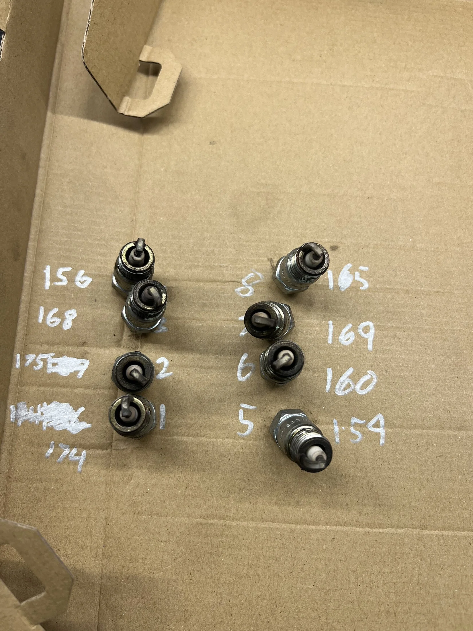

Below are pictures of the plugs I pulled along with my compression test numbers. If anyone could let me know if they see anything worth noting please let me know. There was some oil on plugs 1 and 3. The plugs only have around 500 miles on them.

Did you swap the HCI onto an existing short block? If so can you do a leak down test on each cylinder? Compression looks good but a leak down wells you a little more. With oil on the plugs it almost sounds like blow by and once the plugs foul the car runs rough. If the heads were new hopefully you can rule out worn valve seats and seals. Would be a piston ring issue possibly a PCV system issue?
Once the mechanicals are proven out then you can chase ignition issues like the distributor and/or it’s components and tha coil or the ECU.
Once the mechanicals are proven out then you can chase ignition issues like the distributor and/or its components and tha coil or the ECU.

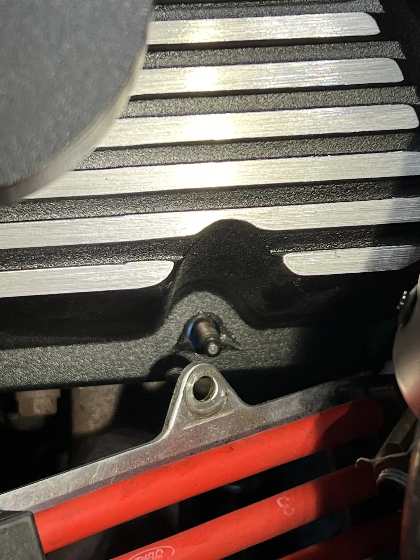

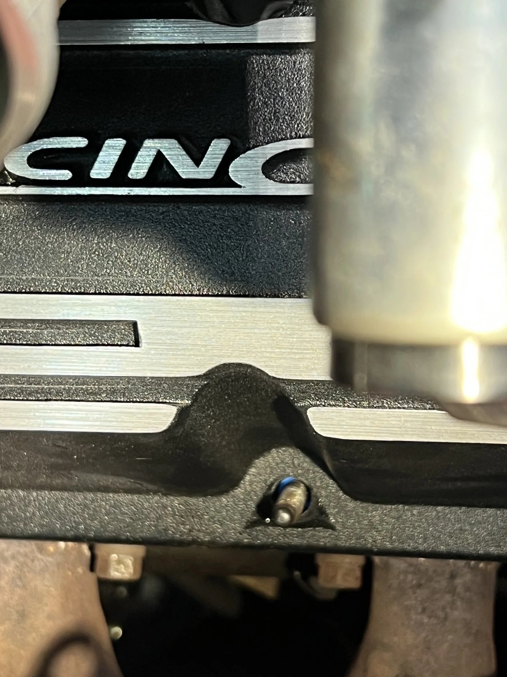

I believe it’s stock short block at least that’s what the guy I bought it from told me. hm I really hope it isn’t the rings. I noticed some oil coming out through the valve cover bolt holes. Is it possible that dripped into the spark plug hole? I’ll put some pics below.

2nd the General's comments on the valve cover oil drips (not even gonna call those leaks). I still say do a leak down test on each cylinder as that confirms the mechanical side of the motor. With the short block being an unknown to you this would be one of the first things I would do but I do understand as not everyone has a leak down tester and air compressor handy. Another quick thing you can do is double check the PCV system and make sure it's in working order as it could either be contributing to existing issues or creating them.

Oil from a small leak like that will not get past the spark plugs into the combustion chamber.
i don't see any real problems with those plugs, maybe a little darker on a couple, compression is acceptable, does it smoke (blue) at any point?
Nope, no weird smokes coming out of the exhaust.

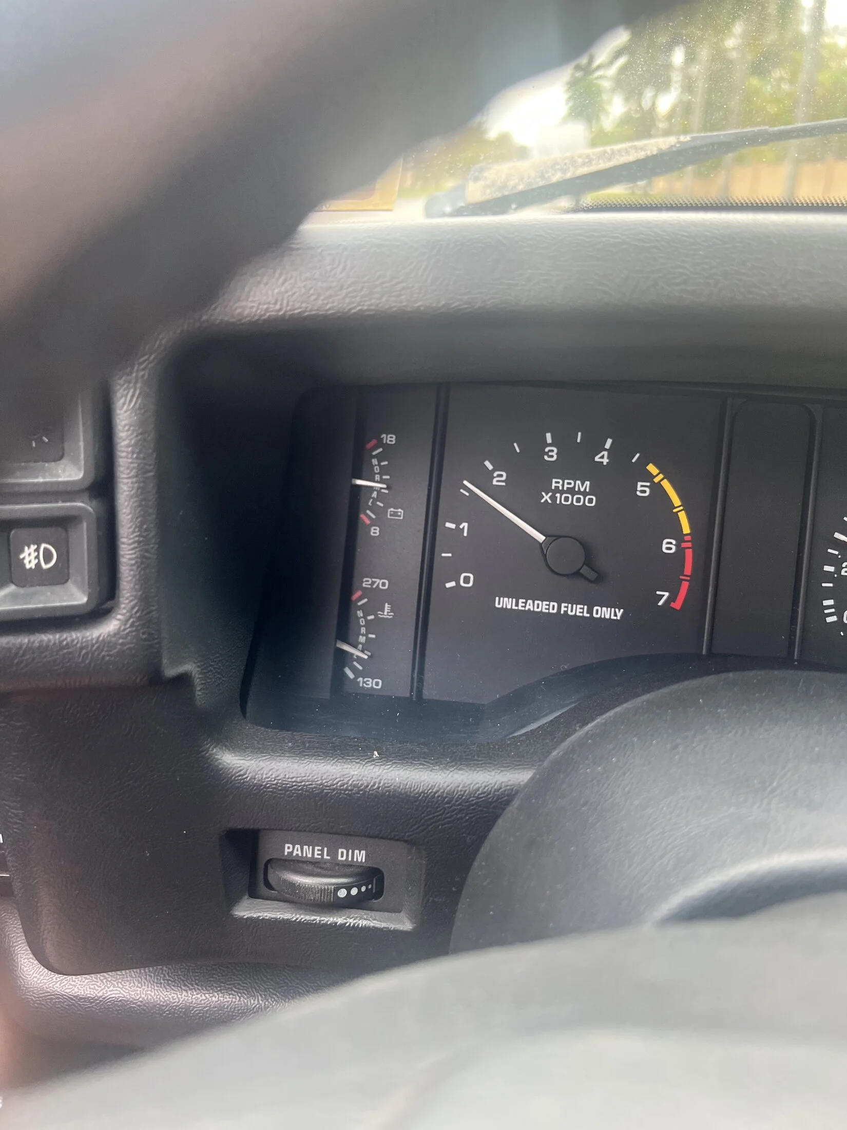

Something else that could be contributing to it. I changed the radiator to a lmr sve aluminum radiator and put a heavy duty fan clutch because my car was overheating In these hot florida months. However now when it’s a little cooler I’ve been noticing the temp gauge constantly reads here and never goes up to the middle like it would before no matter how much I drive it. Could this be contributing to why I’m noticing more misfires lately or is that reading within acceptable range?

The stock gauge is a 'best guess', I got a inexpensive electric gauge and stuck it at the bottom of the dash cause I ain't cutting anything up to mount a gauge, some put the gauge pod on the pillar but that's kinda 'race car' for me. I can glance down and see the actual temp.
The reading on your stock gauge may be a little low but again, 'best guess'.
I think the midpoint hash on the stock gauge is about 200* but again, 'best guess'.

Change the temperature sending unit. Mine did that and I put a new one in and the gauge went back close to where I was used to it being. Also, these cars came stock with a 192 deg F thermostat so running a colder one will move the needle.

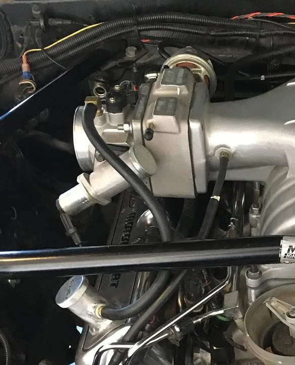

I noticed you have Motorsport valve covers. What did you do to replace the oil fill neck on the passenger side valve cover? Reason I ask is on mine I had a push in cap that was vented and I just capped off the old vacuum line that went to the stock filler neck. This allowed unmetered air to enter the motor and looked like this:
Fixed it by doing this:
Welded a TFS fill neck onto the valve cover and then drilled the neck and welded an 1/4" NPT bung on it so I could screw in a 1/4" barbed fitting to put the vacuum hose on.
Again, not saying this is your problem but all these small things add up.

Go to this thread to see how a Cobra intake should be plumbed vacuum and PCV wise as it may help.
