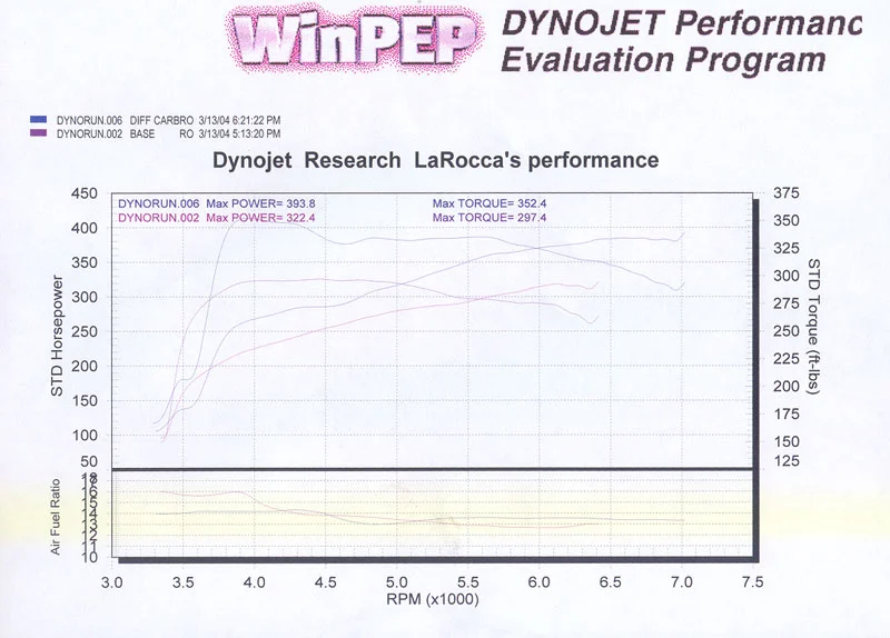

Thank you. Someone finally agrees with me. I've had this debate many times. There are times that a car that dynos more hp can lose to a lower hp car. It's all about how the torque and hp carry thoughout the rpm range. Some cars may peak for only a split second while another carry it thoughout.
Here's my dyno on my 408c 70 Mach. I think it carrys the torque and hp well. Ray

Ray: Love that dyno, it is much flatter than I would expect from a Cleveland. They are usually peaky. I guess it's the cubes shining through.
Peaky??

Well I guess that proves 408s have great power curves...
