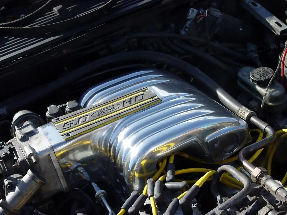

Here's an intake I did completely by hand several years ago. Took me awhile to do this. Sold the car to a friend and this photo here is just after I finished. Hence why the TB is not polished either. And BTW, if you can't find Tripoli ( which I have NEVER heard of ., till now) , then you can also use MAAS metal polish. GREAT stuff and I have been using it for 13 years. It's a polishing compound like Tripoli. Makes cake work out of ANY dull metal.
