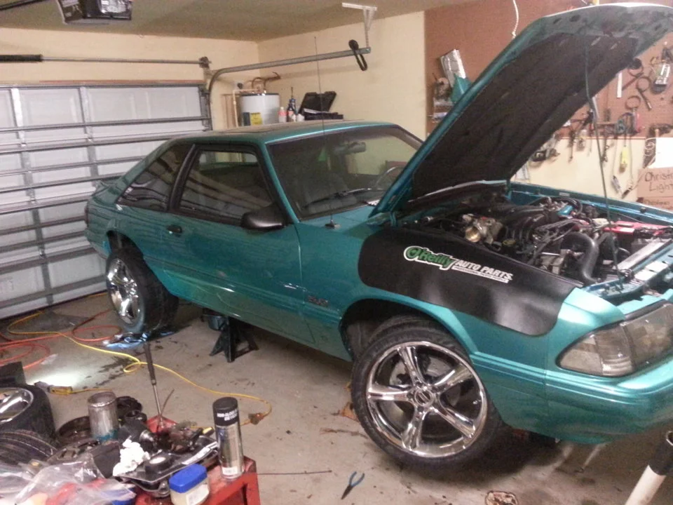

I have my completely stock 90' hatch and I'd like to make mid to high 300 RWHP. This is strictly a summer time street car. What is the best recipe using all stock heads and intake? Will I need to port everything? I will be adding a V3 S trim, 1 5/8 long tubes, 2 1/2 o/r h-pipe, power pipe, PiMP tuned. I do not want to get too close to the block breaking threshold.
What else? After market cam? Custom cam?
Will my 3.73 gears be too much gear for boost?
I just want the look and reliability of factory parts and I want to keep my low mileage 73k block and sell my other 306 CID hci engine. I know the blower will not be in line with keeping a factory appearance but that's just the way it goes.
