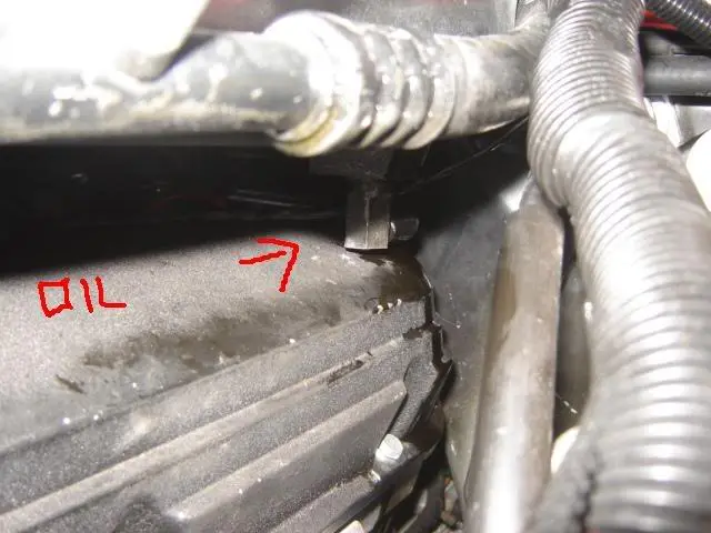

As for the lower intake gasket, how can that push oil up into the upper intake? Here is a pic of where it come out of when I pull that vac cap off. I just did a injector swap so my upper intake was off,

Sure do, There is some oil inside my throttle body....

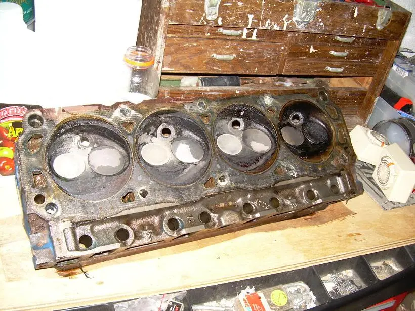

i ask because my #8 plug was very oily and my #8 compression test was 165 while the others were around 145. when i pulled that cylinder head off, oil was caked all over the compression chamber. i still don't know exactly what it was, but i'm guessing the oil ring blew.
i had similar symptoms as you, oil in the intake, but lots of it; i was losing a quart per tank (about 200 miles)
the motor will be pulled out sometime next week and i'll probably start the tear down after new years.
