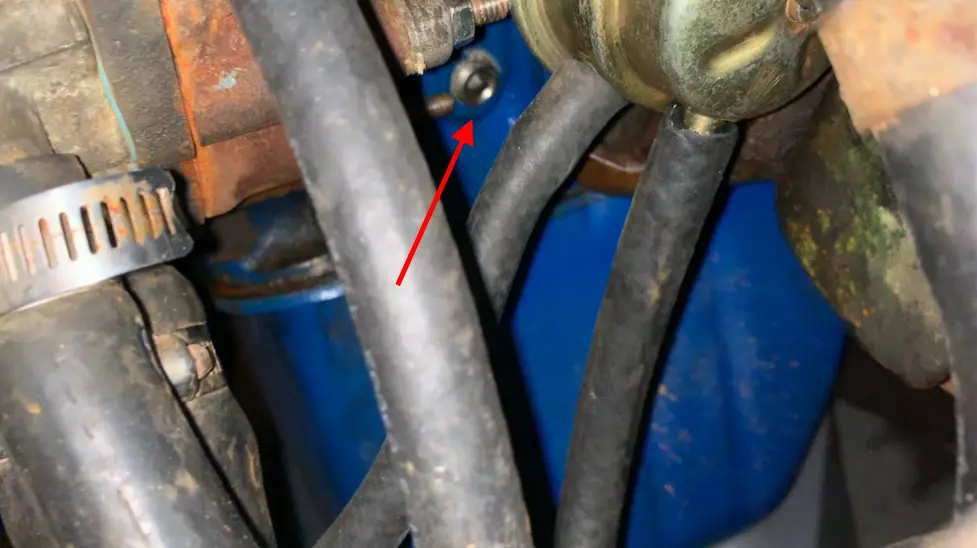

Does this look like the right spot?
(I have no idea what, or why that bolt is there)

Yep that's the spot. Looks like someone did a nice job plugging it.
