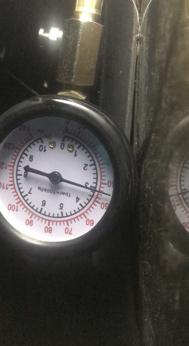

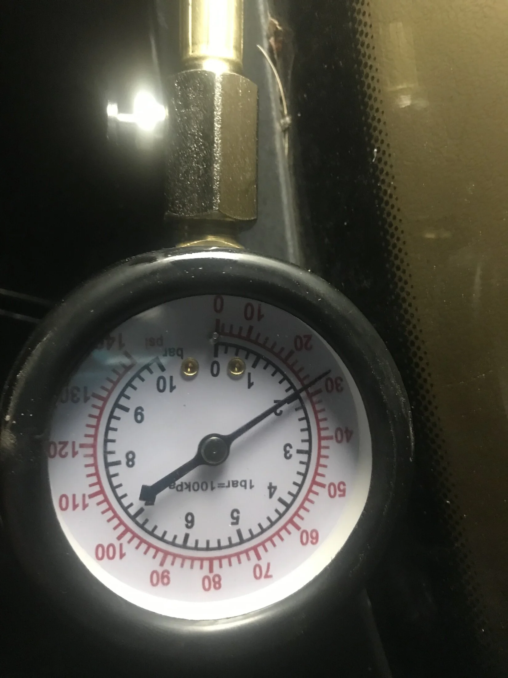

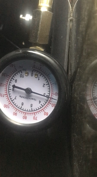

Ok I’m so I was able to get the oil pressure test gauge tight and fired the car up and I started around 48 psi at cold start and it was there for awhile then as it got to hot idle it didn’t go below 20 psi
See videos

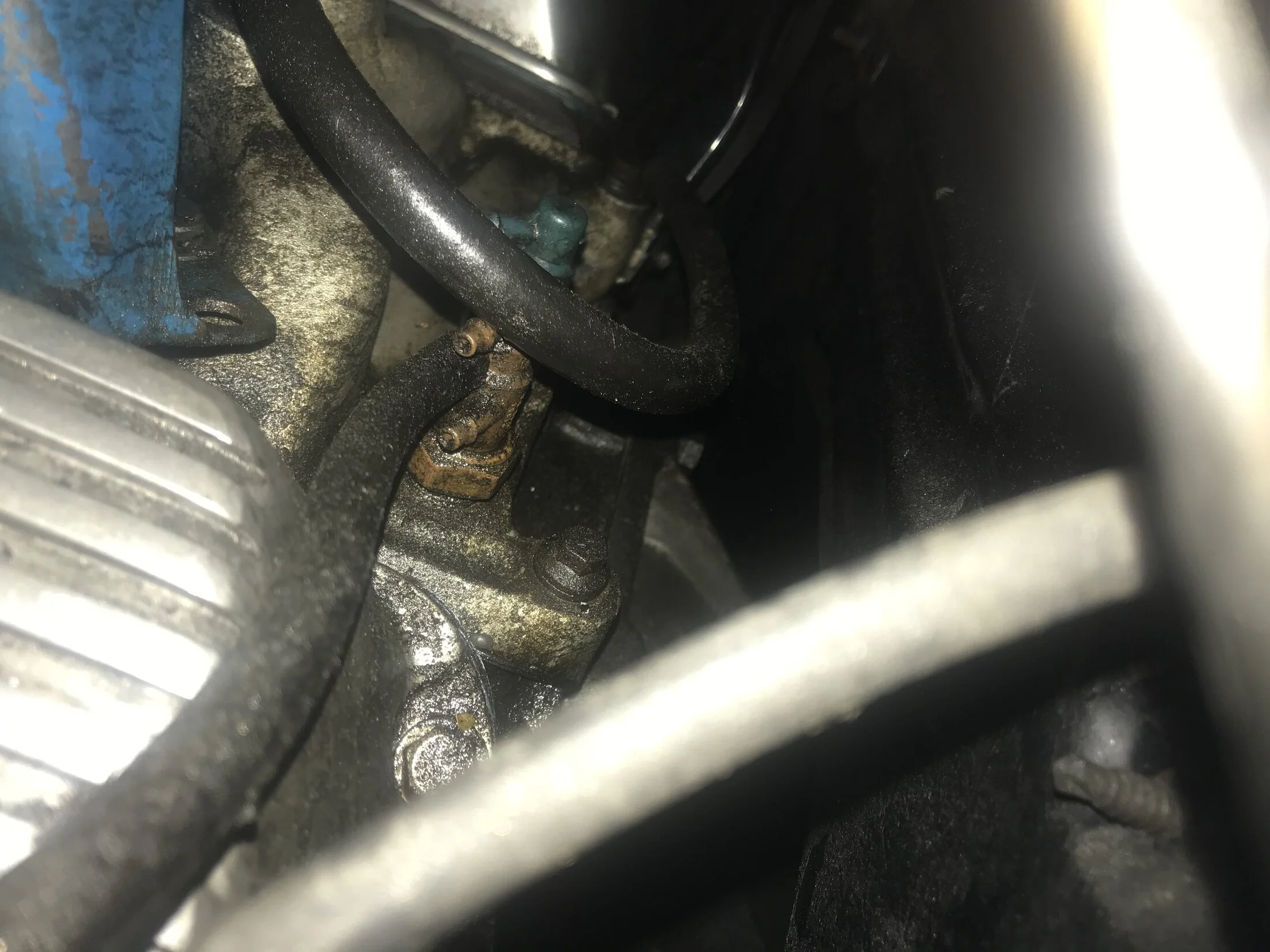

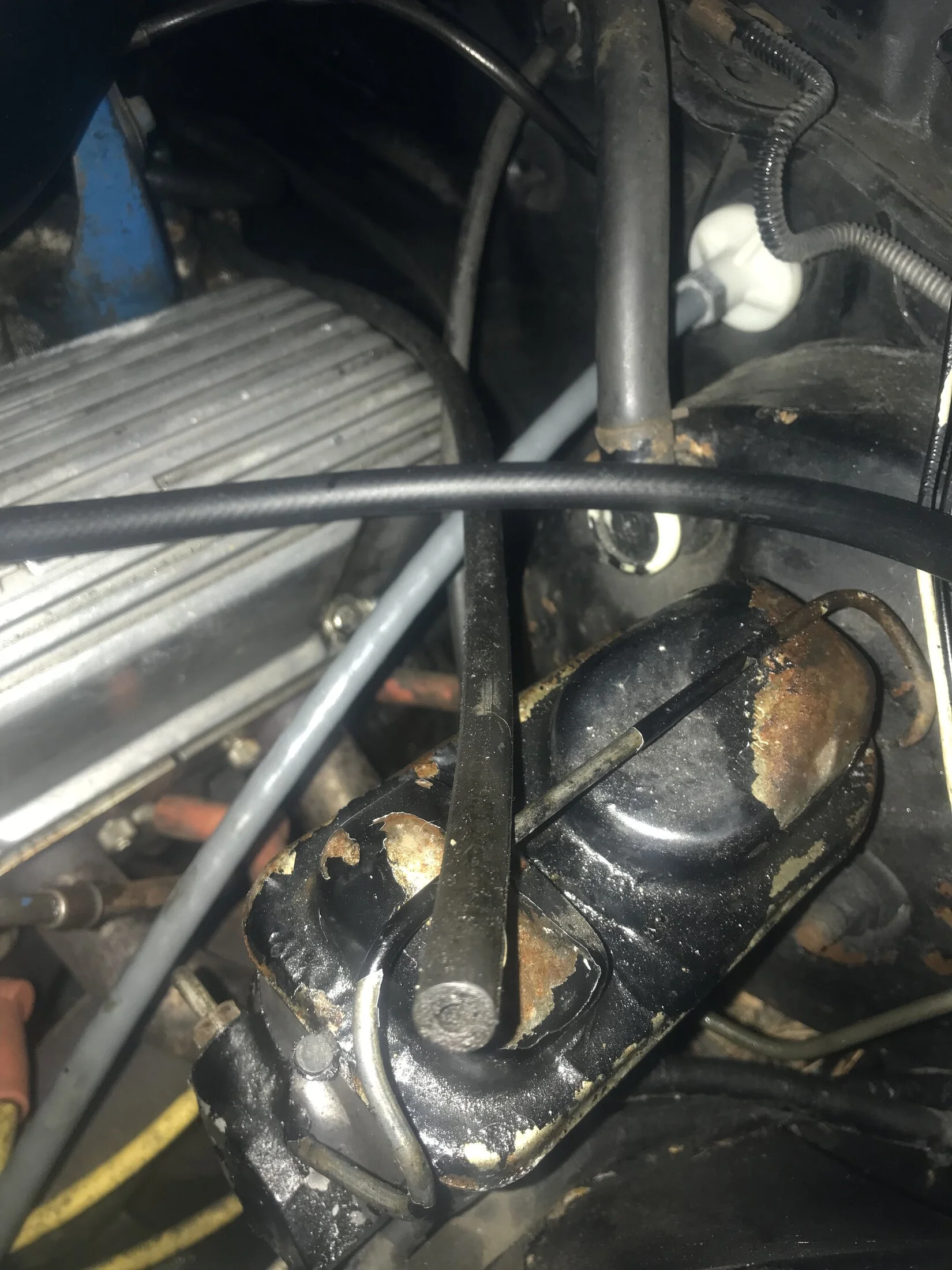

Had a question on a hose line that seems to be coming off a port right next to the pcv valve but it’s not connected to anything at the other end
Included a photo as best as I could get it

Last one was a video but it wouldn’t let me attach the file so I took a screenshot right after starting the car
