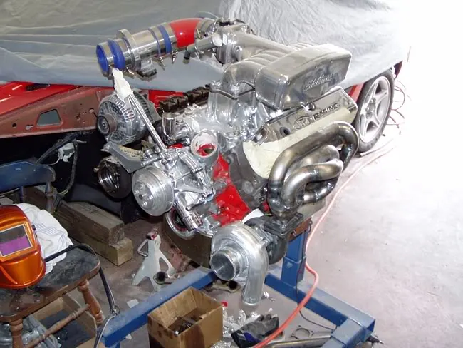

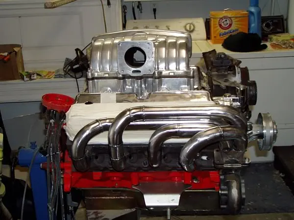

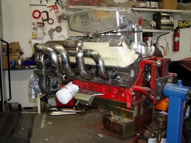

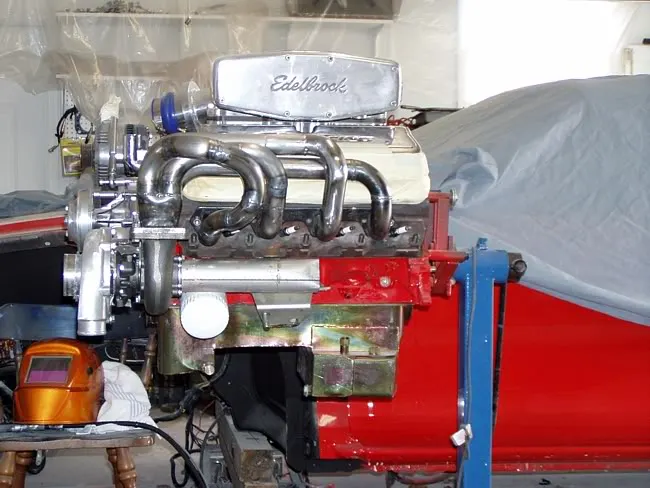

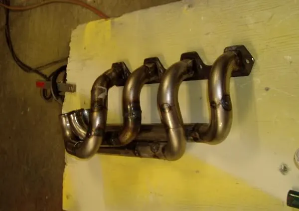

Shoot, I don't have any recent pics of the headers I built, but thats basically the whole setup. The downpipes will sit under the headers and are just real simple 3" straight pipes going back to the factory H pipe location. I did this so I can simply bolt up an H pipe without modification.
The headers could have turned out nicer, because im a perfectionist, but Im just surprised I actually made a set of headers from scratch. After looking at them, they could have been done much easier using less J bends.. But oh well. Next time, next time!
Anyhow, after Im done with BlackVerts setup I can bolt the headers and turbos back on, and snap a few pics.. But for now getting his setup done is #1. ( which should be done shortly)
Here are a few old pics...

they way you did that is wonderful, everything is symmetric... how'd you think of the "better" way of doing it? coming straight into the hotside w/o the last 90* turn and just getting one 90* after the turbo?
anyways, looks sweet, you could have a business on the side... fabbing these thigns
