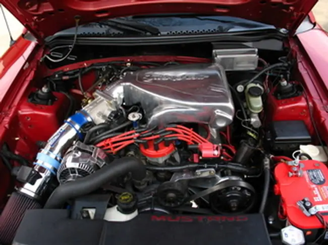

Once again bling bling under the hood
Yeah i always like red/black combination
Here is my BMW back in Bosnia / Europe red/black

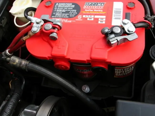

Today i was bored so i install oil pressure sending unit for Phantom Oil pressure gause so i took two pics of Optima Red top battery
Here you go

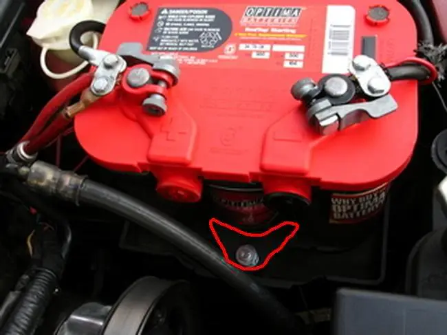

Where did you find your battery hold down clamp for the Optima? It looks sweet!
I 2nd that question. I thought you got one of those "over the top" hold downs. I just bought one of those hold downs today. Had I known there was one like your's available, I would have got that. It looks alot better/cleaner.
Thanks man
I use one "Ford hold down clamp" that comes with Optima battery ,and i screw it in stock hole ,you will have to trim one side of stock battery tray, i did side thats next to fuse box because battry will be in center
