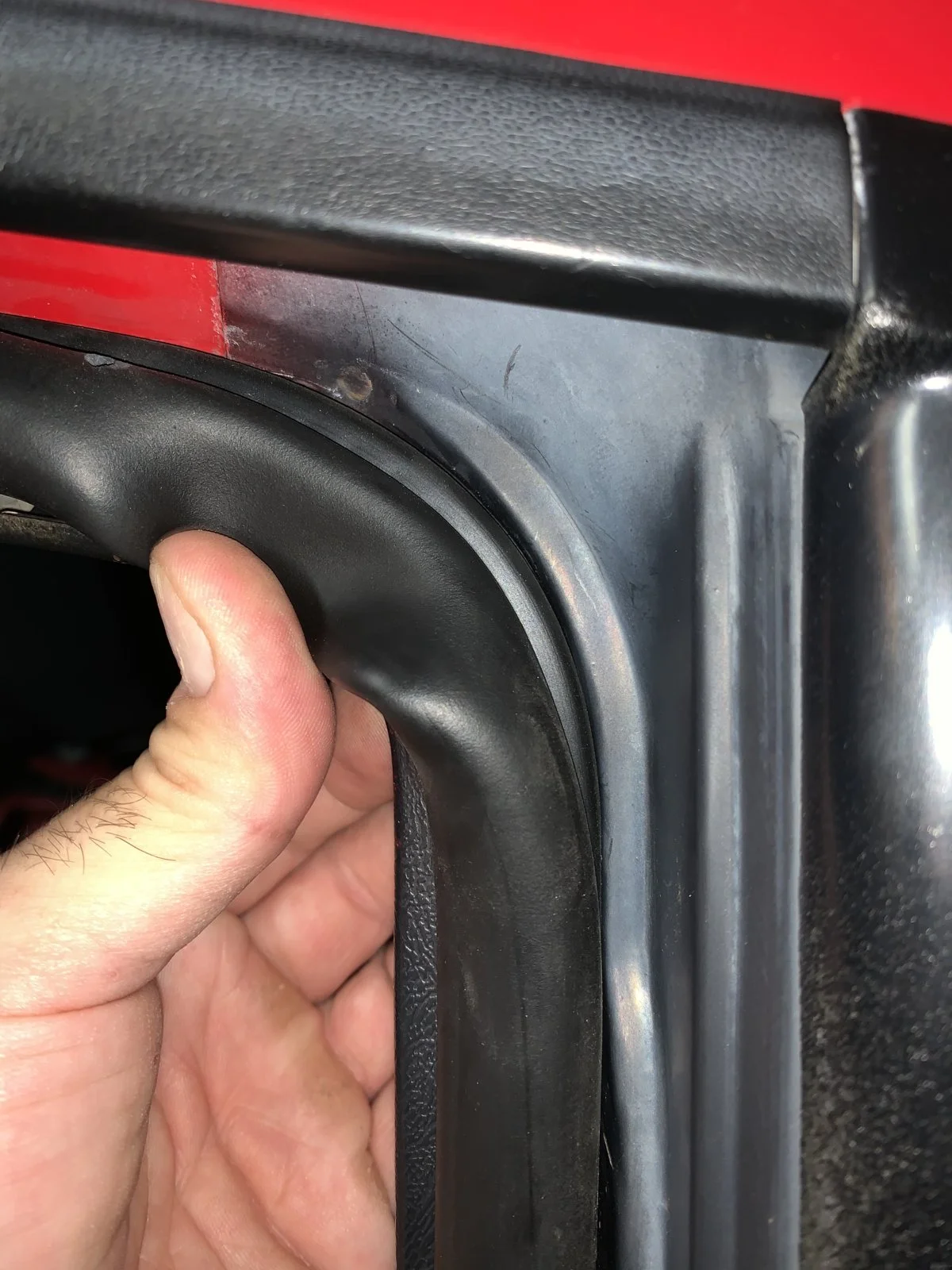

I always start at the seat pivot point then go back and up the B pillar. My thought is that if I get a crease or something I can pull that off and not have very much done. I will say I've never been able to get a crease out no matter what I try. Save yourself the trouble and get the DC ones. They are like a dream. Plus that crease will make a noise, if not now, very soon.

Yeah I can tell, sat in the car and for the most part it seemed sealed but I could stick my finger in the top corner and where it was creased so I’m sure it would leak or make noise. Appreciate this write up and I’ll try and go counter clock wise this next time and see, I’m wondering if once I add the bushings to both striker bolts if I’m gonna have any door closing or clearance issues.

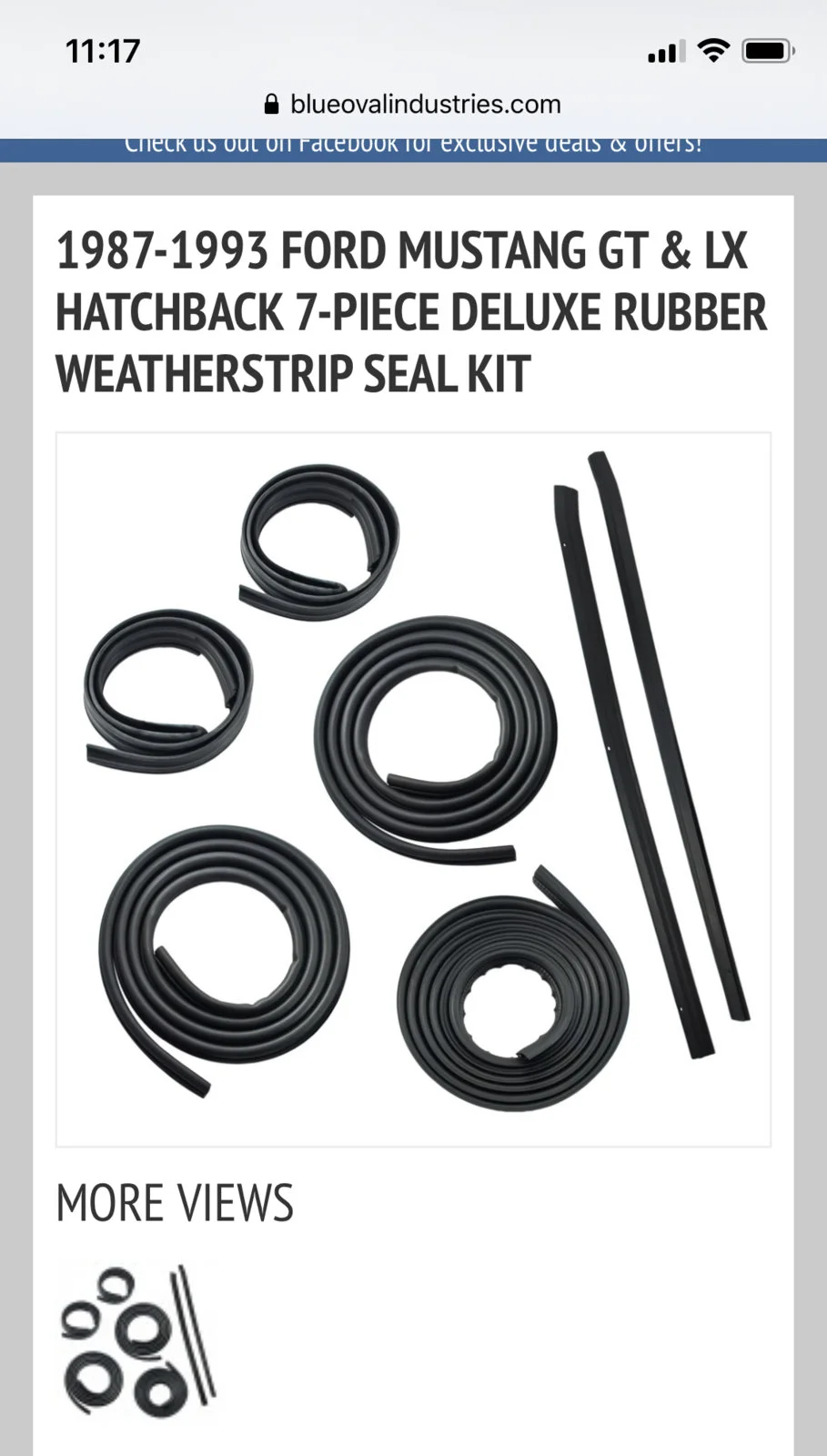

Wonder if I’d be going over board by ordering this deluxe kit. Everything is original, the doors were bad ripped in certain places. The hatch still seems good but is certainly old. My outer door belt trims I tried to clean and sprayed them awhile back but have some pitting or chips etc that you can still see

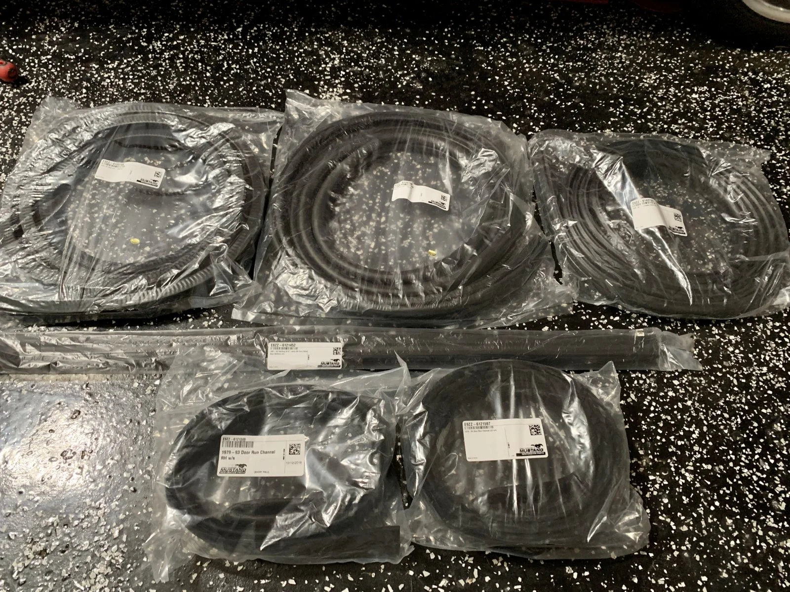

After Wayne's recommendations on the Daniel Carpenter stuff I ordered the kit from Blue Oval for my 'vert. Everything in what I received was D.C., fit great and it was hard to beat their price. Like you I had a few pieces that were in okay shape and didn't HAVE to be replaced. Did it anyhow and was happy I did. Wayne has already said it, do it once and be done!

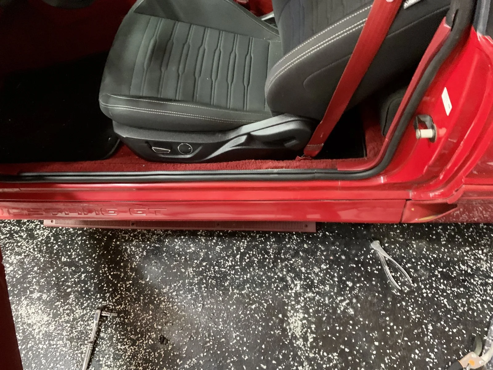

Changed mine today. Took longer to remove all the screws and trim than to actually install it. Fit like a glove. Looked nearly identical to the factory weatherstripping that was still in my car from ‘93, just not compressed and torn. Closing the door produces the same feel as before, as in no added effort to get it to latch. Looking forward to driving it and seeing if some of the wind noise does down.
So I began this adventure again last night and as usual I didn’t go back and read the past posts before just jumpin right in. So as said these weather strips are way better than the lmr ones. Started on the drivers door, went counter clockwise, this one tucked up into the corner nicely, no creases. Only thing I noticed is, I used my dead blow for this and in that 90* turn it sat in good, but I feel if I push it is seems to move in more and once I let it go it moves back slightly. So seems to be a little play idk if that just normally for a slight bounce or if it should be biting down solid like it does on the straight lines. So after all was said and done weather strip wise, I buttoned everything up and then remembered hmmm I have those striker bushing let me toss it in. I install it, line up the striker back to where it was originally, I’m pumped! Give the door an easy swing shut and denied!!!!!!!! Give it a harder shut, and it barely latches. I adjust it slightly also thinking maybe I had it to tight since the bushing wasn’t freely spin able it was just jammed. Try again and barely latches. So I go back and read, and some where in this thread it someone’s states to try and install the bushing and close the door with no weather strip in. Can I pull this new strip back out now or am I going to lose all the glue by doing so? If not how do I adjust this thing. Currently I removed the striker bushing and the door closes. Even though it does it seems the top corner of the door sticks out a little, and along the crease line by the key lock it pops out a little, again this is currently closed, which it did fairly easily, and no striker bushing on right now. A little more with the drivers door is it won’t stay open like the passenger side door does. So I’m guessing that means the door bushing is bad. The door doesn’t seem to sag, but it will shut back on you. So on the drivers side I’m stuck and need some help or pointers of what to do. Now the passenger side, I removed the original WS, this side also has no striker bushing. So closed the door with no WS installed and this door obviously is loose. Where do I go from here bushing wise etc before I install the new WS? I’m gonna add some photos of the drivers side and I’ll get some videos up, wish we could just add video instead of having to go to YouTube but I’ll have them posted shortly.
