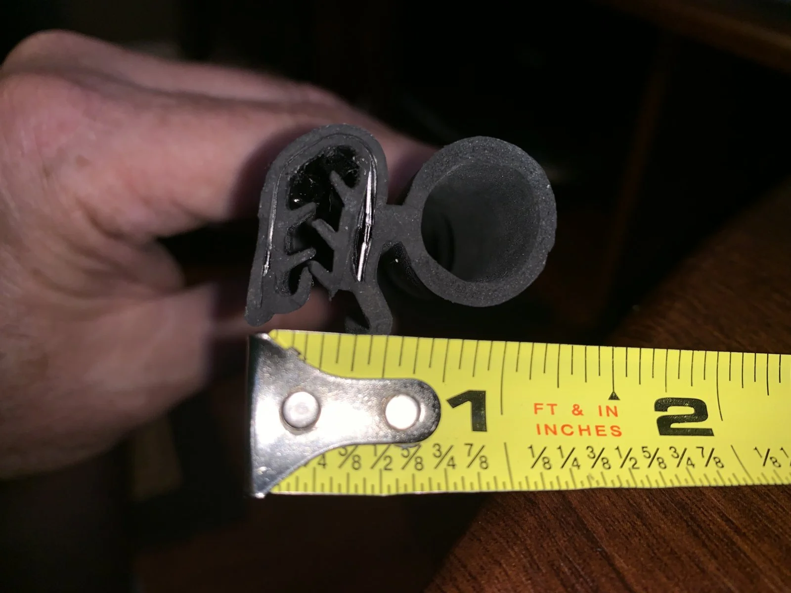

Do you have pictures of the seal end view or profile showing bulb thickness and height and if there is a rib between the bulb and clamp. I'm about to the point of ordering the expensive Ford seals but wanted to look at the shape of the lower cost seals first.
I answered this above to you. There is no rib. I started the text for the results yesterday. I'm shooting for Friday to post it all.

Picture of seal cross section. This door seal sucks, making door very difficult to close/release. Supplier:1A Auto $49.95pr P/N 1AWSK00232 Fairchild Brand

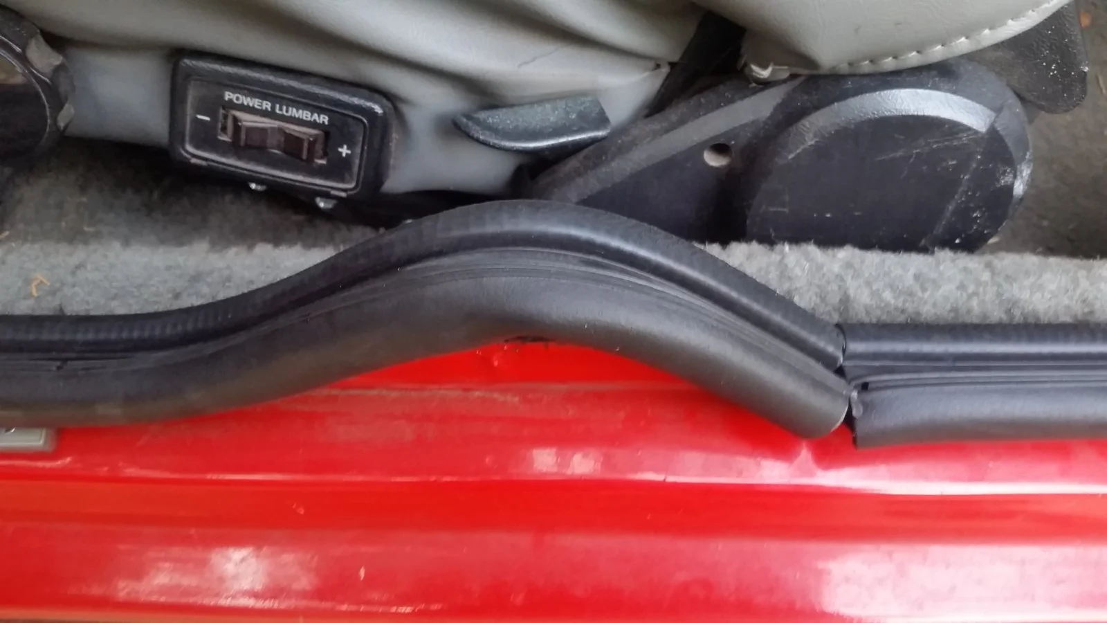

Overlap the edges.
631111

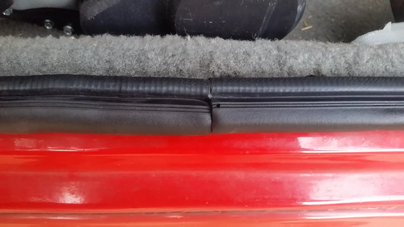

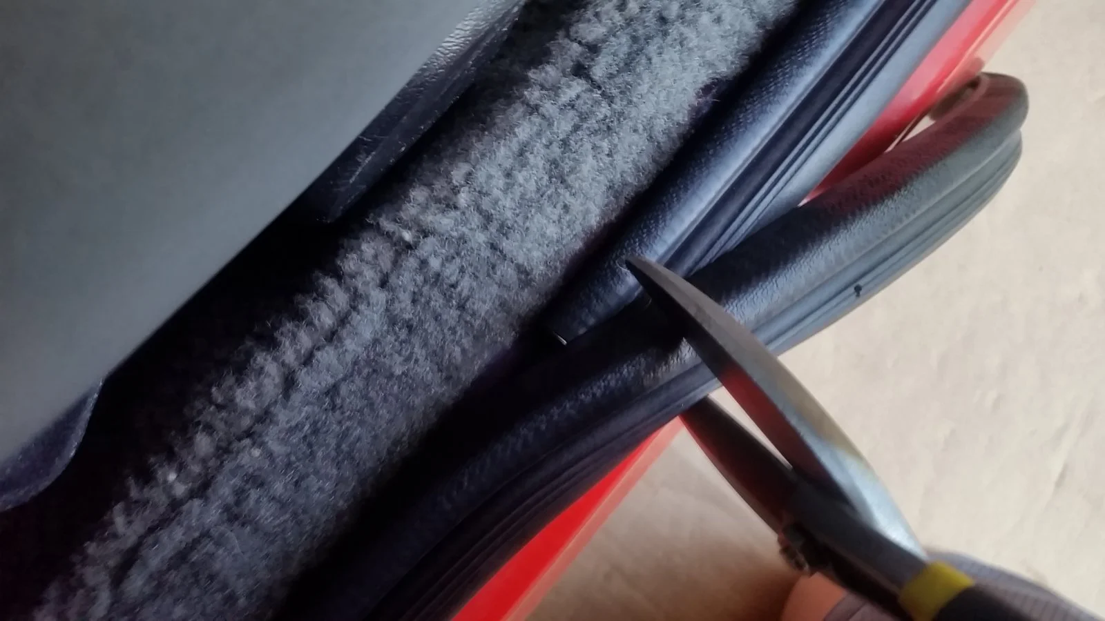

Cut the seal an inch longer than where they meet.
631112
Place it like this and press the seal down and let it push the extra into place. This will ensure a good fit below.
631113
The finished seal.

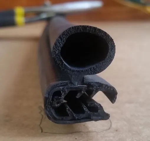

Fairchild Industries
Next up was the Fairchild weatherstripping. I will admit to something on this one. When I installed it and closed the door, I was so used to slamming the door for so long that I was honestly jumping for joy when the door closed the first time. After so much door pain, I almost didn't want to take it out of the car. This seal is on the lower end of the price range. On RockAuto you can get the pair for $25. That's even less than the low-end LMR ones. My thoughts on this one is that they will work for most cars and do a decent job. I didn't totally like the flexibility in the corners with this seal. It did have a small crease in the upper rear corner that bugged me. It didn't seem to cause a problem and I might have been able to manipulate it around some to eliminate the crease but I'd rather it not happen in the first place. I could not feel the crease while in the car with the door closed. The seal pressed smoothly in the corner. This seal passed the door closing test as mentioned. It also passed the wind and water test. It will work and it's cheap. If you are squeezing every penny, then this brand is hard to pass up.

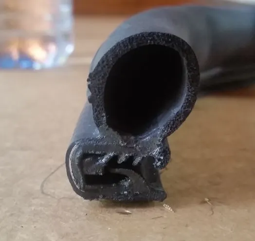

Daniel Carpenter
Now we come to the Daniel Carpenter (DC) piece. I had a lot of expectations on this one given that DC is known for using Ford tooling when possible and their apparent commitment to quality. There isn't a lot of difference in the way all these looks. So you could be holding a perfect seal or a junk one and not really know it. This seal went in the car quite well. At this point, though I wasn't sure if it was the seal or the fact that I can remove and replace one basically blindfolded now. After the install though I feel sure it was the seal. The quality of the DC seal was as expected. It's very flexible and easy to put in place. This seal definitely has better adhesion than most of the others. There is more glue in the channel by far. I never once had to mash it back in place after the install. Lastly on the adhesive, when I pulled this seal out, it looked like those pizza commercials where you have stringy cheese stretching out from the piece to the rest of the pizza. I literally had to take my hand and separate the strings of adhesive as I went. There was that much in there. No other seal had a single bit when removing them. You can tell a good seal because you don't have to fight it to put it in. This seal passed with flying colors. The door closed perfectly. The seal stayed in my car for the second longest time. I figured if it was good I should give it a little extra time to fail. This particular seal was in the car for a lot of the enormous amount of rain we had. It never leaked a single drop and believe me, I watched it like a hawk. It also passed the wind test. The good thing is that this seal is still not very expensive. One last thing on this one. Not one single time did I have to close the door with the hip close or open and close again. It honestly felt like the 30 year old seal that came out of the car. I didn't have to think about it and that's the point. I don't want closing a car door to be something I have to think about and check. Mission accomplished.

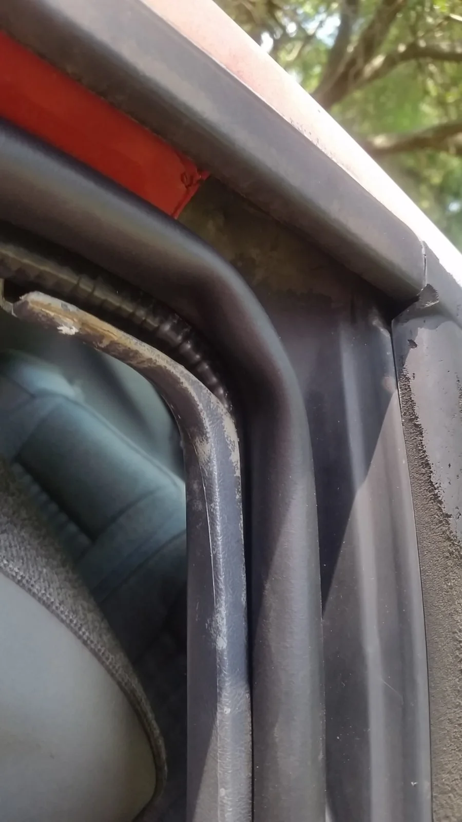

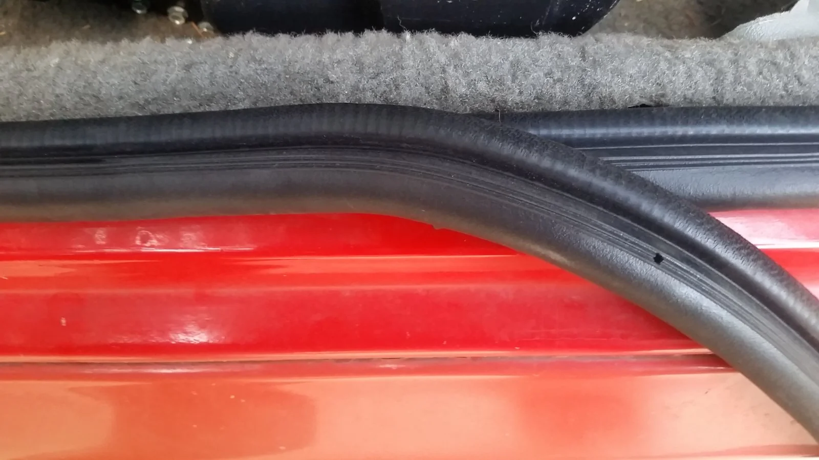

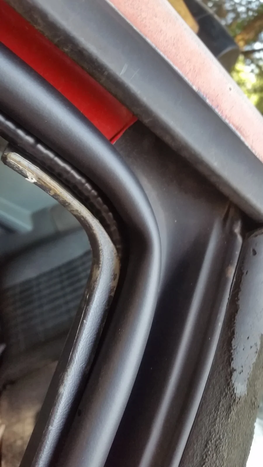

Metro Moulded Parts
The next seal is the Metro seal. As I mentioned in an earlier post, this seal hands down was the best packaged and presented product out of all of them. Unfortunately, I had problems with this seal. I installed it and got to the rear 90 degree bend. This is the money bend if you ask me because it's got to be good here or you will get leaks and wind noise. Look at the pics. I could not get this one to make the curve without a crease or two. It was installed once and tested. It failed the door close test. So I did the wind noise and water test. The seal just wouldn't work in the corner and I got both wind and water in the car. I decided to do something I hadn't done with any of the other seals. I removed the whole thing and reinstalled it rotated around a bit so I could have a fresh section in the corner. It made no difference. See the second try pic. It's a completely different section with the exact same result. One other thing that I could not get pictures of is the corner while sitting in the car. You can put your finger on the seal and move your finger all the way around that corner with the door completely closed. You could actually feel the crease in the seal that way so there's no way that piece was going to be air or watertight. I didn't like the fact that the door didn't close correctly. When I got out of the car I'd have to leg or hip close the door the rest of the way or just open it and close it again. I don't want to do that. At this point, that's as far as I can go on this one.
631119
First install try. See corner creases.
631120
Second try was no better.
631121

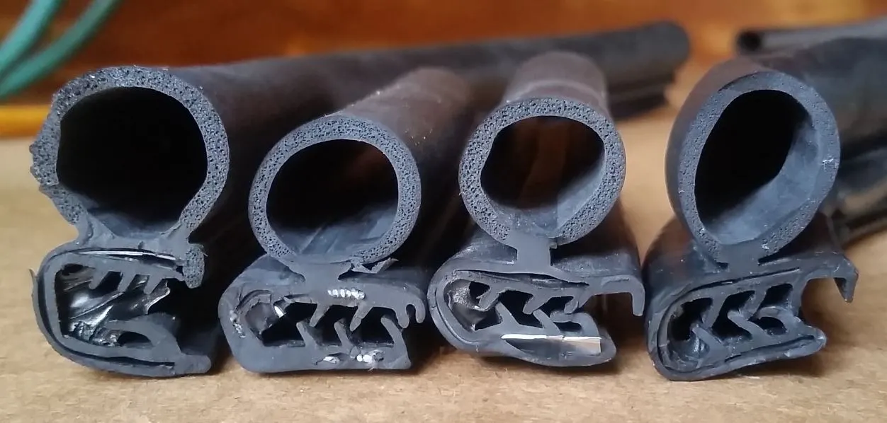

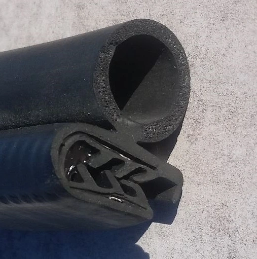

Left to right SoffSeal, Daniel Carpenter, Fairchild Industries, Metro Moulded Parts
Here is a picture of all the seals together with the exception of the LMR seal. They are from left to right SoffSeal, Daniel Carpenter, Fairchild Industries, Metro Moulded Parts. You can see the three little lines on the left side of the first seal's bulb (SoffSeal). You can also see on this seal there is no “rib” connecting the bulb to the mounting channel. Another thing you notice in the pic is the variation in height. Now this wasn't the point of the pic and they aren't pressed to the surface and exact, but you can tell a difference. The DC seal is the most compact. The Fairchild piece does have the longest rib. You can also get a good look at the mounting channel and all the various parts of it. All mounting channels have metal on the inside with a rubber coating. They all cut about the same. I used the large metal shears in the pic above and did it with a single cut all at once. The rubber mallet wasn't used to hammer them in but more of a push tool for the corners. You can tap on the mounting channel lightly just to make sure they are seated if you want. I just mainly pushed with the rubber head because it didn't mess up the finish. Lot's to look at and at some point, I have to stop talking. So let's finish this.
And the best seal is? Daniel Carpenter. I can't overlook the fact that you can put these in the car and forget about them. They are also very little more than the lowest priced ones. And I hate to beat a dead horse but dangit, they went in easier than any other one. The icing on the cake was when I, unfortunately, had to remove the seal and saw all the stringy adhesive hanging on. With that said, the SoffSeal weatherstripping is currently in my car. Why you ask? I'm tired of changing them. If I had a pair of DC seals sitting here to go in with all the glue still in them I'd surely install those. That should tell you something right there. But then again, these SoffSeal pieces are doing fine.
