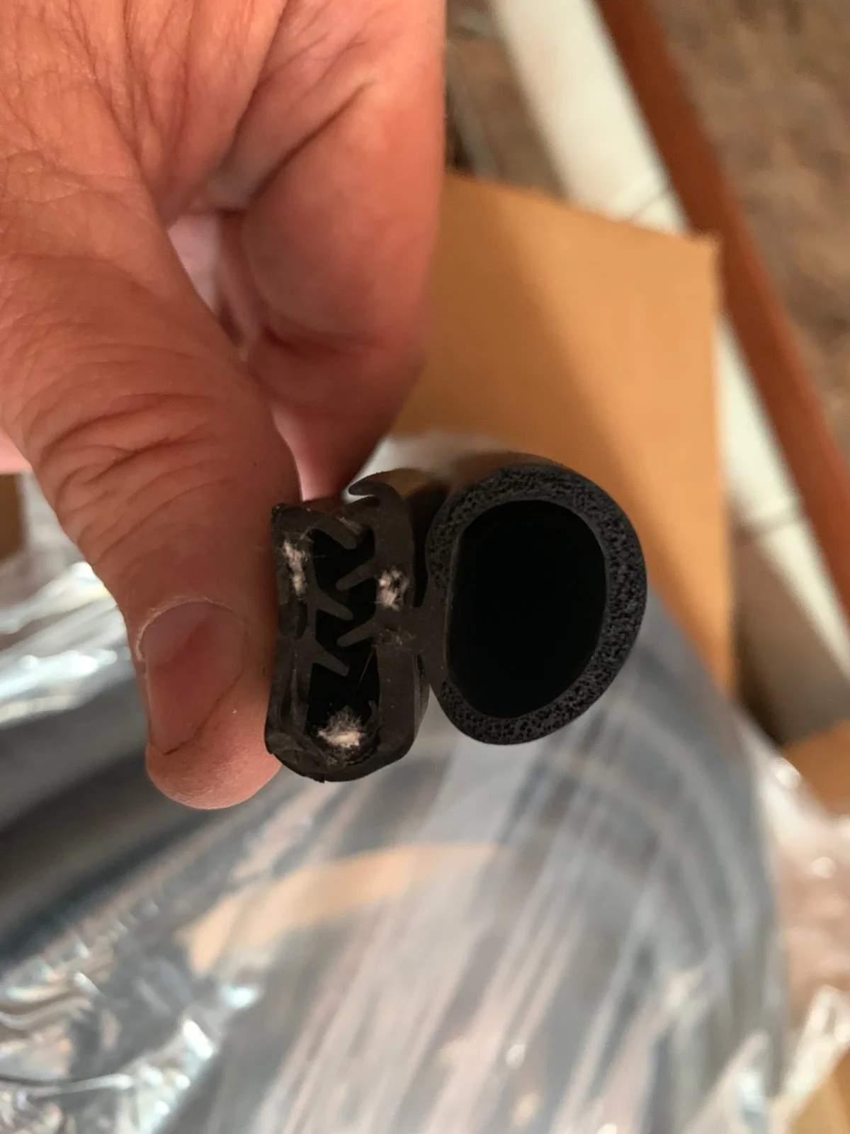

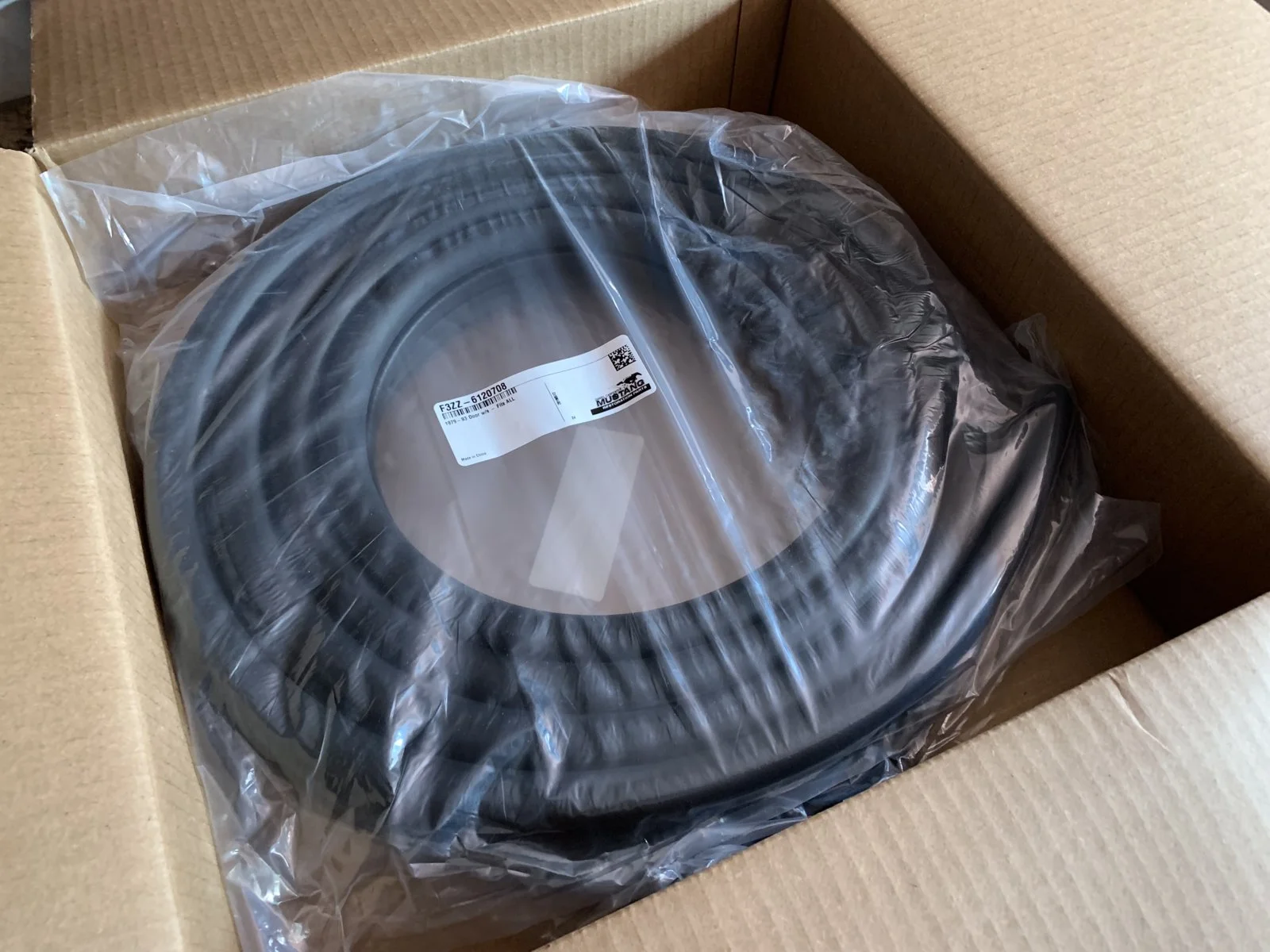

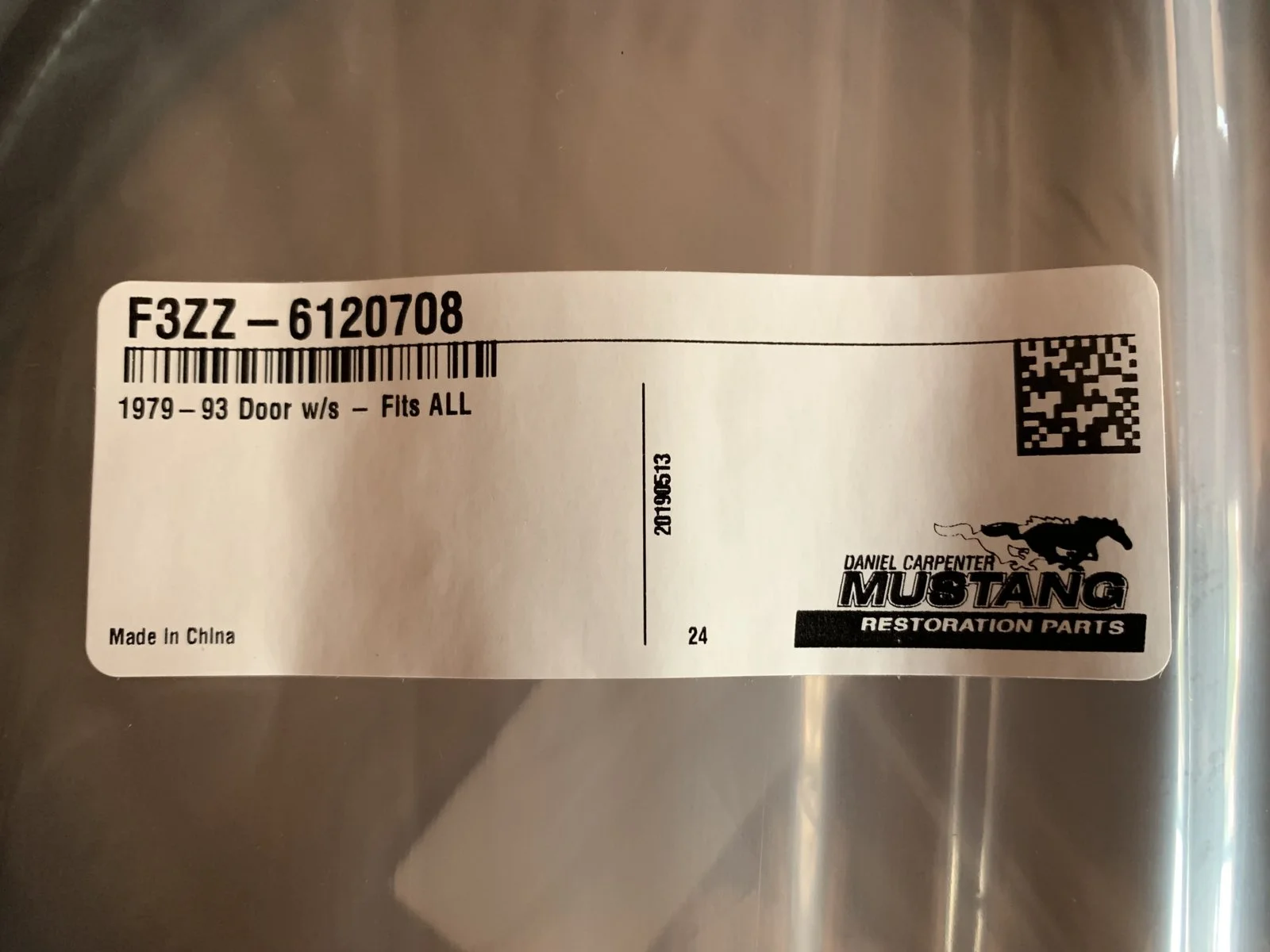

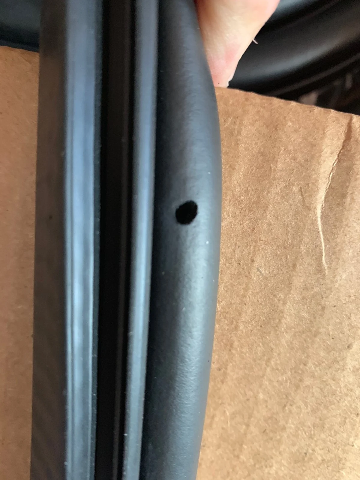

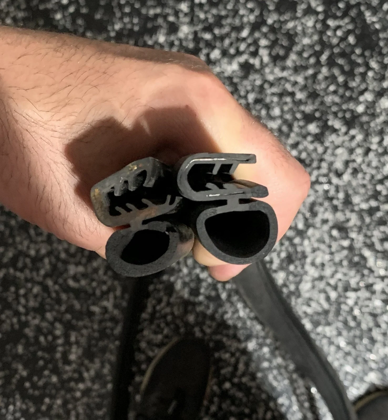

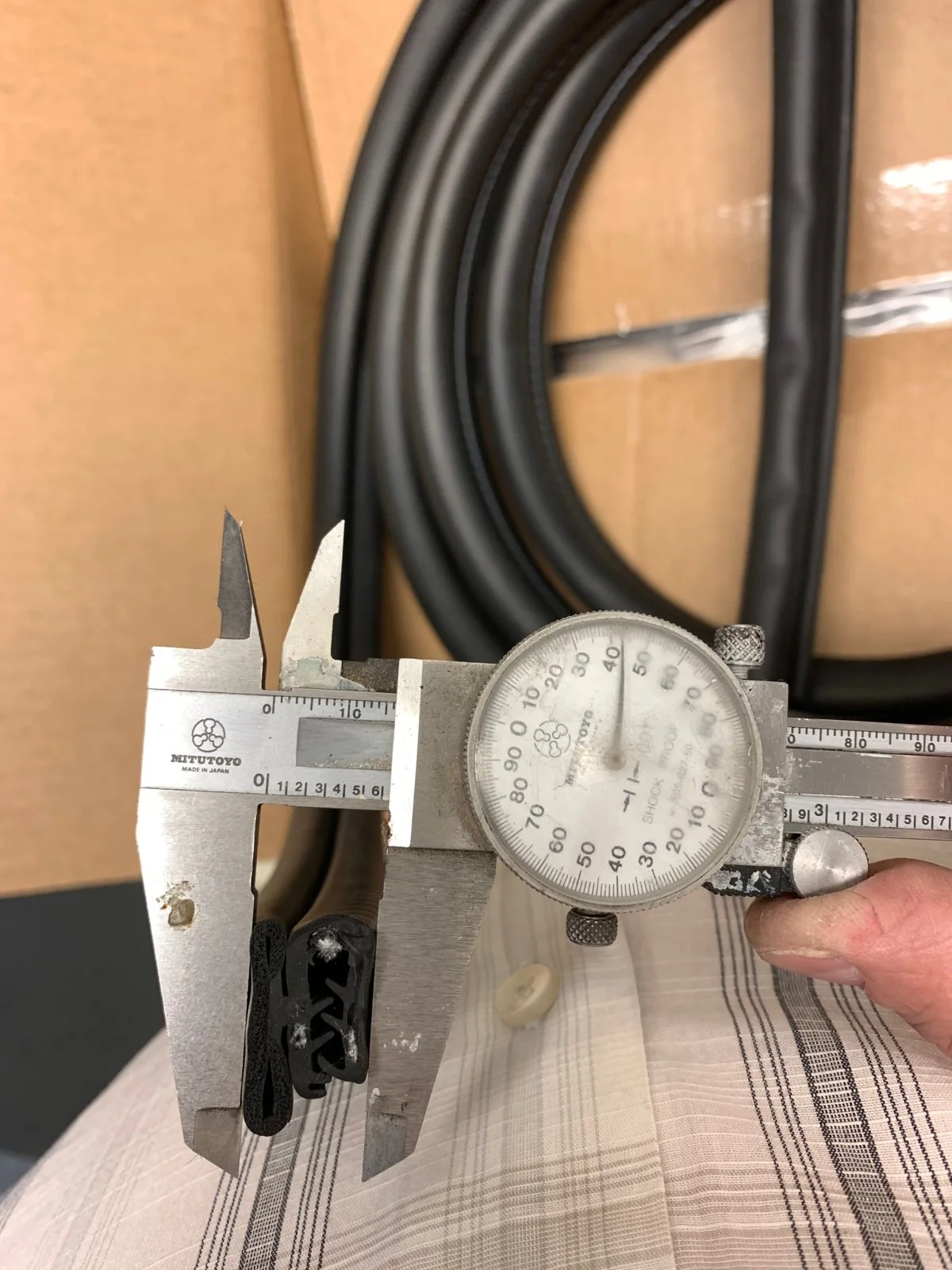

I received the Daniel Carpenter seals from Blue Oval Industries. My initial observations were the bulb was thinner and softer and there was very little rib connecting it to the clamp. Vent holes in the bulb were spaced about every foot. I measured the seal height compressed and uncompressed. Old Seal: 0.846"/0.745", DC Seal: 0.745"/0.655". The seal installed nicely, especially in the corners. The door closed with a small amount of pushing and released with a gentle tug on the handle. I am satisfied with the result. Thanks Wayne for your evaluation of door seals. It was worth the wait.

Thank you....and thanks for the pics. Glad you got what you need.

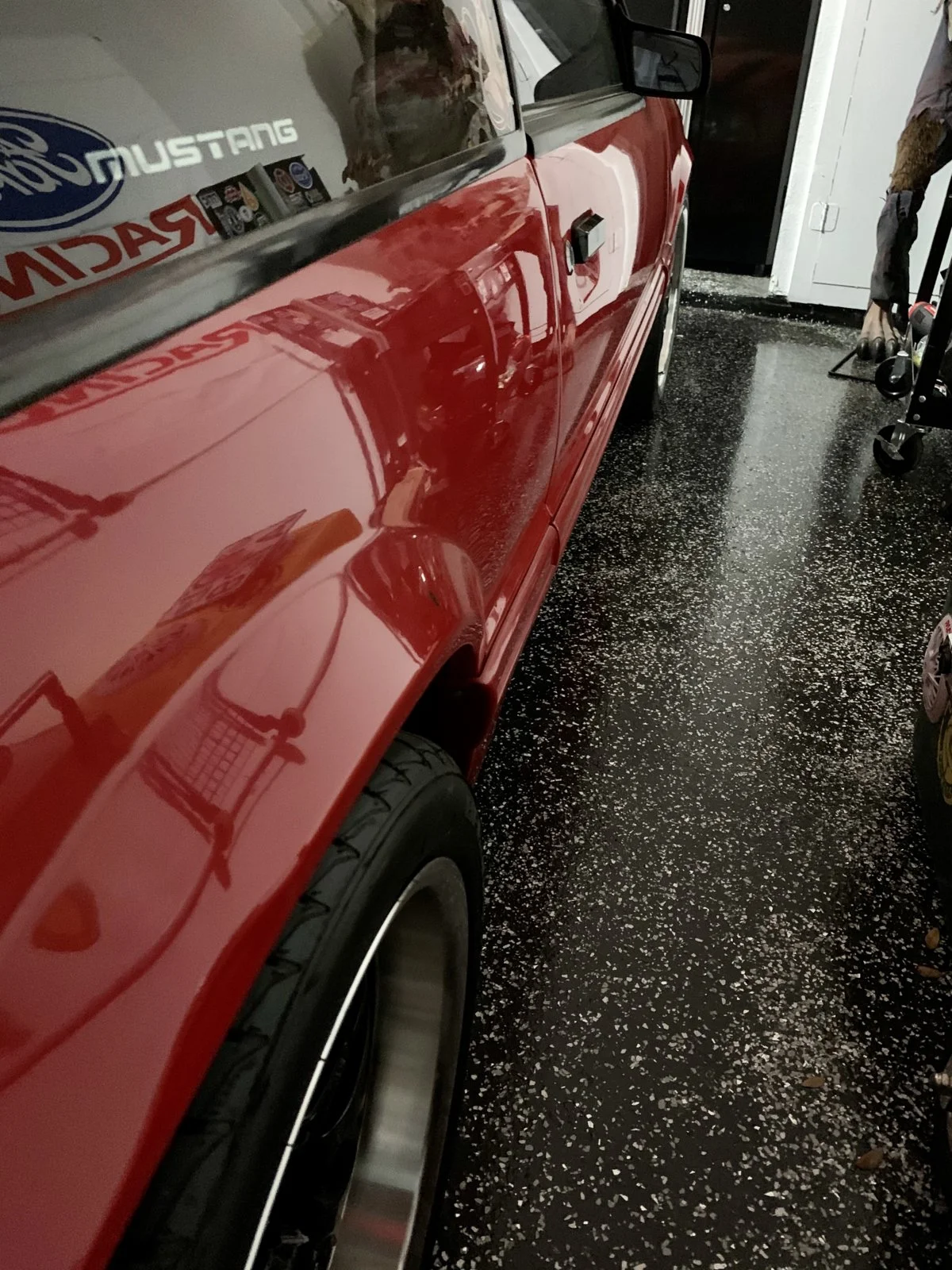

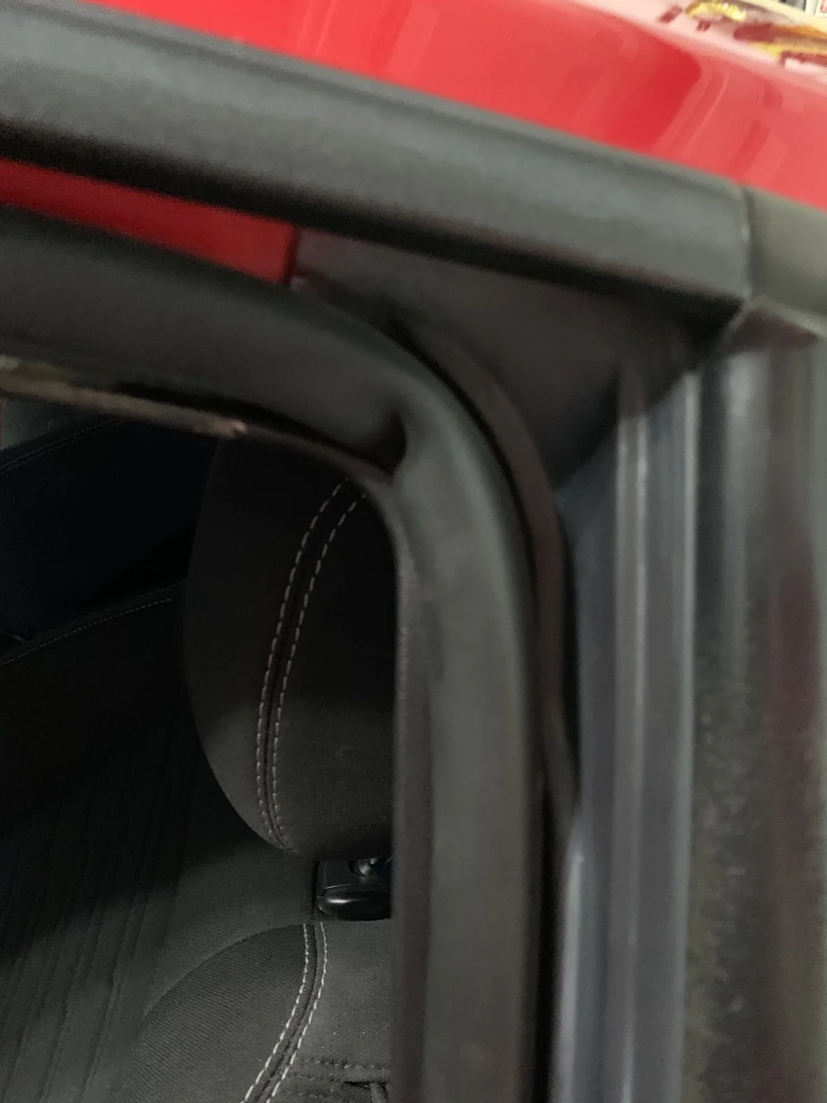

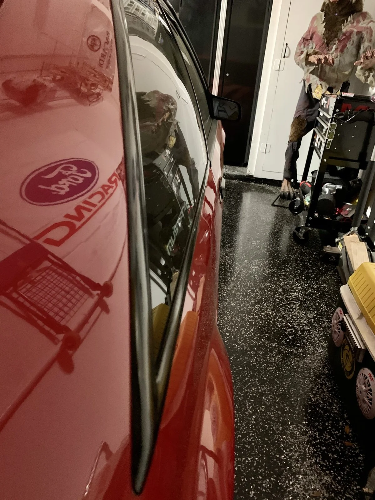

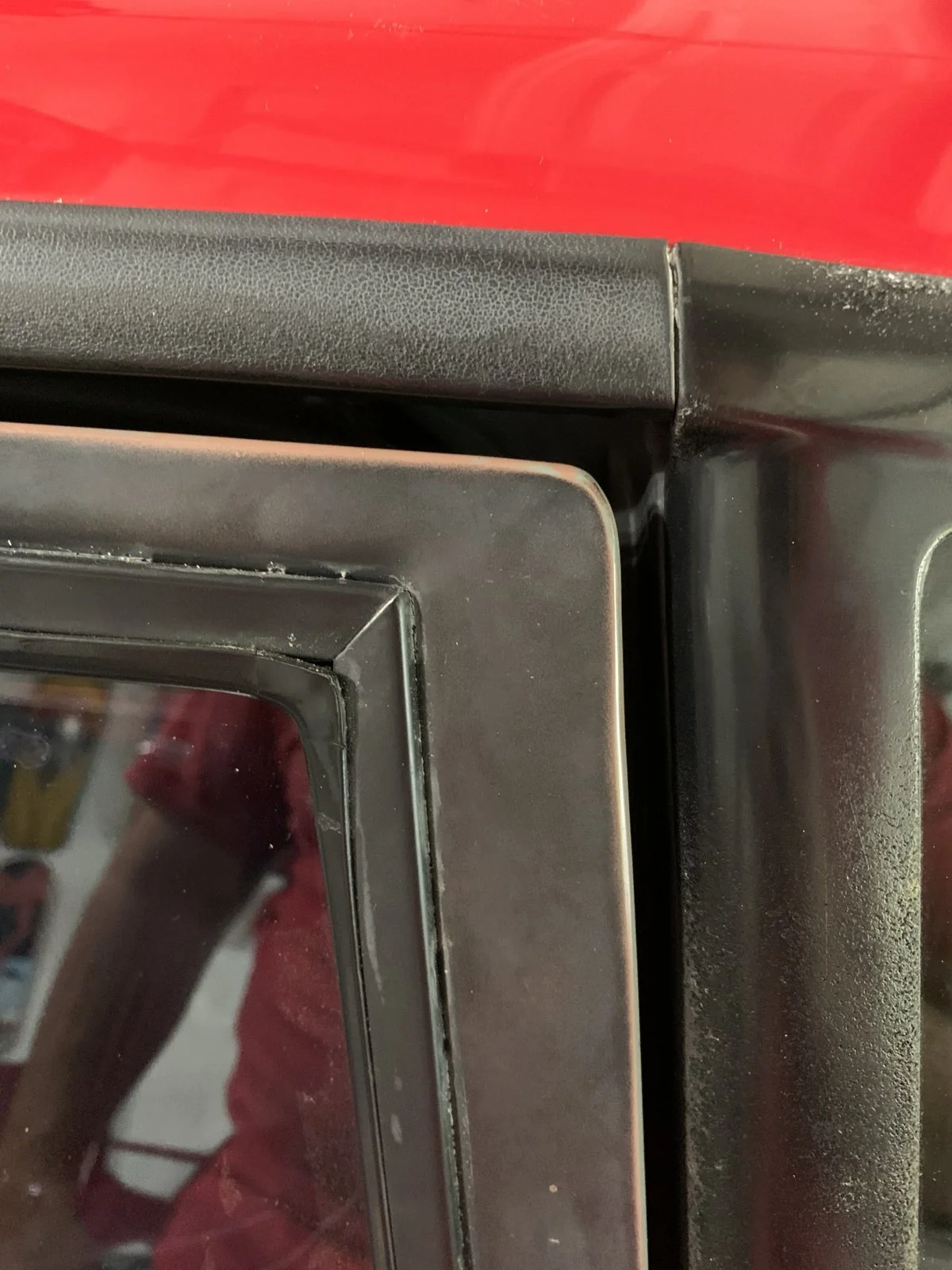

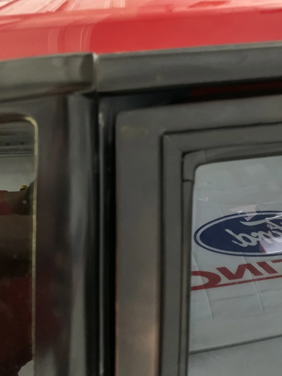

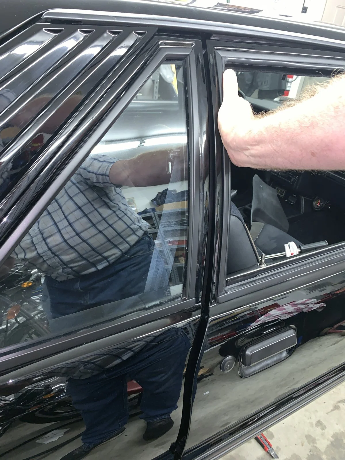

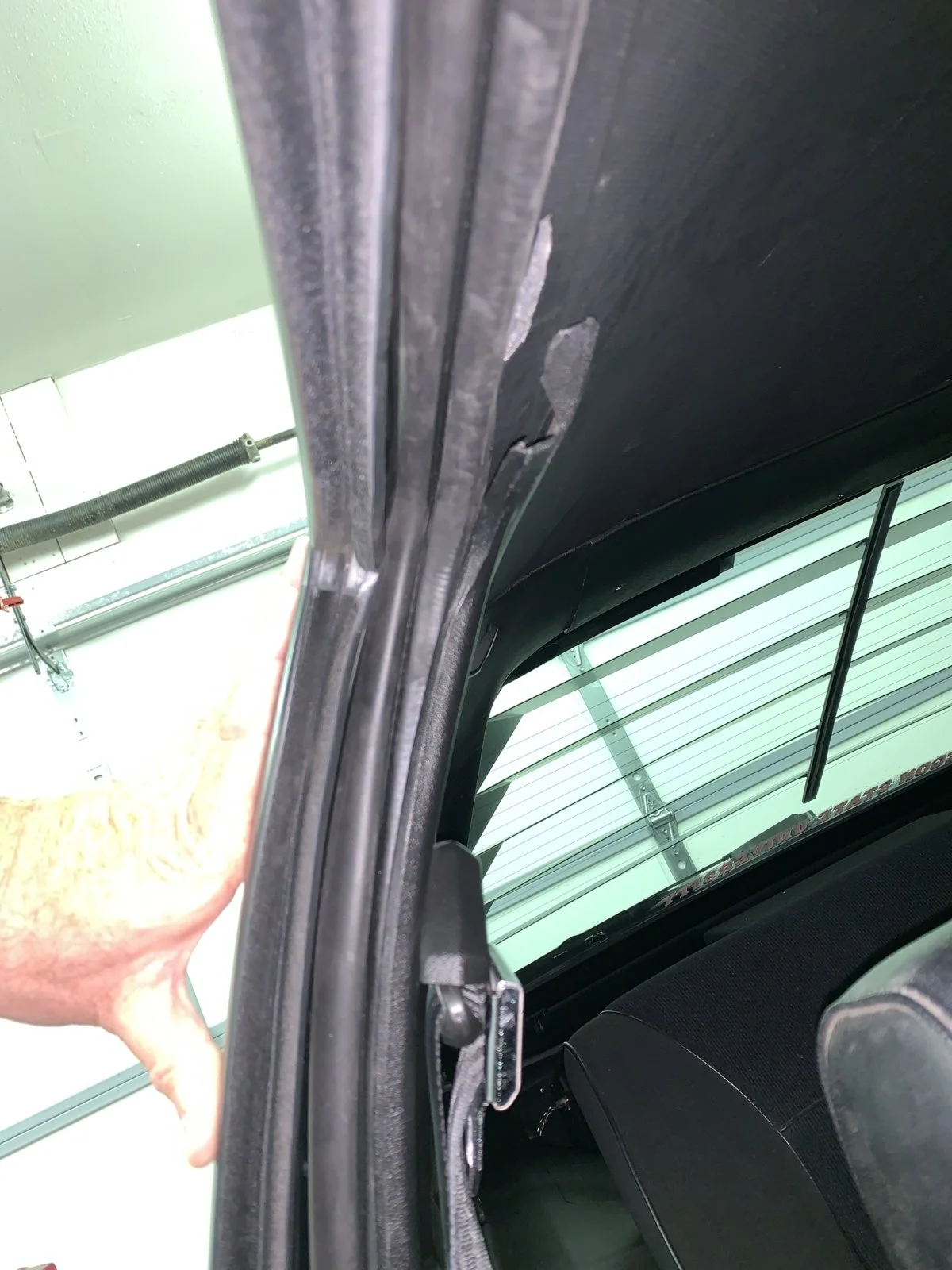

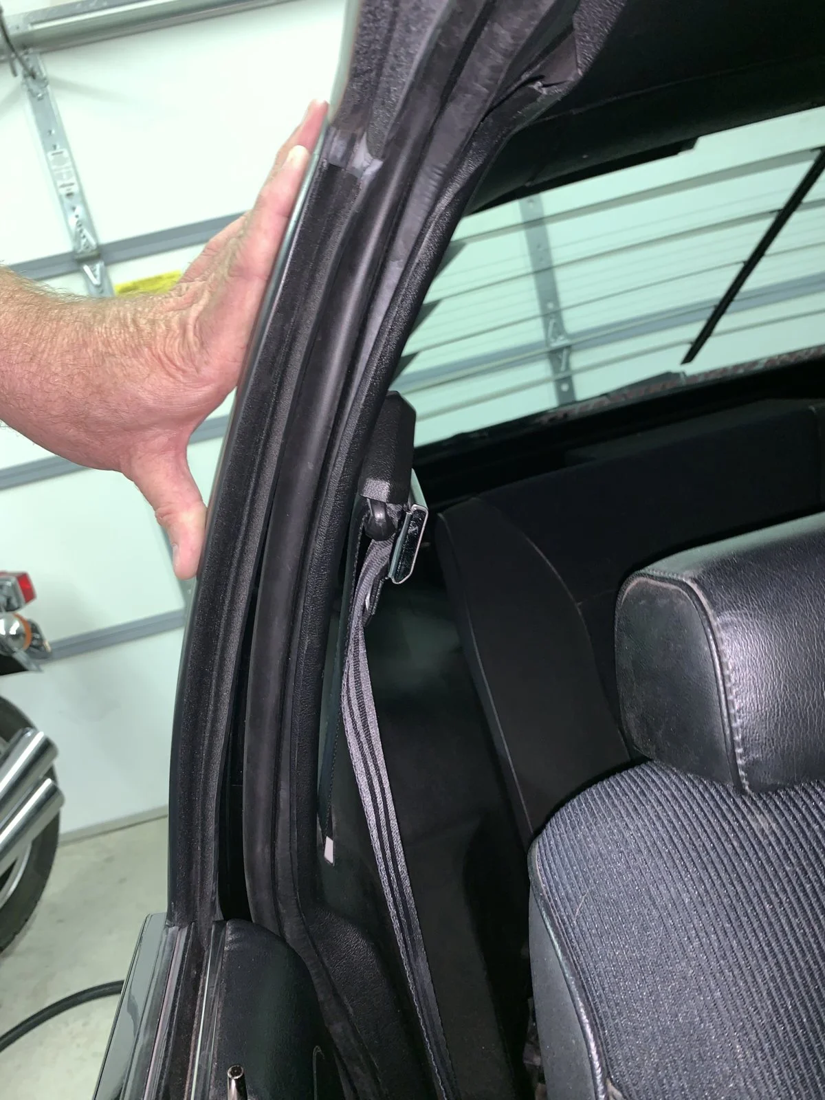

I installed the new DC seal on the passenger side and shutting required tremendous force. I removed the striker and observed the initial seal contact point was at the top rear corner of the door. The door top is about 1/4 inch from flush and the mid point of the door about 1-1/4 inch from being flush. I rechecked the door fit with it slammed closed and it is flush and square. Any suggestions?

That is a door issue. That frame is flexible so when you force it closed it naturally pushes the top outward. Take all weatherstripping completely out and put the striker back in. Set the striker to hold the door flush on the outside so that the door is flush with the quarter panel. Don't slam it. If the top rear corner of the door frame touches before the striker latches then there's your problem.
Reactions: General karthief
I didn’t mention it, but earlier I did pull the door seal and adjusted the striker bolt so closing the door left the door flush with body. The rear corner of the door frame was set in too far about 3/8 inch. Question is how do I fix that? Can the frame be tweaked outward by loosening some screws inside the door?
