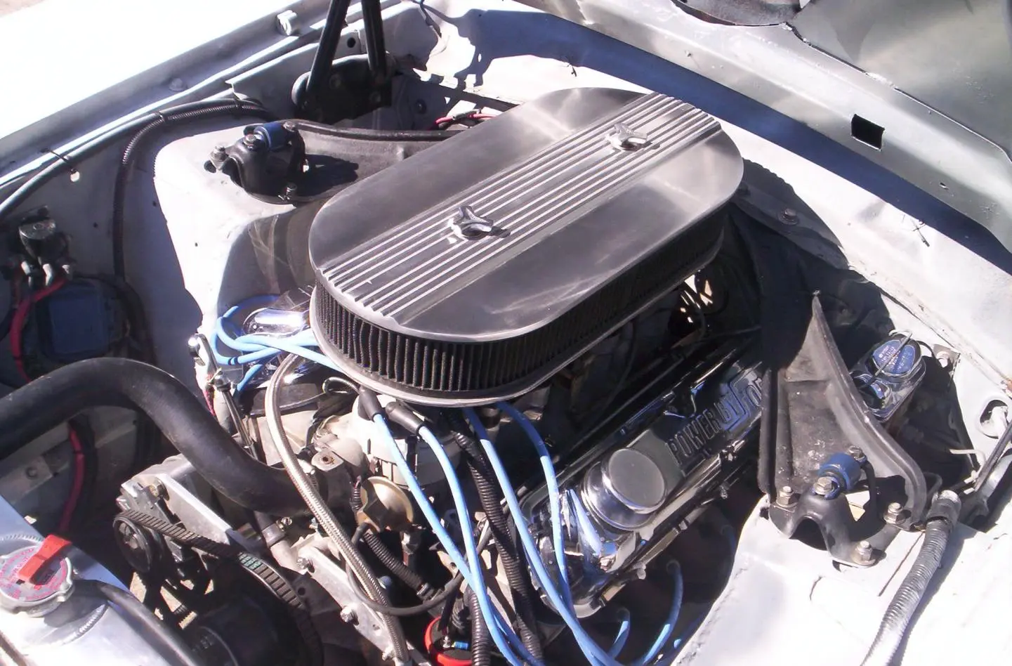

I have the Edelbrock air gap dual quad on my 68 Cougar. If I were going to do it again, I'd look real hard at putting the blue thunder re-pop on the car instead. (the Edelbrock dual quad set up will only fit the Edelbrock air cleaner) The biggest reason is that, I prefer Holley carbs, and I would rather have the Cougar scripted dual quad air cleaner on it. Take a look in my photo bucket page, and you can see how my set up turned out. I have a 'glass hood with the GT-E scoop molded in, so clearance for me wasn't an issue. I "think" the air gap will clear a steel hood, with out the insulation.

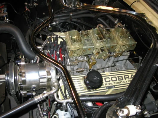

Too bad you're off multiple carbs. This setup fits under the stock flat hood and works extremely well, and the 'holy crap' factor upon opening the hood doesn't hurt, either.
:nice:Times two. :nice: This is what I've had on the 331 in my 77 Comet ever since I built the motor 6 years ago (had the motor in my 89 Ranger too) Dead reliable, runs fantastic, ain't touched the carbs since the initial tuning, other than a rejet after installing spacers under em. Always get compliments when the hood is lifted, many times they're speechless cause they don't know what multiple carbs is.
