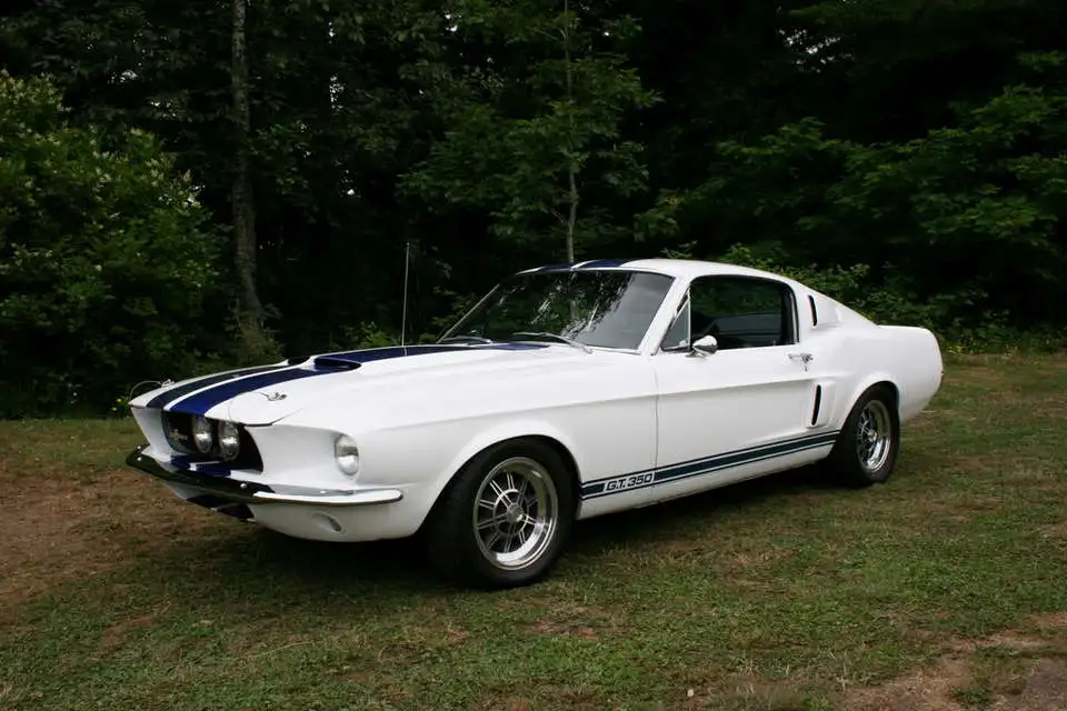

Mine has the one-inch A-arm drop, plus one full coil cut off the stock springs. To give you an idea of where the front sits, my lower control arms are level. I'd like to install some slightly stiffer springs, but it rides so nice with the cut stockers, that I'm reluctant to take them out. Here's a shot of the front to kinda give you an idea of how low the thing is:
Love the stance! I've only cut 1/2 a coil off but that's 620 springs. I'm running 235/15R60s up front and plan on doing the drop and wanted to make sure there wouldn't be a problem with the cut springs. Once I do the drop I may cut more spring if needed.
