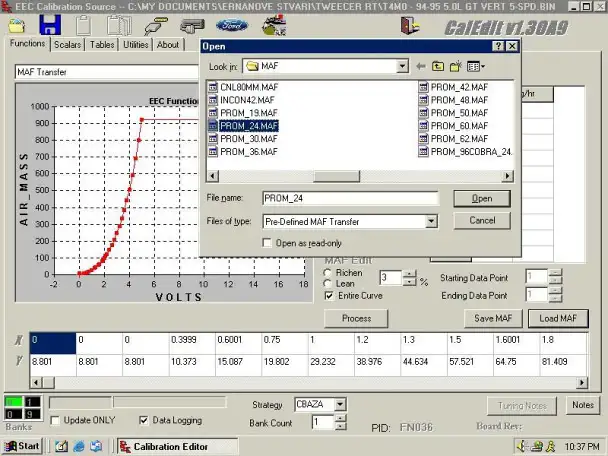

Nope , that I tryed first 2 days and I was scared about Cobra strategy so I went with T4MO with fixed 24# , prom 24# MAF curve and bunch other stuff, I droped A/F ratio to 13.5;1 but on hot starts now keep stalling (if I play with gas pedal for like minut it won't stall)

Hey guys I have little trouble with idle goes up and down a few times and stall, I have a lot changes on tweecer so I tryed again fron little things and I come up with
When I load pro m 24# MAFF idle goes up and down when I start car (cold warm or hot) if I keep foot on gas for like 30 sec idle stay at tight so problem is in that PRO m 24# load on tweecer , doesn't metter what else I tweek and add if I run without that pro m calibration everything is fine
Anyone know what I have to do with MAF cali
