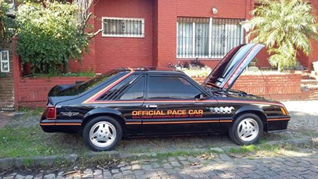

New Topic: Getting ready to paint this weekend ish.....Still lots of sanding and filling in the engine compartment.. However, my next project will be the front
suspension. I have a set of disc brakes, front and rear, from a 1995 Mustang. Also have the rear axle complete. I know I need to change the front ball joints to the 95. Can I just replace the entire lower control and use a 1995 or is there a big difference. I know I need to change the tie rod end. Also replacing shocks and springs with coil overs all around. Any information helps... Larry
