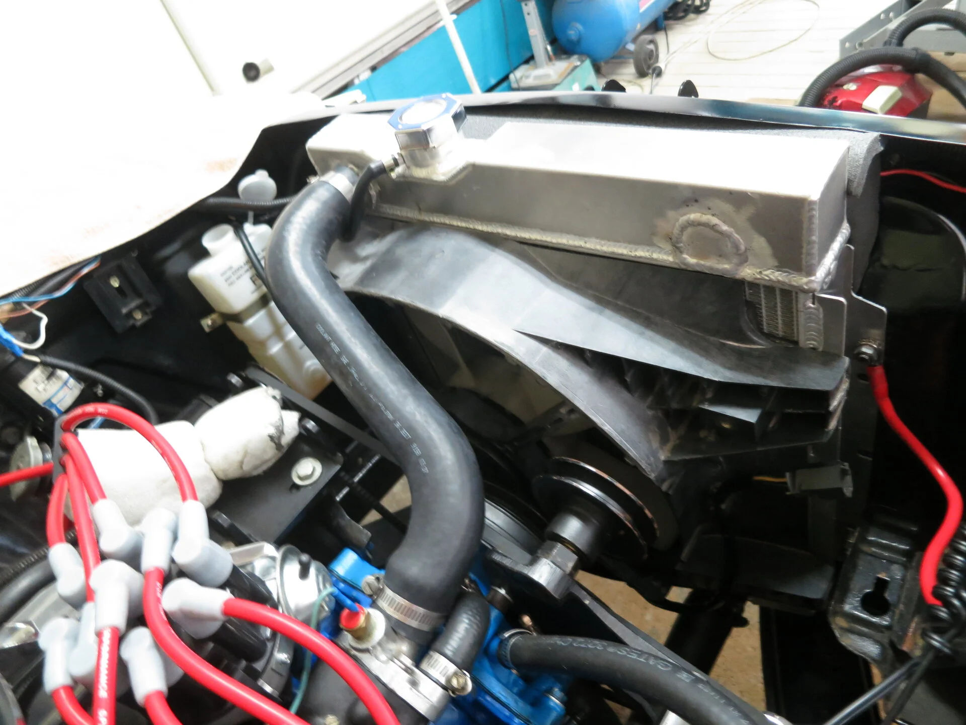

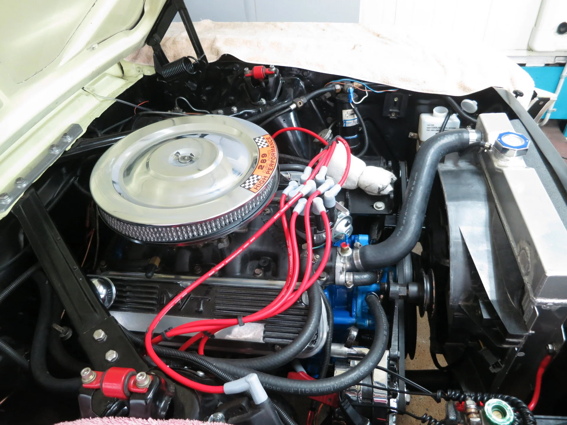

How bout a pic of the engine compartment, when does the overheating occur, steady speed, sitting still at idle?
How many cfm does that brand x fan put out?

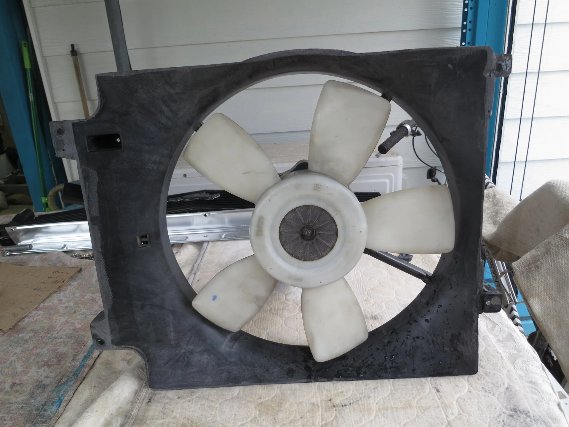

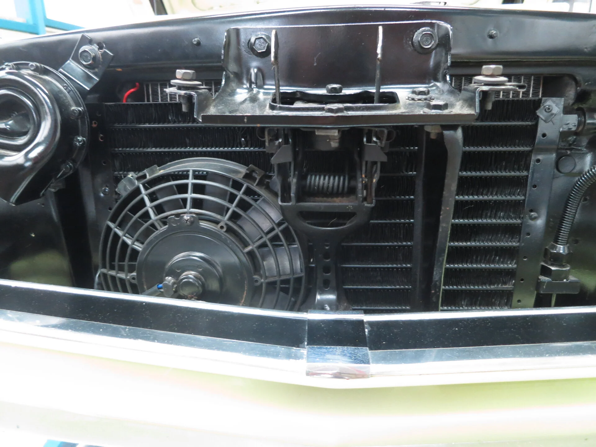

Hi thanks for your help, the overheating is at idle and on highway. Reads about 200F Not sure if CFM it does pull a lot of air. Timing 10 - No vacuum advance, any help would help.

This likely is not a head gasket problem, if they were backwards the temp would continue to rise, one thing I noticed was the alternator, does it produce enough amps for the fan?
How is the fan wired?
Is there a space, I think 1/2" (13mm) would be a minimum, between the ac condenser and the radiator?

The 160° thermostat isn't helping (should be a 180) and the little electric pusher fan is probably blocking more air than it provides. It also looks like the blade is on backward.
To have effective electric fans, they really need to be quite powerful and typically need a 130A+ alternator. My suggestion would be to ditch them altogether and use a shroud and factory-style flex fan or a thermostatic fan clutch.
