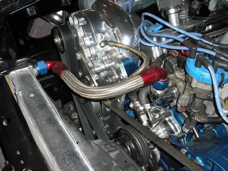

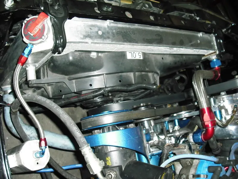

New engine goes in, Same setup, now my car doesn’t want to cool down, Once I hit 180 it just keeps going. But then when I park it slowly comes back down from 220 or higher. It used to cool ok, sometimes ran hot when in allot of traffic before. I even added a pusher fan on the front to make sure I had adequate air flow Here is the setup. The fans do turn on at 180 but it does cool the car ?
Alum. three core radiator
Upper hose is AN fitting lower is hose
180 thermostat
FMS water pump
I will attach pictures as well. maybe some one can spot something that wrong, im just frustrated with this thing.

i'd ditch the AN hose. with the restriction, it could be causing the coolant to sit in the block too long and it's constantly trying to cool it down, but to no avail. the longer it sits there and gets backed up, the hotter it will get and less chance to cool.
what was wrong with the tube that came with the blower?
When i had the car built they did that to the radiator so it would look cleaner, it did work before I pulled the engine out. I would probably have to buy a new radiator b/c the neck was tig welded on there.

I mean when you put your hand near the front of the car you can feel the air being sucked in its so powerful. its turned on by the DCC controler
If the temp is able to come down at idle (even if slowly), then you don't have fan capacity issue. Since it's overheating while driving, you have a rad capacity or water flow issue. I highly doubt its the rad, unless it has some build up on the cores (which would reduce heat conduction).
I'm with the others, I don't like the upper radiator hose (from a water flow standpoint). That being said, the previous setup had no cooling issues.

To get rid of the upper AN hose I Will have to bring it in and get it re tig welded or buy a new one, What confuses me is that the guy who put that on has it on many many cars so I just cant see how it would restrict anything. The coolant literaly shoots out of the fins, maybe Ill post it for you this afternoon.
