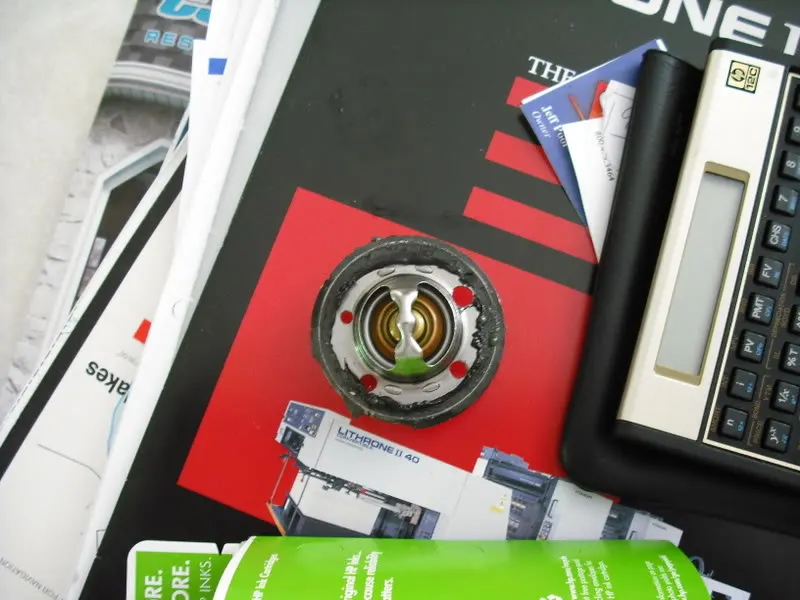

here is a pic of my old t stat look at all the holes someone drilled in there, I only put 1 hole on the new one

They went way overboard on the holes in the t-stat. That might also indicate that someone was having a big cooling problem at some point before.

Most thermostats have a bleeder hole you can drill 1/8" hole if it does not have one but don't do what your old thermostat looks like and what with all the RTV?
