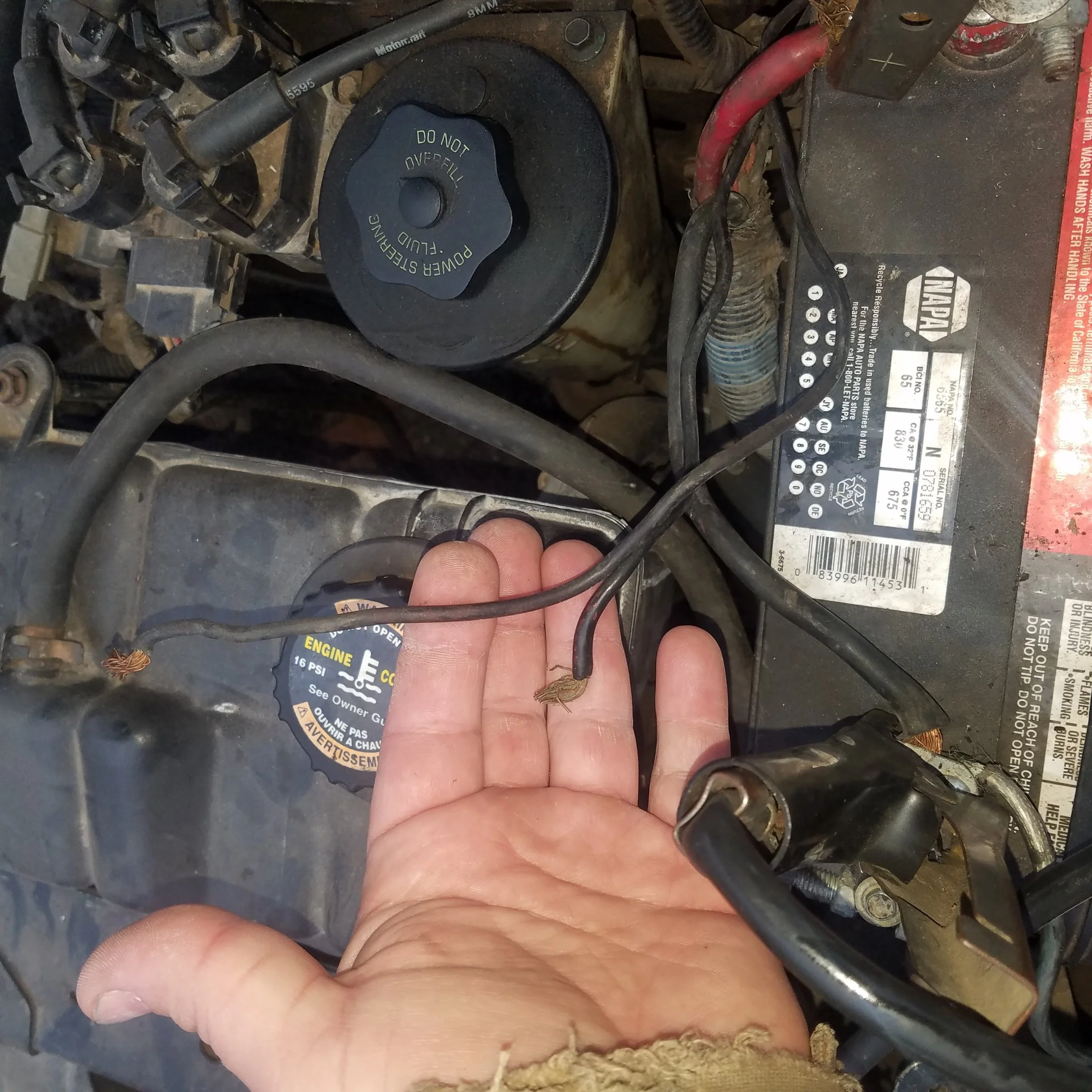

went out to pull the battery and found these two wires that appear to be possibly grounds. They come from a round connector that is under the fuse box next to the battery. Any idea what they are and where they go?

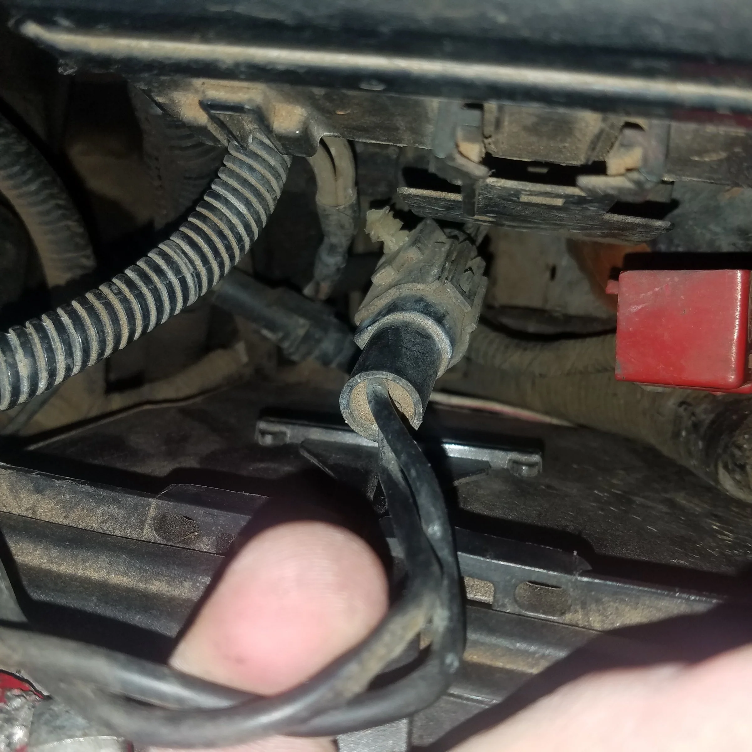

I got a closer look at the wires under the fuse box one appears to be black with a white stripe and the other appears to be black with a yellow stripe that's before the connector. After the connector they both go to larger black wires that I'm holding in my hand in the picture.
The round connector with the large black wire carry the CCRM and PCM grounds. These grounds are CRITICAL to the operation of the car's electrical system. A poor CCRM/PCM ground could absolutely cause the posted symptoms.
The Mustang has a ground system that bonds the battery negative to the radiator core support together. This in turn then goes to the round connector. From there onto the PCM and CCRM.
If asked to guess, the missing wires are part of the radiator core support ground.
The Mustang has used the same grounding system from 1996 through 2004. Do you have a buddy's Mustang to look at? Or how about a salvage yard in your area?
