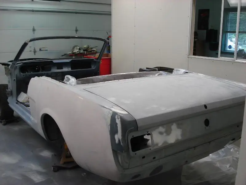

I'm working on a 65 vert and doing a color change and have a couple questions. I haven't dealt with the crinkle type finish on early Stangs before. So if anyone has done this, how have you stripped it, I don't want to sand it flat and scuffing may not get in there enough plus it's no doubt laquer, in my case probably 1K aresol from the PO :mad:
Also, what did you use for paint, satin finish? It's going to be black inside, red outside.
Here she be :D
