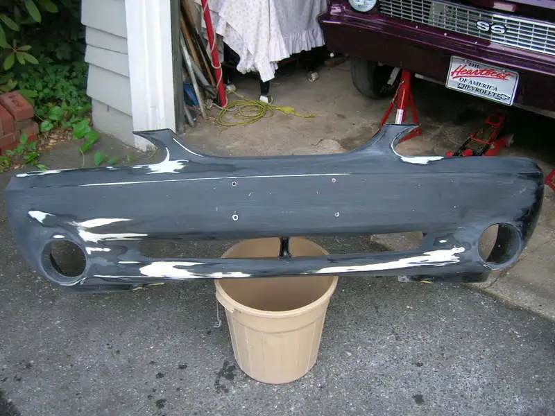

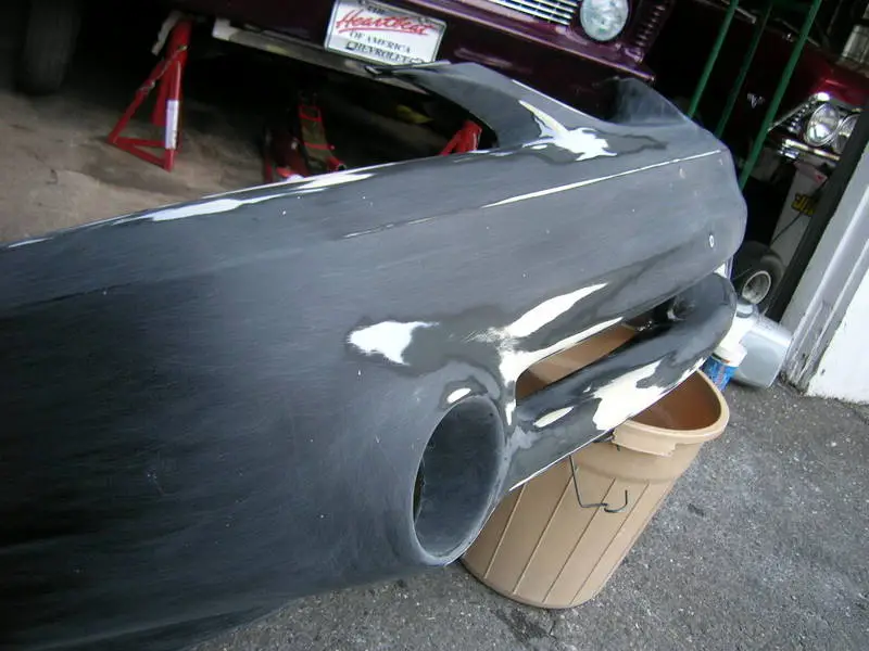

actually its really funny you mention that because before i hit the curb with the current bumper, the paint started flaking off on the same side, and i was convinced that it was a lack of flex agent...i guess that cleared up my suspicions, thanks! heres a pic of the bumper, let me know if you think i need adhesion promoter...
I would think you wouldnt need the adhesion promoter...just get some good primer on those "bare" spots..maybe 2 light coats and wetsand it with 500 wet and then wax and grease remover and you should be golden..
