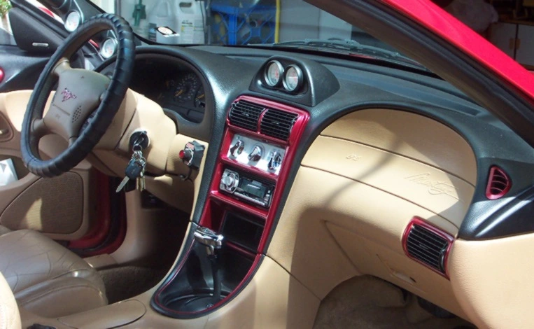

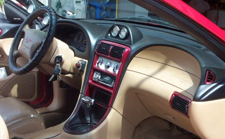

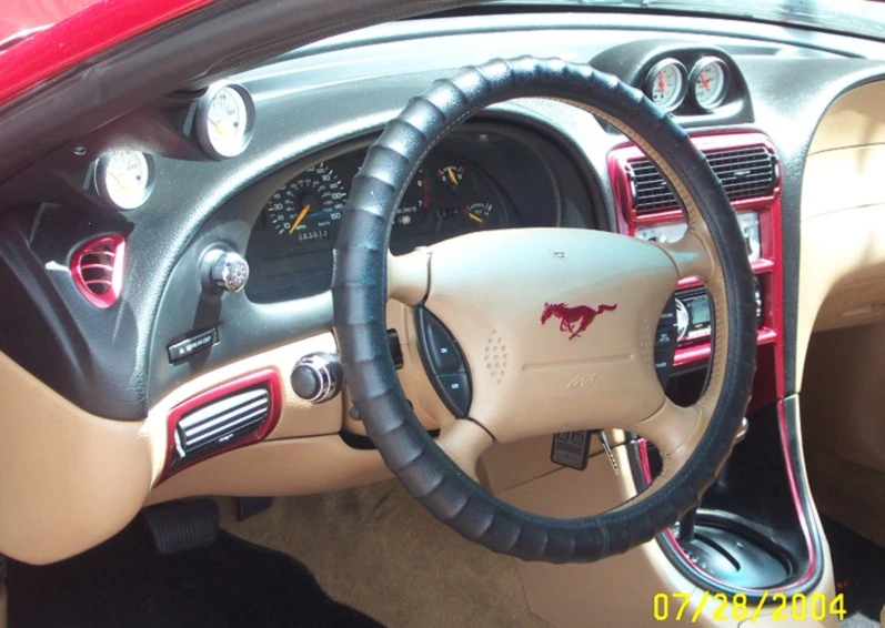

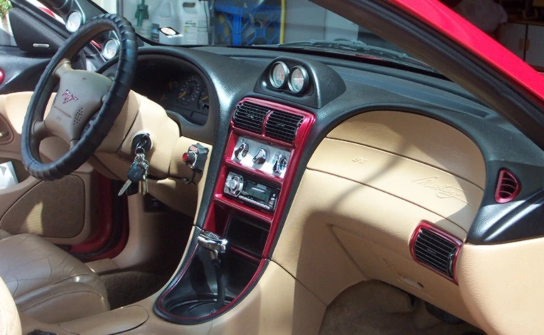

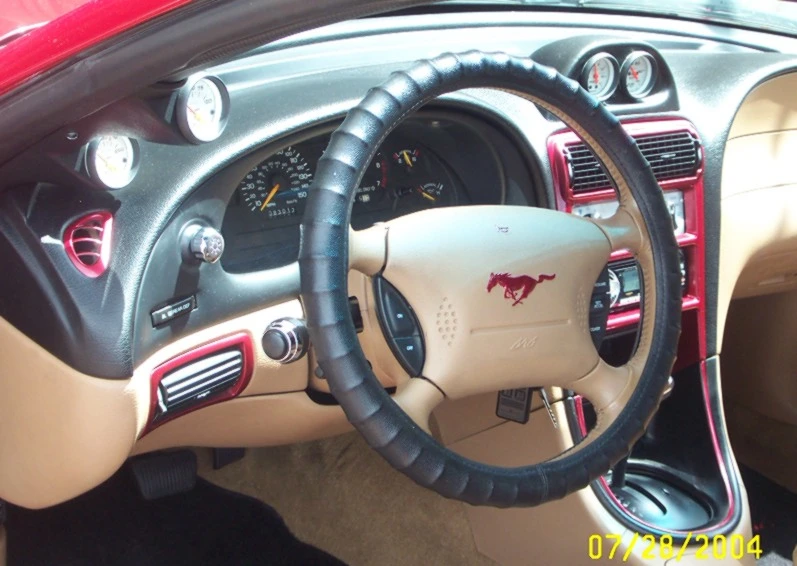

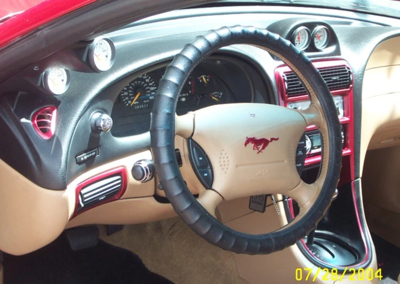

Wow, that looks really nice... Unless I read over it, I don't think it was posted, but what type of paint did you use? How did you go about prepping the surfaces?
Light 400 grit sand.
Alcohol clean.
Couple lite coats primer.
Light 400 sand.
2 lite coats color
Light 400 sand.
3 lite coats color.
3 lit coats clear...
Used Walmart Generic primer and Duplicolor PAINT.
FINISHED THE VENTS AND HORSE:
here is the post from the other thread ...
94GTLaserRC said:
1. Light sanding..
2. 2 lights coats of primer
3. 2 lights coats of red
4. light sanding.
5. 2 light coats red
6. heavy coat of red
7. 2 light coats of clear
8. heavy coat of clear..
(so many layers since it is going to be "handled"
Let dry well
RC
Alcohol clean.
Light 400 sand.
2 lite coats color
Light 400 sand.
3 lite coats color.
RC

ChingoChee said:
did you ever consider recovering the Mach tweeter pods with a red mesh?
good job on the horse, are you going to attempt to paint the MUSTANG lettering on the passenger airbag cover?
Chingo..Where the H3ll have you been?
Actually, I read the tech article on here about the redoing the mesh on the Tweeters...it's a thought.
As far as the "mustang" on the pass side, Im not sure....I had to spray the paint into a cup..it needs to be fairly liquidy to apply..When I was doing the horse, it kept "thickening" up on me.. When it's too thick, too much sticks to the bristles of the brush.
JR..you gotta do the little vents.
Black Vert: I guess you could use SW, but it cant be the really fine grit...You just want barely enough to etch the surface lightly..that ensure that all the grease and dirt is gone..then you clean with alcohol.
Thanks all.
RC
