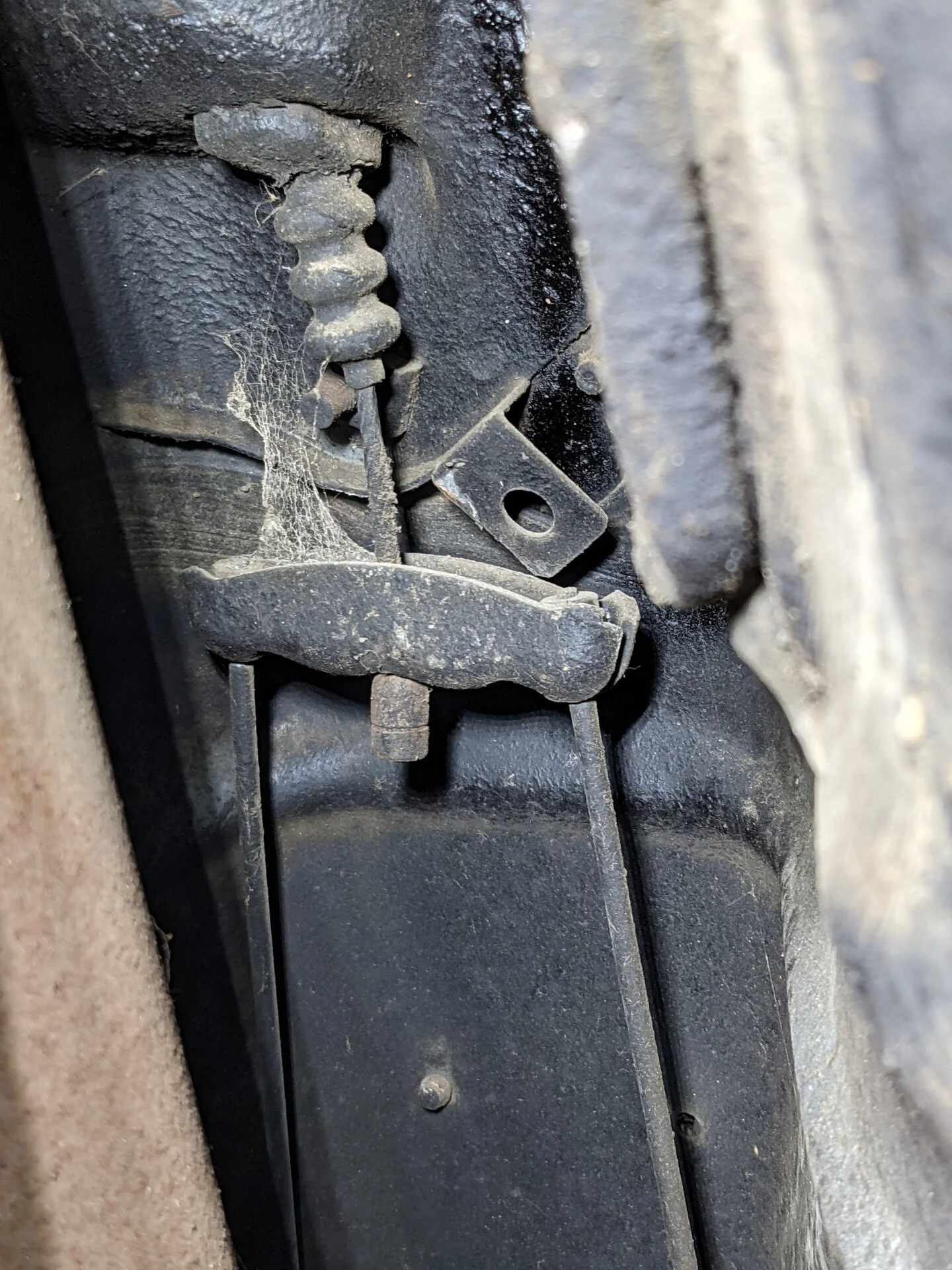

The parking brake is not holding my 2.3l convertible in place. I took a look underneath while my friend engaged the parking brake, and found that the brake cables are not being pulled at all. (In the picture you can see cobwebs indicating it hasn't been moved in a while). Assuming there is no issue with the cables and rear drum brakes, is the issue the handbrake assembly then? If so, is there a way to adjust it so it will actually pull on the brake cable?

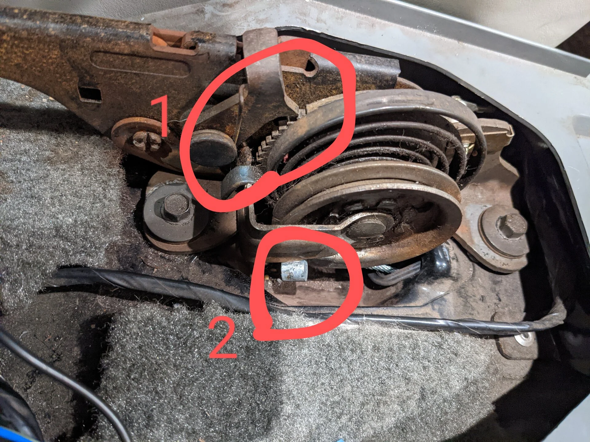

I looked at the E brake assembly and noticed something that seems a little off:
While the e brake is disengaged, the pawl is sitting on the top teeth of the gear (see location 1 in picture). Is this where it's supposed to sit?
I tried to move the pawl down by rotating the teeth on the gear upwards (clockwise in the picture), however the metal bracket of the assembly is preventing the stopper on the end of the e brake cable from moving, because the gear with teeth is connecting to the wheel that holds the e brake cable (location 2 in picture)
Is there e something I'm doing wrong? Is the end of the e brake cable supposed to sit on the outside of the wheel, as shown in location 2 of the picture?

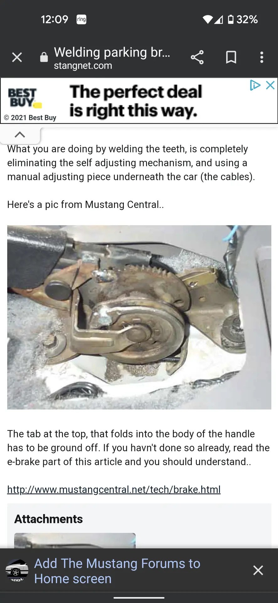

Just found this picture online of how it's supposed to look.. guess I will have to remove the parking brake assembly and try to readjust it so the end of the e brake cable sticks out on top of the metal bracket? Assuming I will need to stick a pin in the assembly and release the tension?
I fixed it! Turns out I just installed the e brake cable improperly to the handbrake assembly. The metal end of the e brake cable should sit snugly in the groove of the retainer. Mine was sticking out of the retainer, preventing the retainer wheel from spinning when I released the tension.
