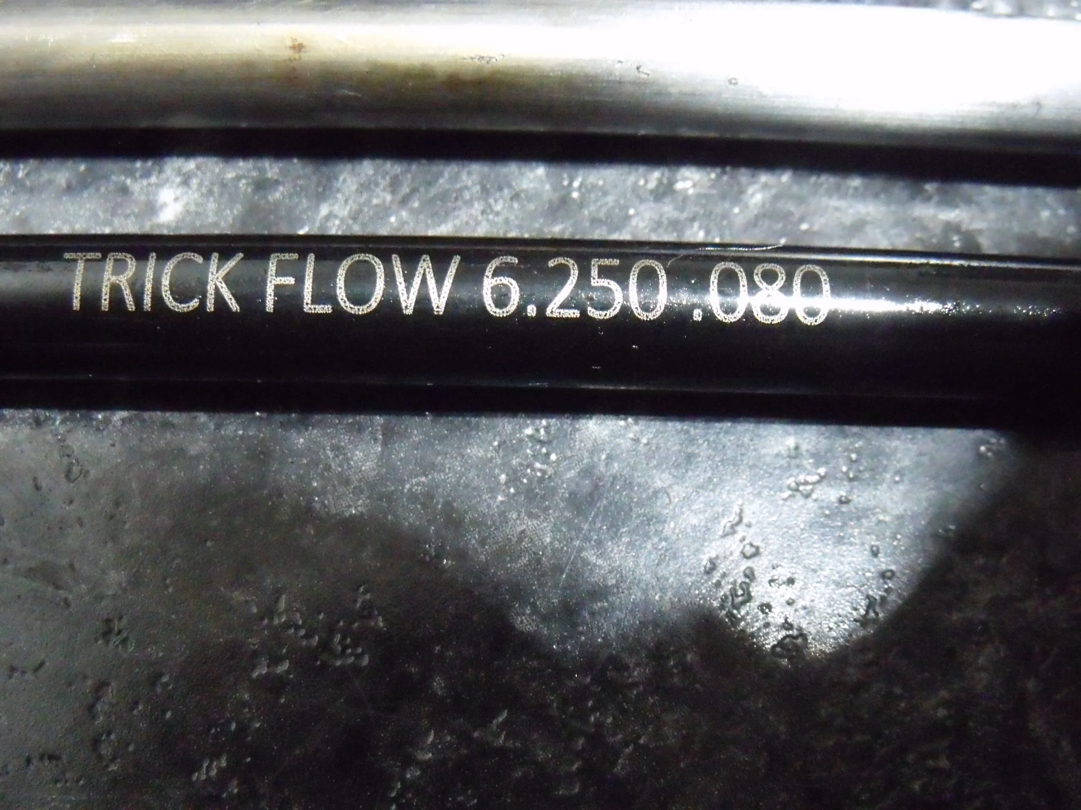

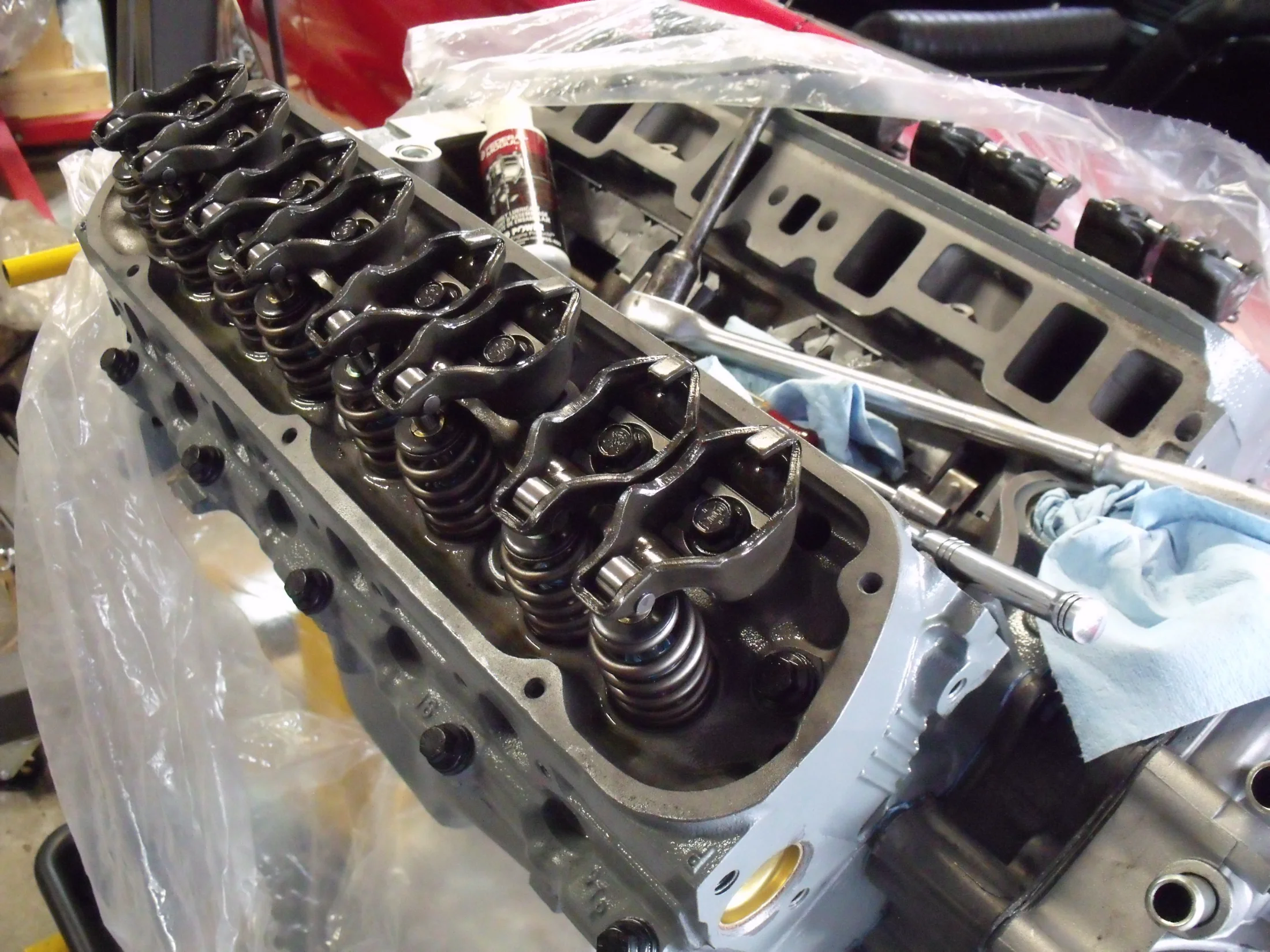

On my " P " heads I used
Alex's parts for beehive springs
Lunati roller " TIP " rockers
Trick Flow pushrods
Most parts were changed as I just hate putting used parts back when everything else is new.. The "P" heads came on my Explorer engine so they were not an additional purchase... Not sure how many miles were put on these used parts in the engine so " while I am there".... LOL
If I can update to "better" parts while doing this I will, but this does not mean for additional performance. I was looking to build a nice street engine on my car...
Thicker walled pushrods cant hurt, The roller tipped rockers are supposed to help with valve wear...
My opinion of roller rockers on a street car is " gosh, they sure look neat"......
