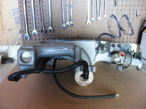

HISSIN50 said:
We're talking about the Tee on the driver's side of the intake (where the PCV valve line splits and goes to the underside of the plenum and to the driver's side of the plenum), not the two nipples on the PCV valve itself.
Here's a picture reference of what JT is talking about (for future references/searches)
nmcgrawj
Advanced Member
Sep 28, 2003
3,651
68
Indianapolis, IN
Jun 20, 2010
#17
  • Jun 20, 2010
  • #17
Bingo. ^
