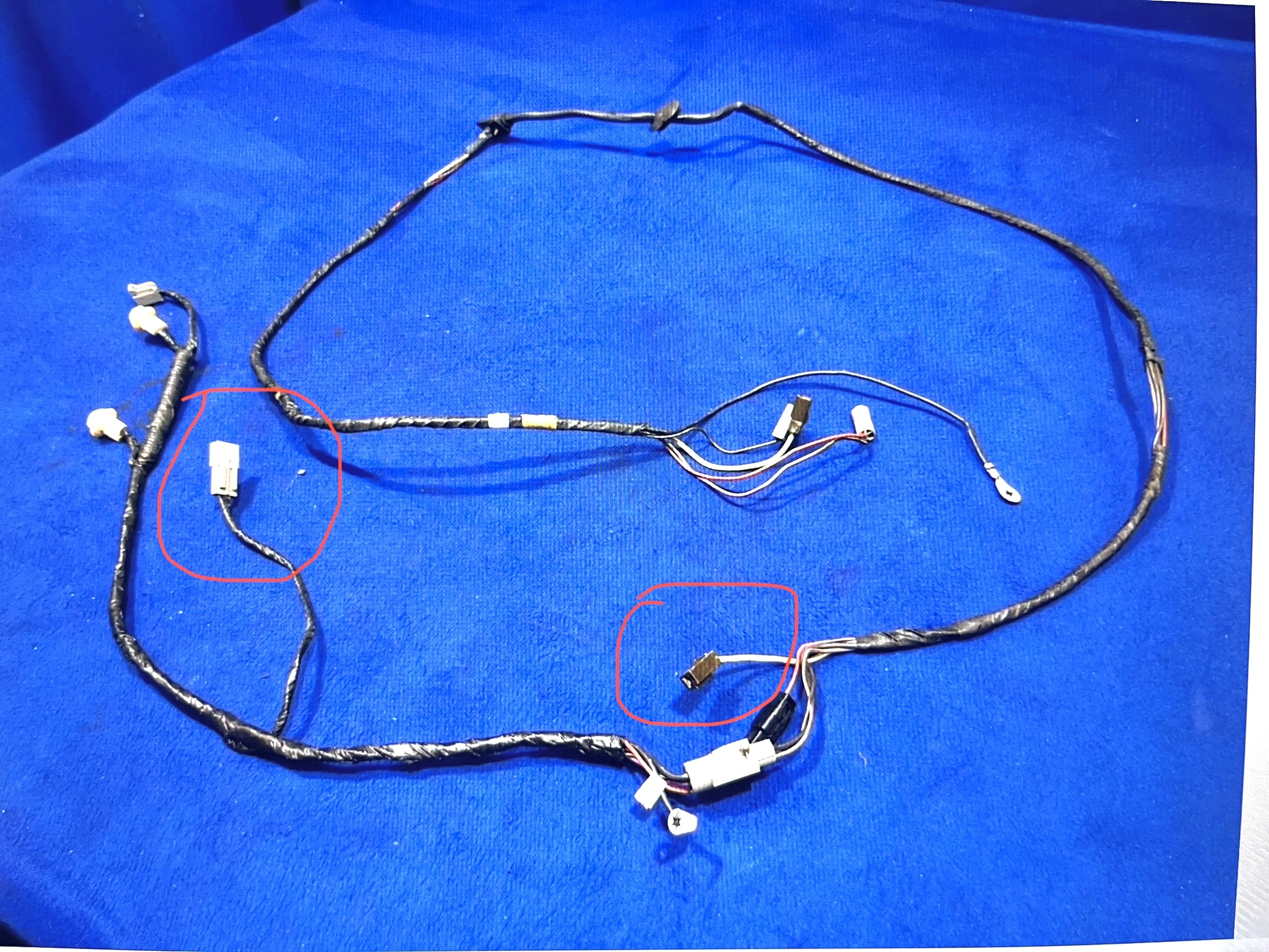

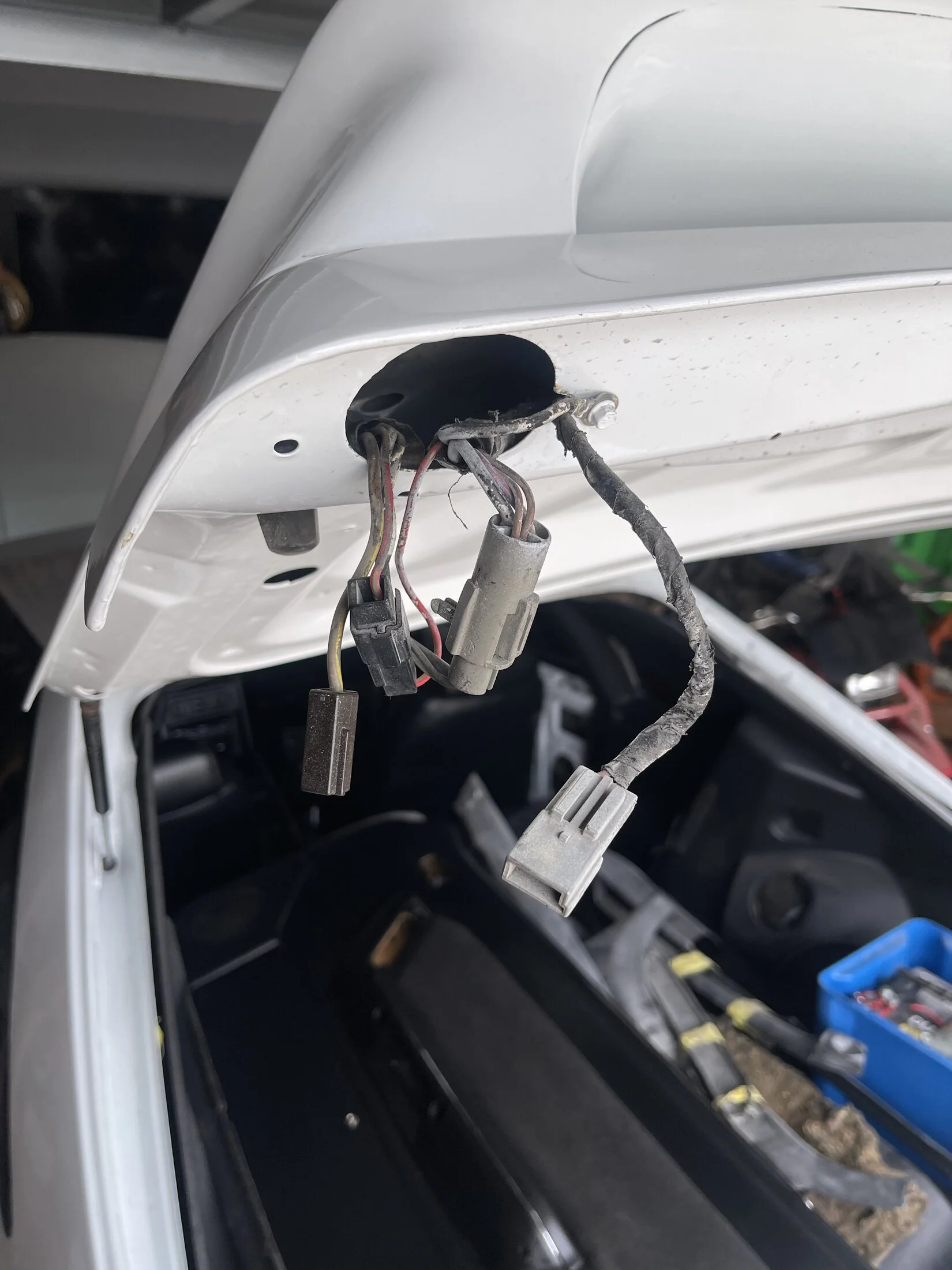

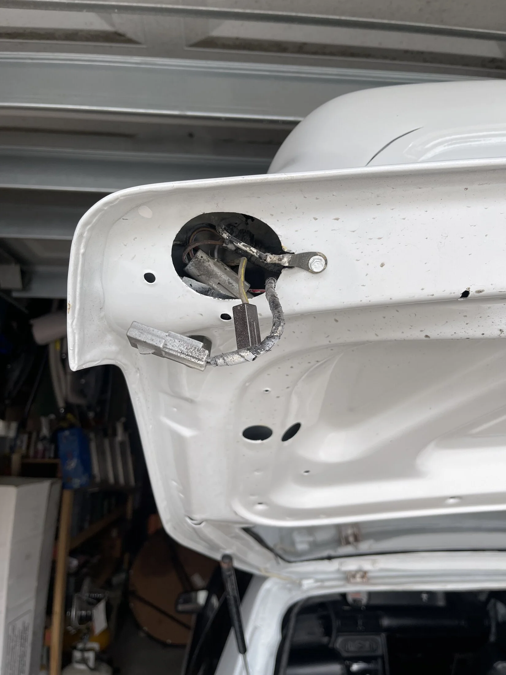

Thanks. How about this wiring harness in the spoiler. It’s disconnected and not sure what connects to what. There is a lot of small stuff that needs to be done.

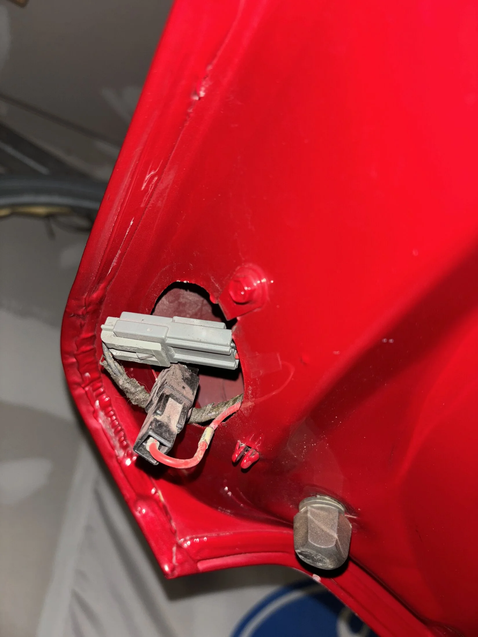

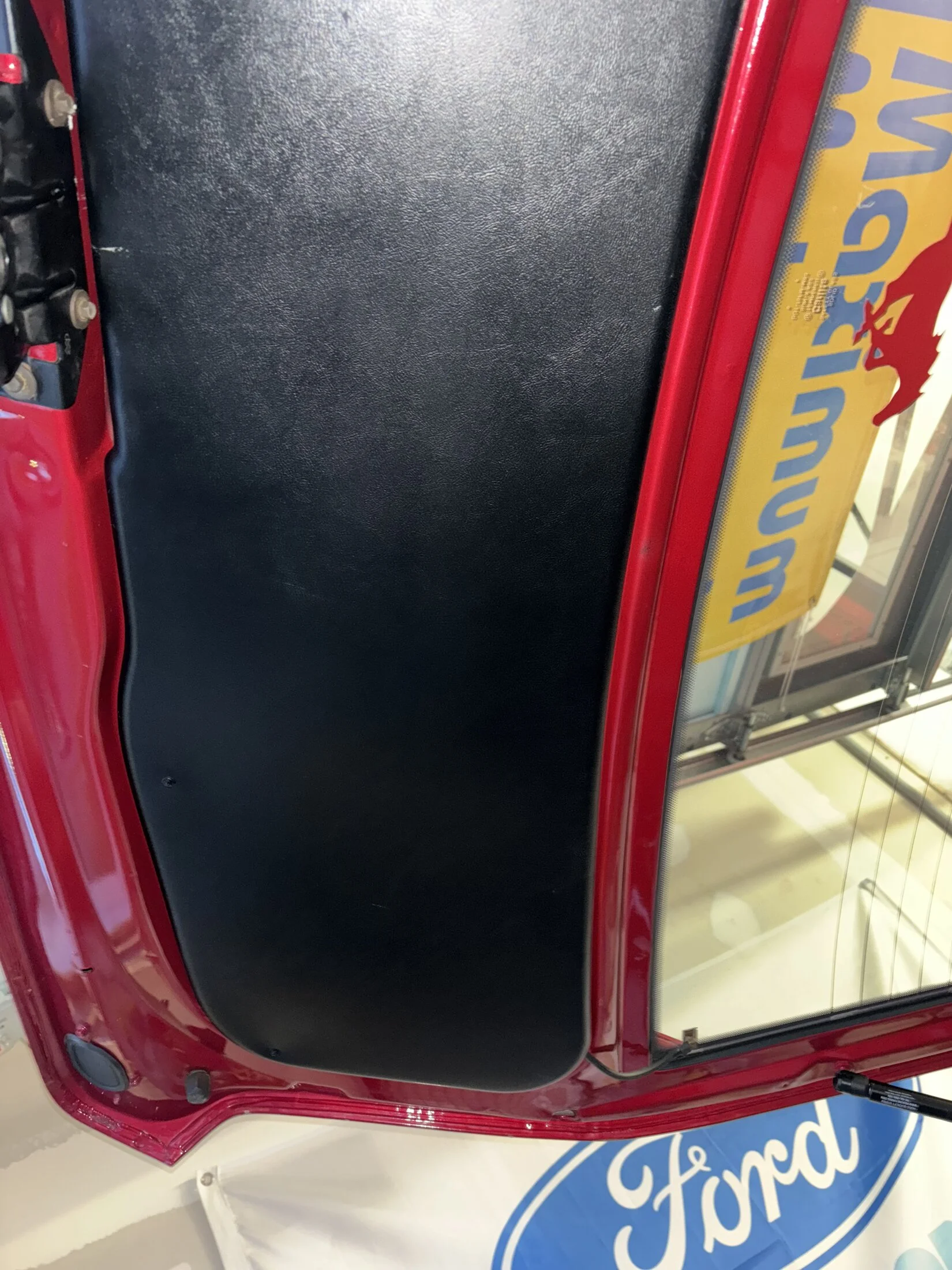

Did you dig around in there for other ends of those connections? Rear defrost, and 3rd brake light, hatch sensor for dome light would be the only thing in the hatch. You should have a harness coming from the car like this:

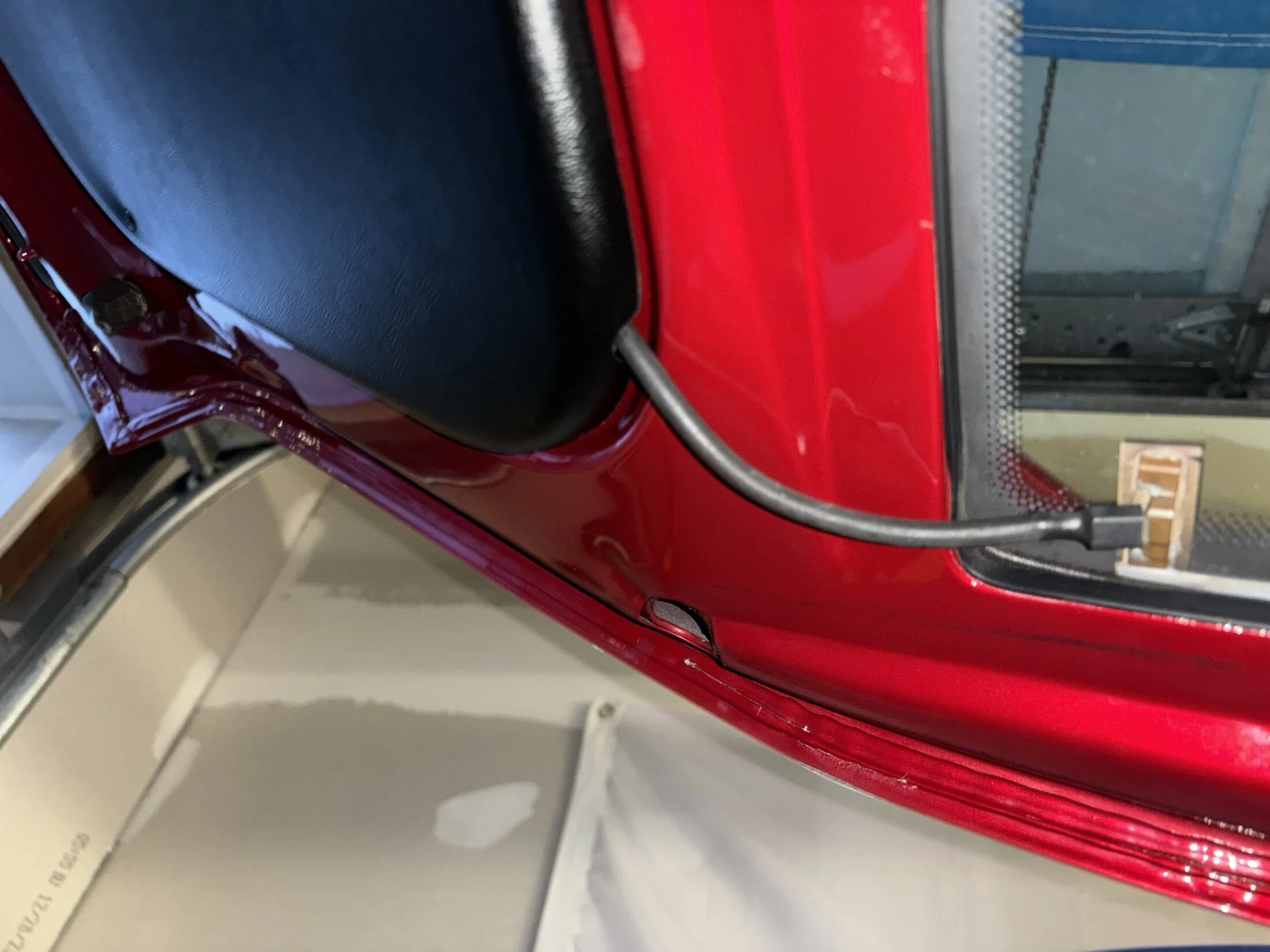

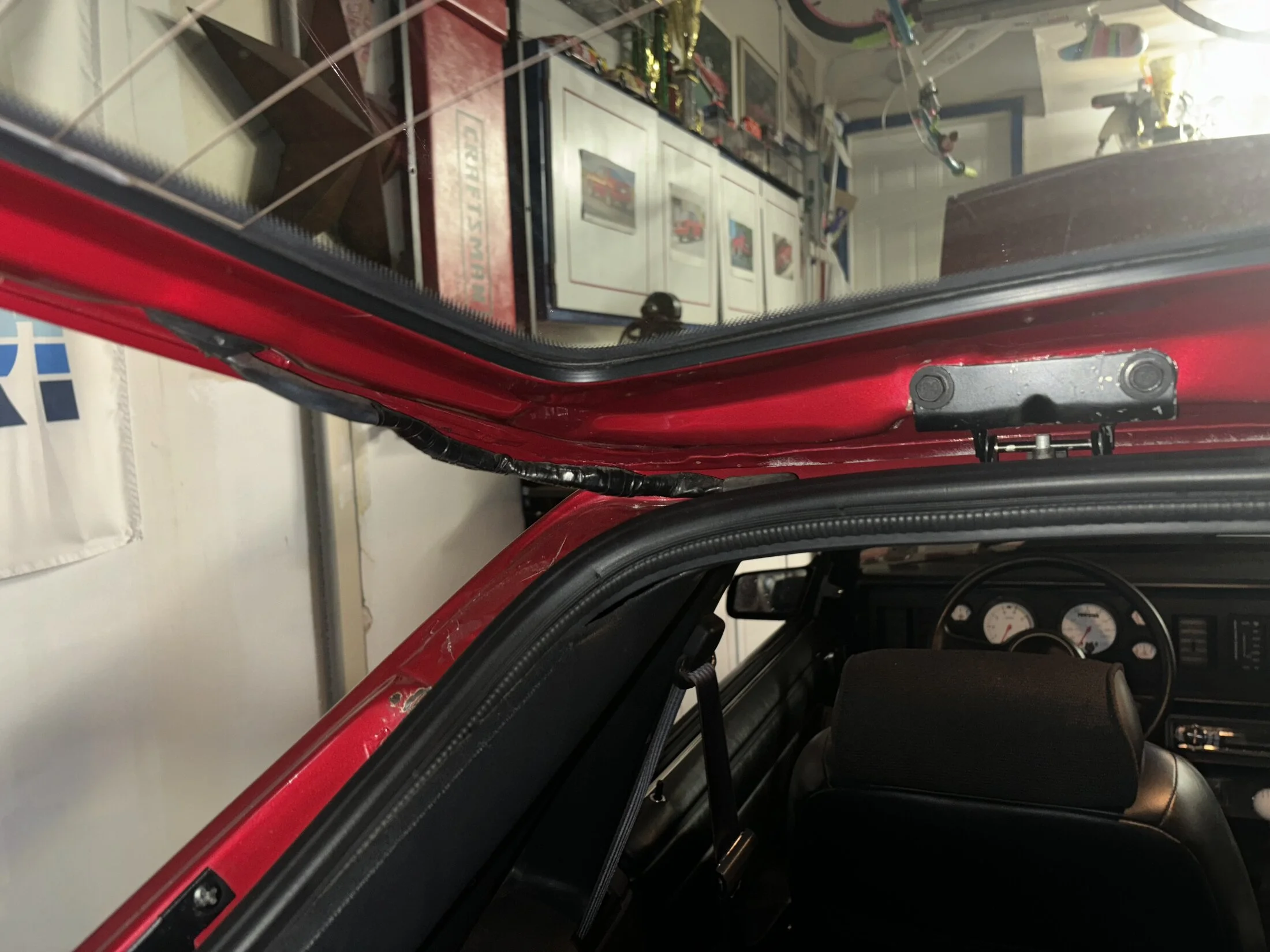

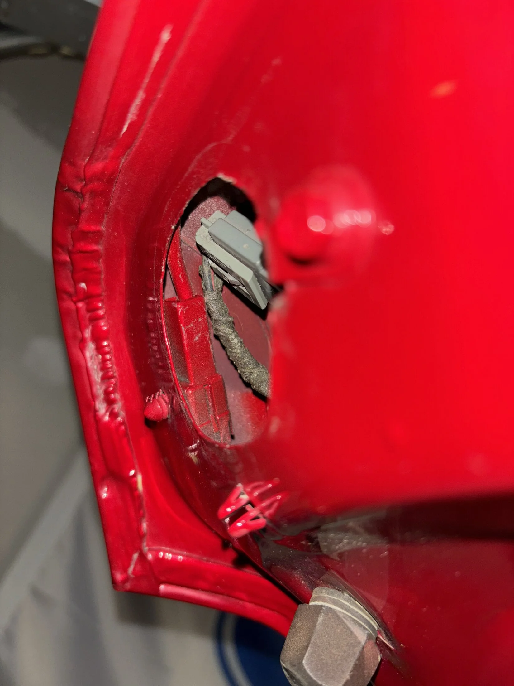

I was curious, so I pulled the rubber plug that goes there to see what I had, and both of those plugs have the other ends of the connections right there.
My car is an ‘86, but the hatch is from a newer car…… but I know the wiring color changed from year to year anyway!
The wire with the ring connector is a ground, don't recall where it mounts, I'll look at mine later if I remember :doh: , the single connector is tag light (I believe) and the other end of that last one is up there close by (3rd brake light?)
Defrost plug goes into the middle area of the hatch, so I don’t think that’s any of those plugs.
I did look inside that rubber plug again. Th other half of that small square connector is fastened right inside the hole with one of those “Christmas tree” push plugs. (All painted red on mine). Take a look up that way to see if the other half is there.
Reactions: Fri Guy
The hatch (lift gate) wiring includes the two tag lights, latch release, if equipped, the wires may still be there if not, third brake light (high mount stoplight). Third brake light has a connector in the corner under the rubber plug and a harness runs inside the spoiler. The rear defrost I believe has a separate harness for the hatch.
