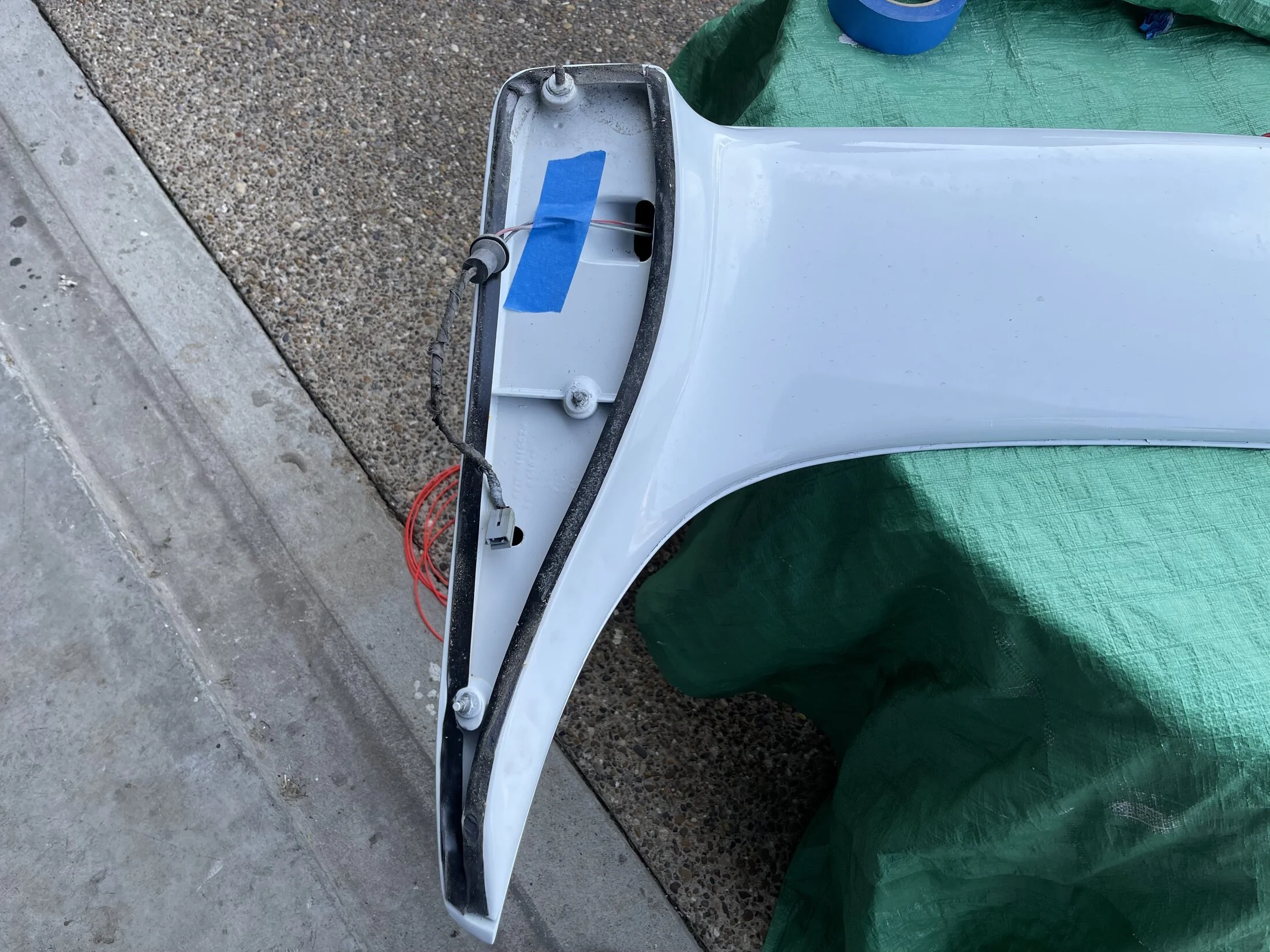

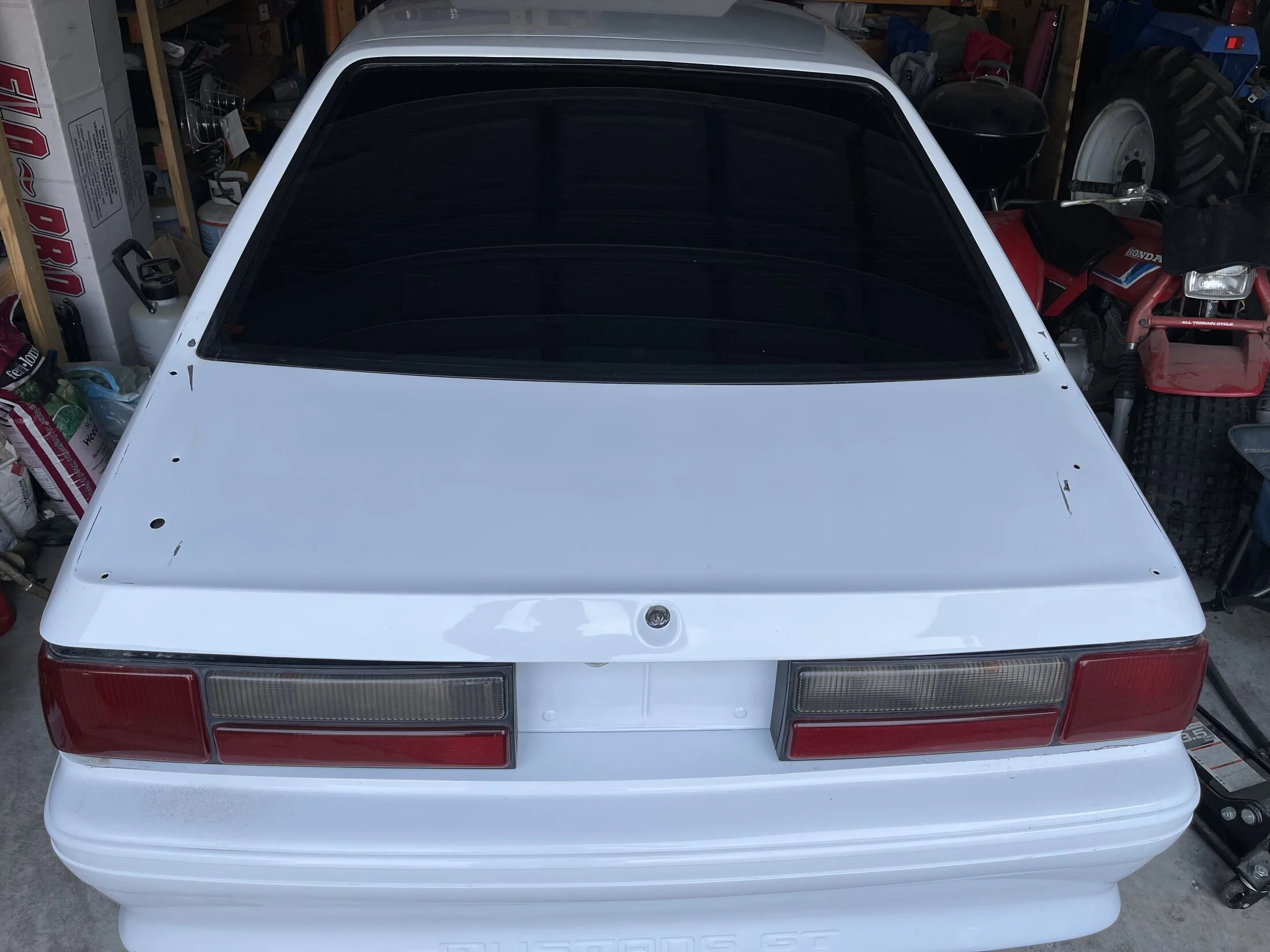

Thanks. The harness from the 3rd brake light should run through the spoiler and through an opening inside the hatch correct? I took a peak inside the hatch through where the plugs are hanging out and didn’t see a harness running through to the spoiler. I also noticed that the spoiler is not bolted down. There are no nuts installed on the studs that stick through but the spoiler seems secured.

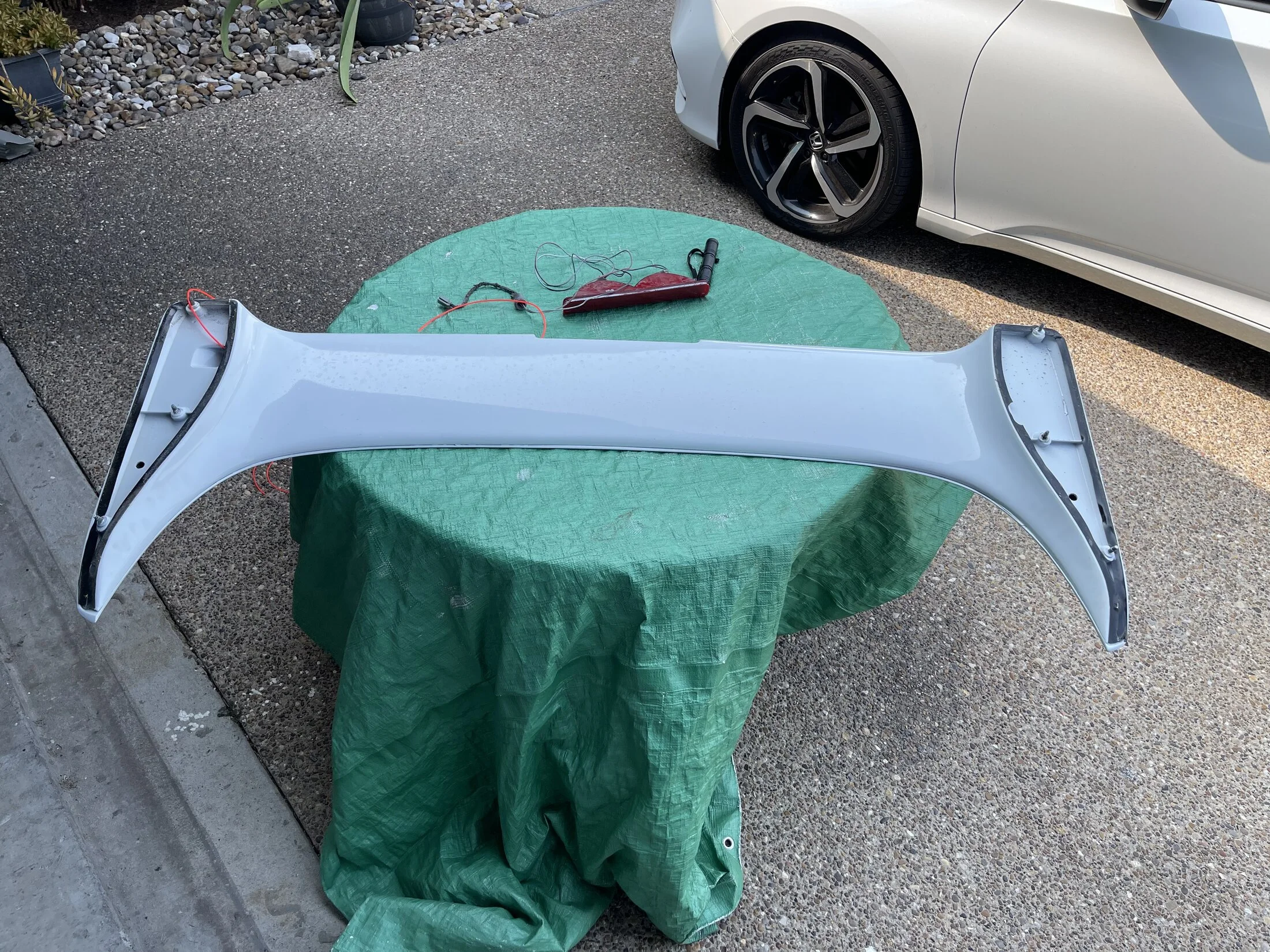

Hatch wasn’t even attacked with any nuts. It was held on with double sided tape. Got it off and noticed the harness wasn’t ran through the spoiler so I fished it through. I’m waiting for some hardware to arrive that I ordered and will install the spoiler with harness ran through the hatch correctly. Should I attempt to remove the tape? Worried that I won’t be able to get it all off.

I'm not an expert on it, but I'd say might as well leave the tape on there but absolutely bolt it back down correctly. It really sucks to see so much half assed but at least the paint does look nice and you can correct the rest.

Yep, I’d leave it there so you are not “paint on paint” once you bolt it down.

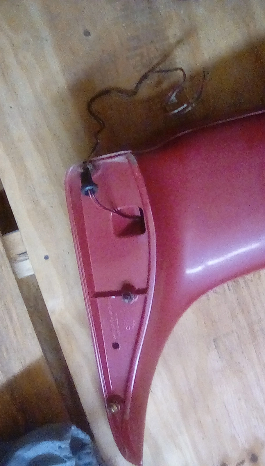

Left (drivers) side, two wires, this one is red and black wires, plug is gone though, grommet goes into the hatch. Didn't look to see what year this one is but it likely does not matter.

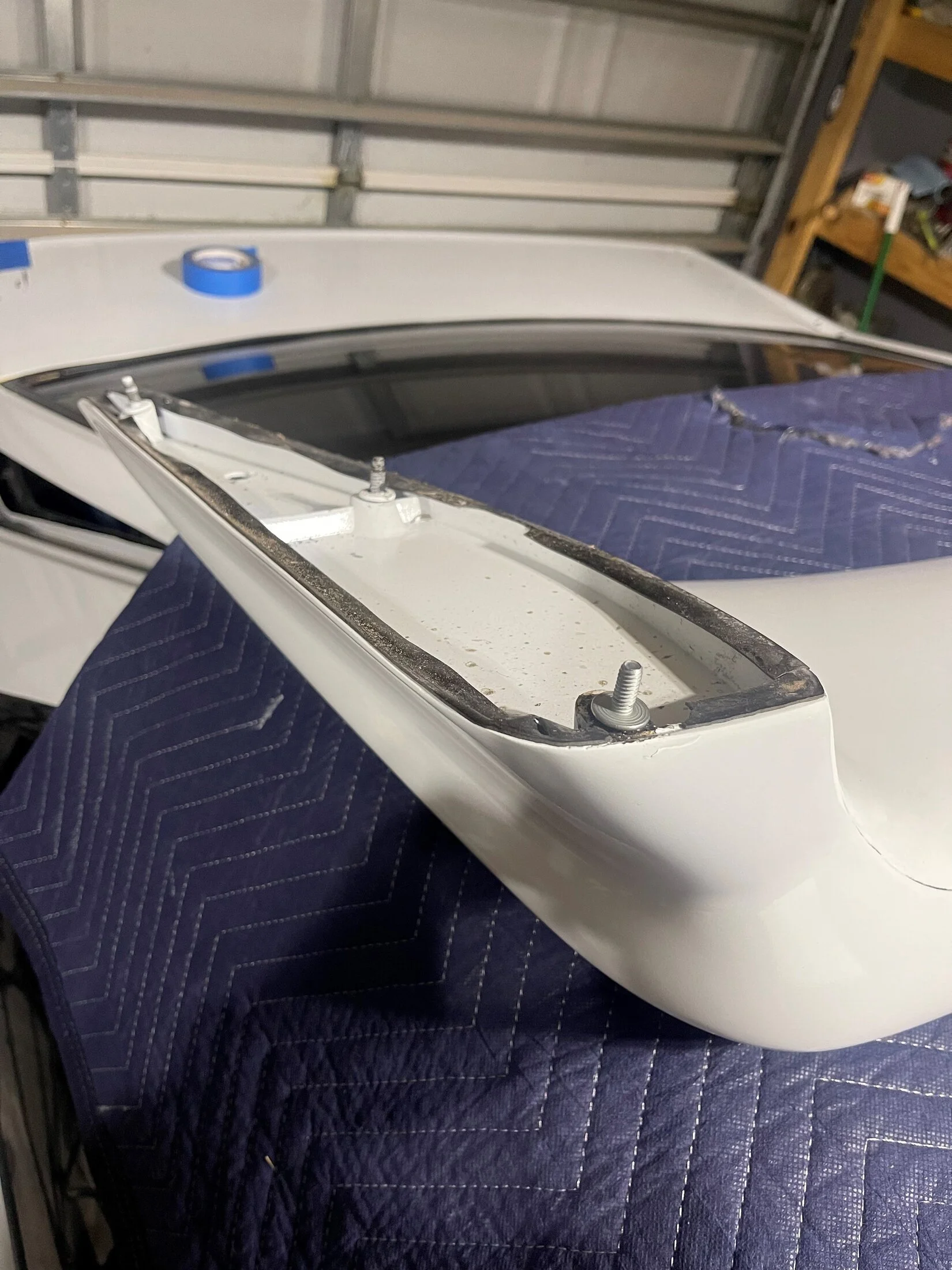

One of the studs on my rear spoiler needs to be replaced. I already have the replacement stud from LMR but not sure the best method to take on securing it to the spoiler. Can I just use some JB Weld or is there a better product to go with?

I would probably use some two part epoxy. Gorilla Glue makes some good two part and you can get it at Lowe’s.

Man now you have me second guessing myself. Any other body shops around that you can call? Other options would be a two part urethane adhesive or fiberglass resin. any of these you would mix them up and then fill the hold about half way full and then install the stud and let it set up.

I spoke with a local guy who does paint and bodywork part time. He's been doing it for years. Said that the JB weld would be best to go with. I'll give it a try and report back in a few days. I plan on letting it cure for about 48 hours.

It seems to have worked well but I haven't bolted it down yet. Planning on doing that later today. This was my first time ever using JB weld.
