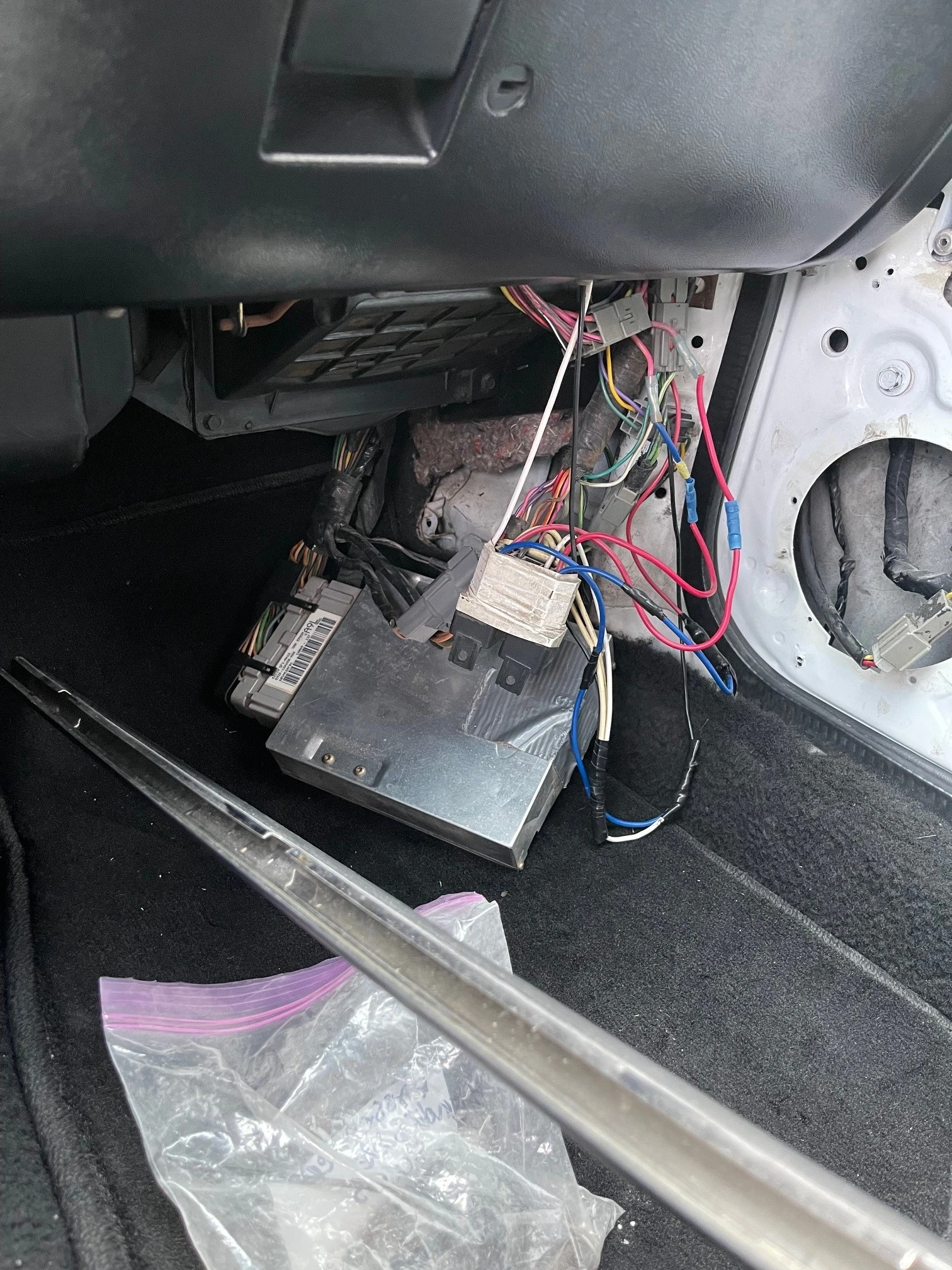

I got the bulbs all situated. Now I'm trying to figure out how to get the computer and wires back behind the kick panel. I do not think the computer had the original bracket installed since the computer has been out of the car before while getting the car tuned. Do I have to remove the blower motor assembly to get everything back behind the kick panel and if those relays are stock? Not sure why there is duct tape on the computer either. Any advice would be much appreciated.

There should not be duct tape on there, and you should be able to buy the bracket at least on ebay I think to install it how it should be. You should be able to get the computer in/out of the bracket without removing the dash or blower motor, but I can't say on those relays.
General karthief
Mod Dude
Aug 25, 2016
28,015
10,641
213
polk county florida
May 13, 2024
#394
  • May 13, 2024
  • #394
I would say those relays with the sketchy wiring is not stock.
I'd be suspicious of that computer with the duct tape, take the opportunity to send the computer out to the ECUExchange and get it checked out, not much money and they are pretty quick turnaround too.
I have seen the same computer mounting bracket on a 5.0 equipped F150 I worked on, I may even have one lay'n around on a shelf,
Maybe
If I spend a couple hours looking, I'm not very well organized.
I am very well disorganized.

Relays are most likely from an aftermarket keyless entry or alarm. If you do not have the key fob then just unplug the relays and see if the locks quit working.
The duct tape is common when there is a chip on the ECU so that is does not come loose. Hell, I still use that trick with my SCT chip on mine. If you pull codes and get a 15 then money there is a chip but you can just remove the tape and see for yourself.

Thanks. The car does have an old keyless entry alarm. Would love to remove it all but don’t want to risk causing an electrical issue.
Car does have a SCT as well. Had it dyno tuned years ago.
Now I just need to get all that back in behind the kick panel and I’ll be good.
