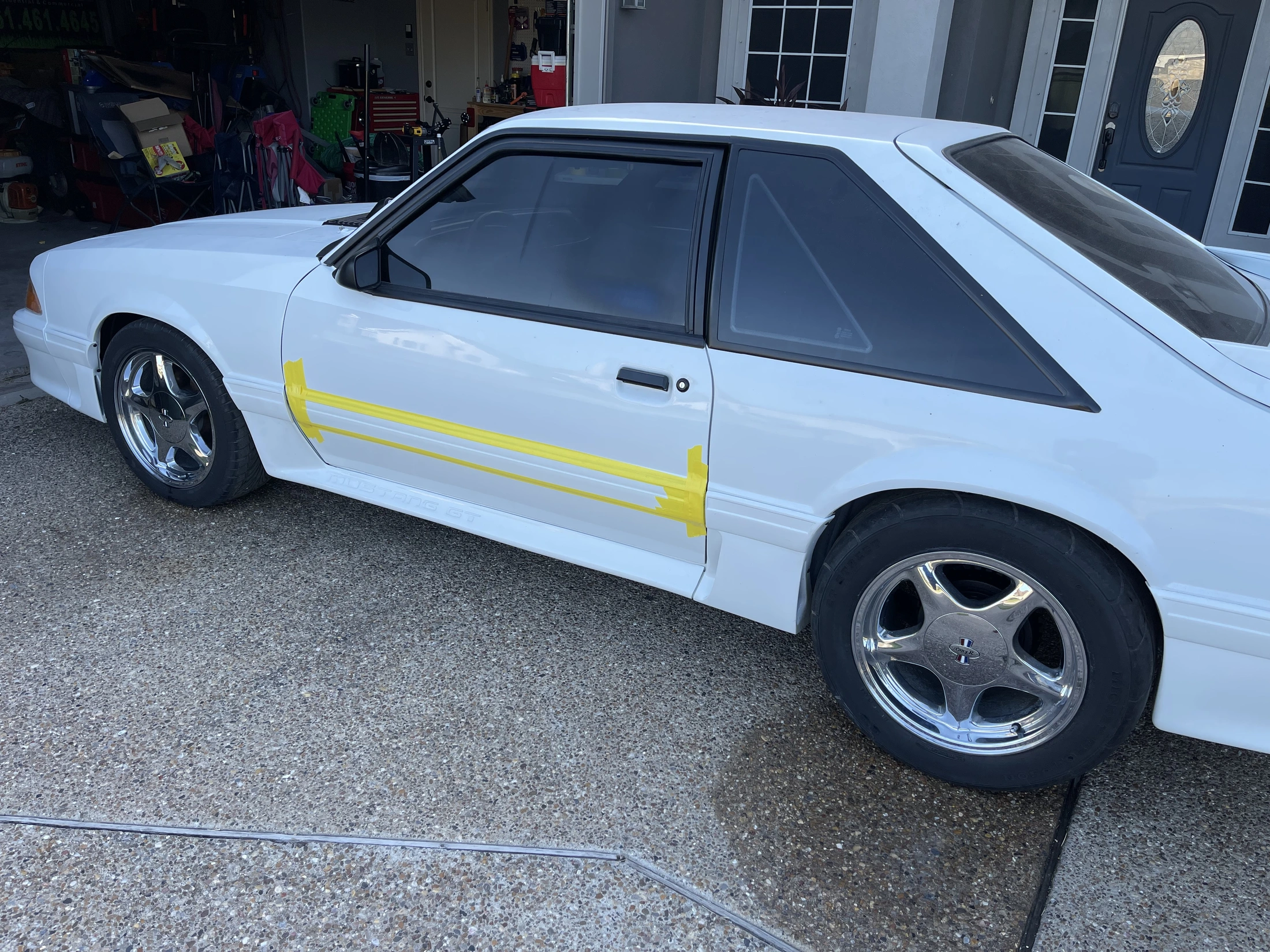

I installed aftermarket door moldings on my car @Fri Guy. I laid them out flat in the sun for a while, laid some painters tape straight accord the door, lined that up with the rocker moldings and stuck em on. Make sure you work from the inside out, or else they may stick out somewhere in the center of the door.Any of you fellas had good luck with installing aftermarket door side moldings? I'm waiting for a good day when the sun is out so I can let them sit out there for a couple of hours. I've read a lot of stories to where they will eventually start to come off at the ends. I'm planning on washing that area, using some sort of cleaner to make sure no contaminants are on the door, applying 3M adhesive promoter, installing the moldings and using a lot of tape over them and leaving it for a couple of days. Any advice would be much appreciated.
Yep, I left that out.It's not 100% necessary however, I like to clean the contact patches for the two-side tape with alcohol just moments before the tape meets the surface.
