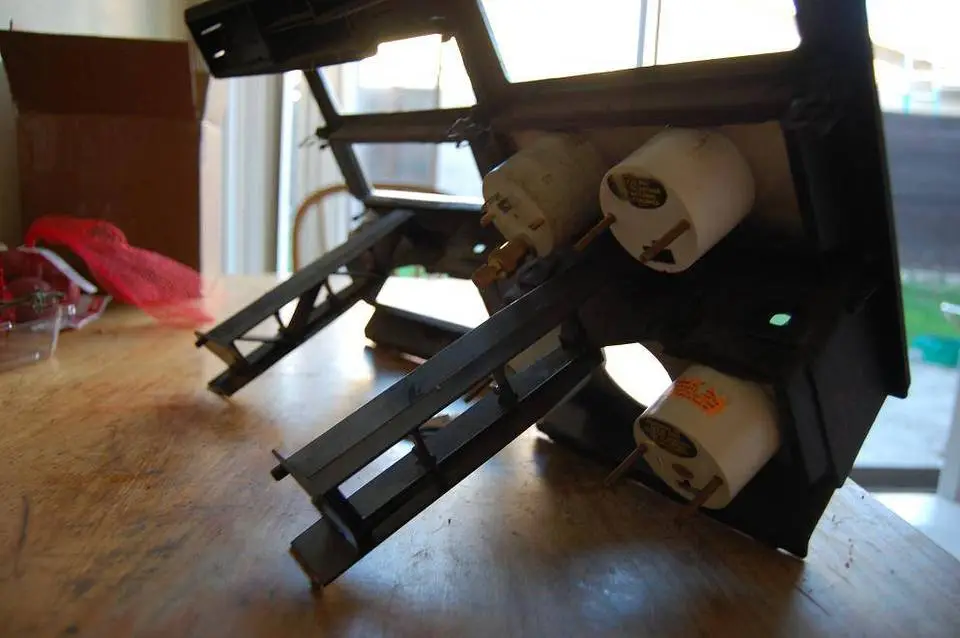

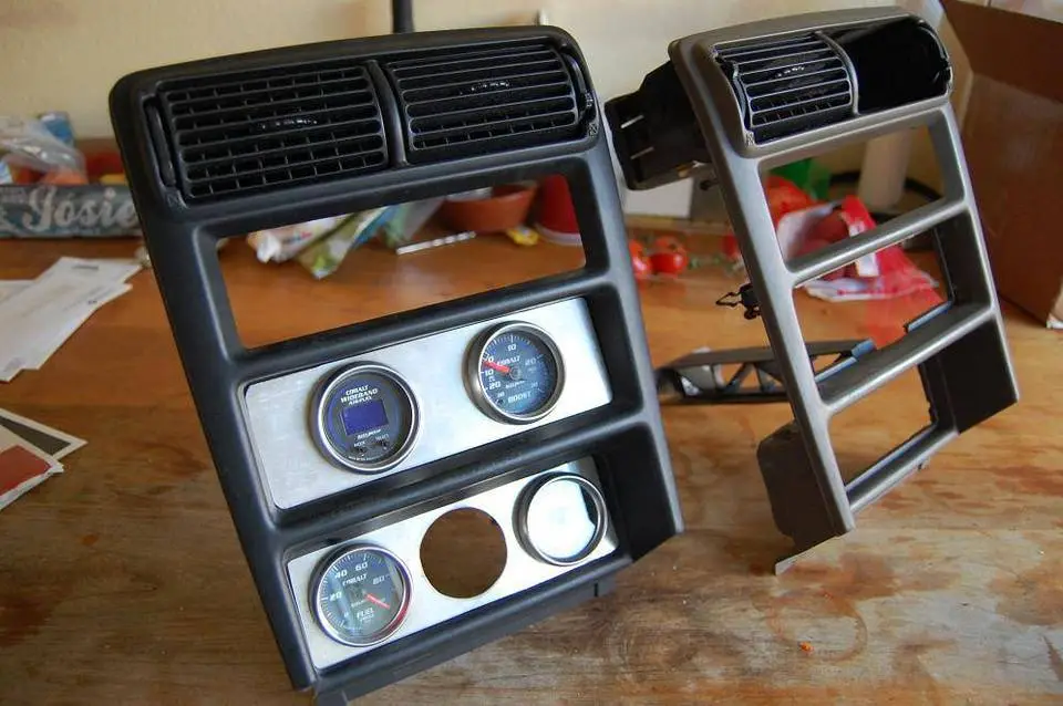

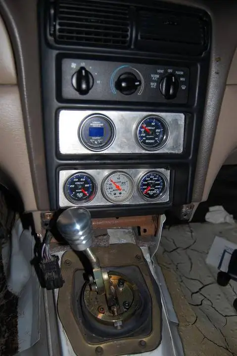

The A-pillar gauge trees are a bit too rice for me, and having them floating around the main gauges and steering wheel doesnt look much better (and limits you to 3 if you use both). Made a couple aluminum plates at work and mocked it up using my old dash bezel cuz I ended up liking the black better. Shifter knob was also made at work.
White gauge was just for mocking up, replacing with oil press.
One "trick" I've seen racecars use (since most of your gauges have red needles) is to mount the gauges so that the needle is pointing straight up when it's in the normal range, regardless of how the gauge face is tilted. That way it's "glance-clear" when a gauge is out of it's "normal" range. ;)
Nice work on the mountings! :nice:
Trans is already sorta that way, but for the wide band not really applicable. And for boost? Normal is what 15-20psi? Lol
And a 94-2000 judging by the bezel. It also has a Pro 5.0 shifter...
I have a similar set of gauges where the OEM CD player sits. Mine is a wrinkled black finish and has boost/oil pressure/wideband in it, although I still have a radio..

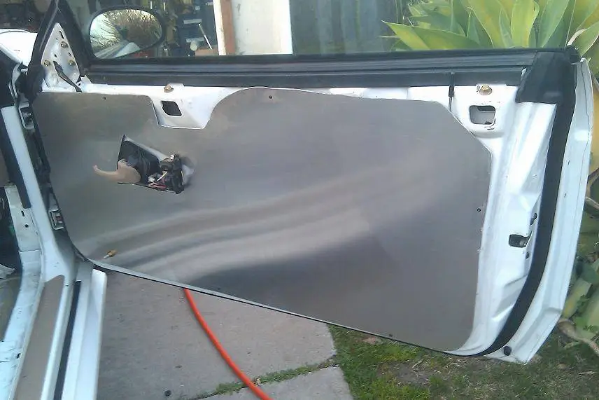

No speakers :( Gutted doors.
