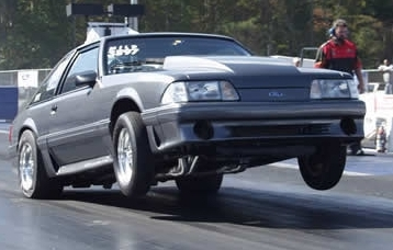

I have noticed this on more than one stang... can you explain the cause?
Whenever I see a fox body get an awesome launch and pull a wheelie the right rear corner dips more than the left...
Is this from torque or weight?
Why do people relocate batteries to the right rear?
Why not the left if this is a common occurence?
fox bodys have a uni-body which is weak so tourque would twist it. as for the battery could be tons of reasons looks? extra room for a turbo saves weight up front too you can put the battery where every you want either side i have seen em go everywhere.
The engine rotates counterclockwise as you're standing in front of it. The torque it puts into the unibody twists the unibody that way. Cars that have proper unibody reinforcement, and suspensions optimized for drag launches don't do that - they launch straight and even side to side.
if the car is setup right for drag then typically it shouldn't do that... Look at my avatar// With my Anit-roll setup the car leave nice and level every time.. As for the battery I think some people do it to try and even out the driver some... Mine is located center of the hatch.. Also with the spare tire well back there it's much easier to put it on the side..
here is a bigger pic

Stangbang - I meant exactly what Perky said 2 posts later, if fact we both said almost exactly the same thing - look at his launch - straight and level side to side; both front wheels pulled an even amount; rear end is level too. The more the unibody is stiffened, and the rear suspension is optimized to launch straight and level, the more the engine's torque gets applied to moving you forward quickly (assuming traction) instead of some of it being absorbed in twisting the chassis.
