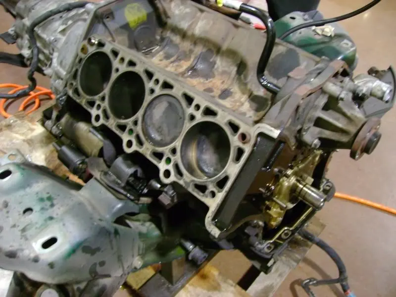

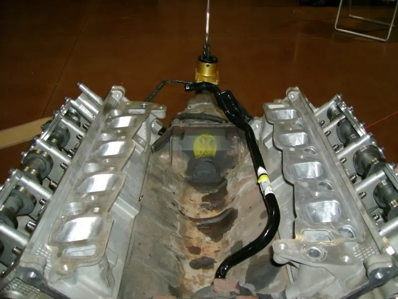

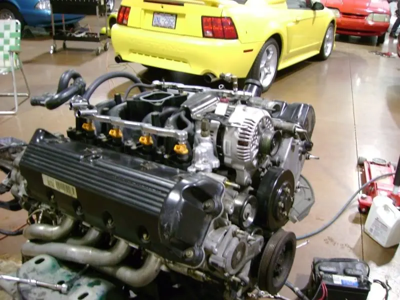

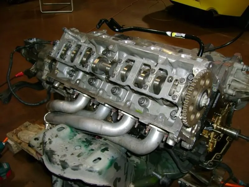

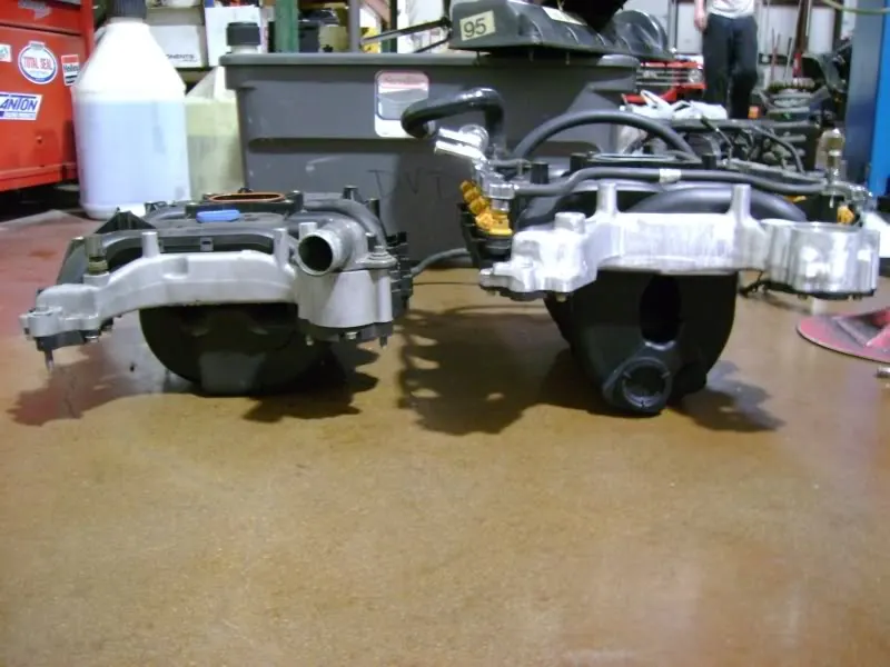

Well It took 2 days to do, but I got the swap done:D I'll have pics and more posted later tonight. The car is getting dyno tuned right now and I'll know the power soon:D
List of parts that when on
Ported PI heads PI intake, and stock pi cams
Bassani Mid headers
Custom made mid pipe
C&L 80mm maf
coolant mod
and a dyno tune
I did order a set of VT stage 1 cams, but I could not get them in time for the swap, and after reading all the bad stuff that happened with VT I cancelled my order.:nonono: The last time I dyno'd my car I made around 230hp with a tune, and with out a tune I made 217hp. I'm hoping for big numbers!
Well I got the car dyno'd it made 250rwhp w/out a tune @5400rpm and 289rwtq @ 4200rpm. After Randy Haywood tuned my car it made 271rwhp@5600rpm and 301rwtq@4200. Thats right 21hp in just a tune! Thats for people that say you dont need a tune after a pi swap. And Randy told me theres more power to come if he had bumped the time up, maybe around 10 more rwhp there! The car @ 6000rpm made 80rwhp over the non-pi heads! The power was well over the setup I had before. I will post some pics soon!:D

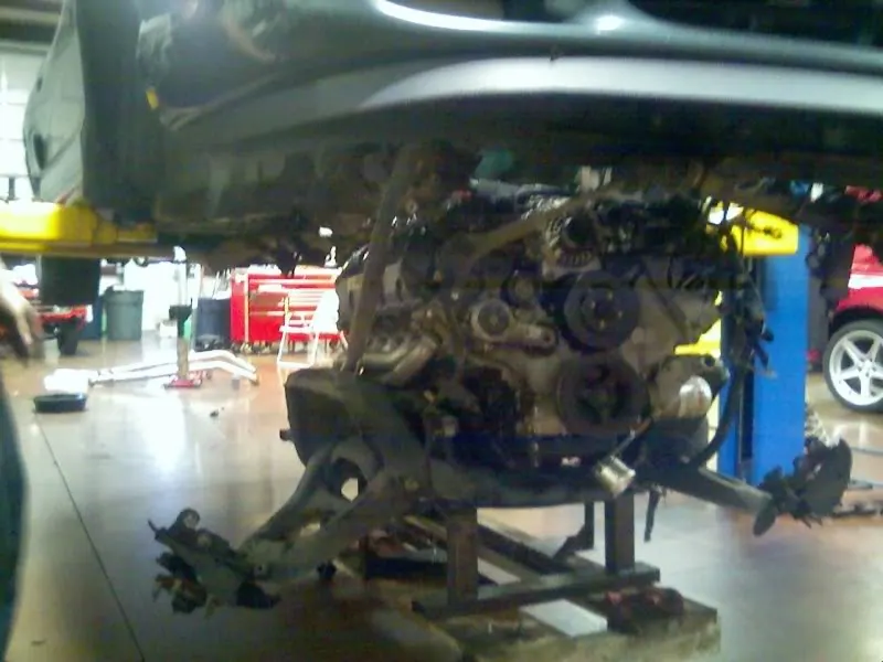

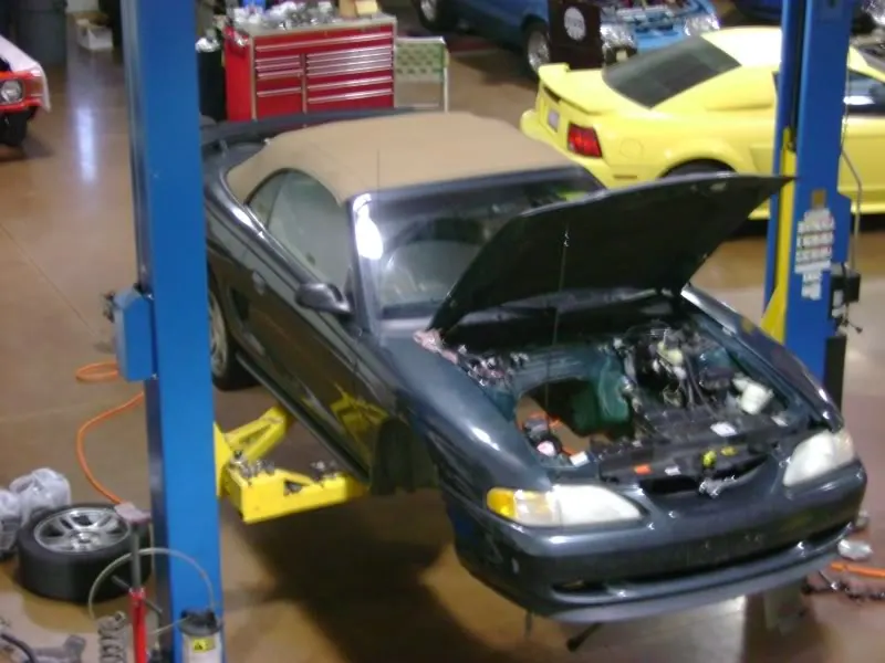

The Only way to remove the engine
150,000 miles and 210psi on compression test and still had the cross hatching on the walls

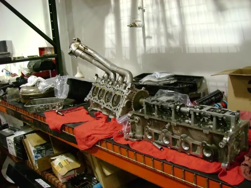

Non pi vs Pi
Headers away!
getting there!
Ported heads:D

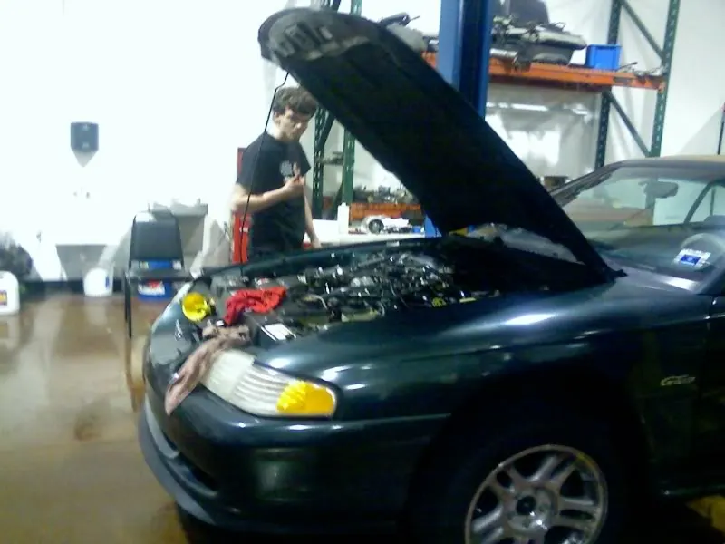

Almost there!
:D
and My brother oh and the car is done
