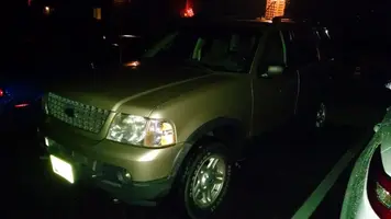

Ever since last winter I've been combing the local CL ads for some kind of 4WD vehicle that I could use for the upcoming winter(s), hauling stuff, and other use (the GF also isn't crazy about riding in the GT for extended periods...prefers something more comfortable and quieter..hmph) like taking it camping, taking longer road trips, etc.
The other day I saw an ad for an '03 Explorer XLT for only $1000. Has 320K on the clock. I went to check it out and take it for a test drive...this thing is actually still quite strong. It will need a few little things to get through inspection but nothing major...needs a taillight, a foglight, new tires, and a tailpipe. There are some cosmetic things it could use too, like a good interior detail, there's a dent in the tailgate, and the panel below the rear glass is in primer. No leaks...handles and rides well...all the miles were apparently highway mileage...I'm hoping this thing will serve me well at least for a little while. But if I have to dump too much into it to get it through inspection, I'm just going to sell it off.

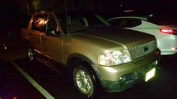

So here's a lousy night shot or two of my new ride...

If there is no rust, the miles would not bother me. Make sure the electrical and emissions are OK, then go in style this winter!
Thanks...I'm planning on it and hope the inspection checks out. Body and frame look solid...my dads 2005 Explorer has about 80K on it and there's all kinds of surface rust on the frame rails. This doesn't seem to have any of that.
I'm waiting on a few smaller parts to arrive this week then I'll run it through inspection and go from there.

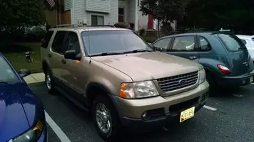

I have cleaned the interior up a LOT since getting it. It looks so much better inside now. I dumped baking soda all over the carpet and let it sit overnight and the next day while I was at work, then took it to a cheapie car wash nearby and had them do their interior treatment and give it a quick bath. It cleaned up pretty nice.
These shots are from the day after I got it, while it was still daylight out.
