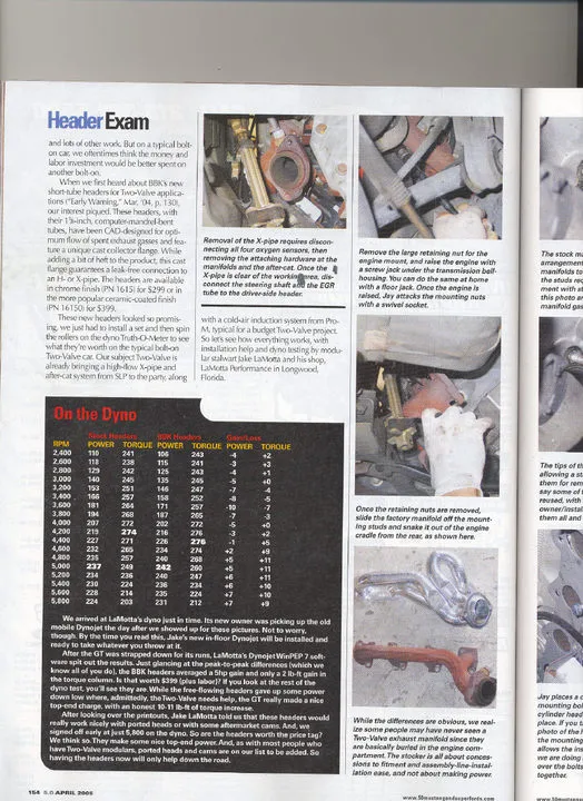

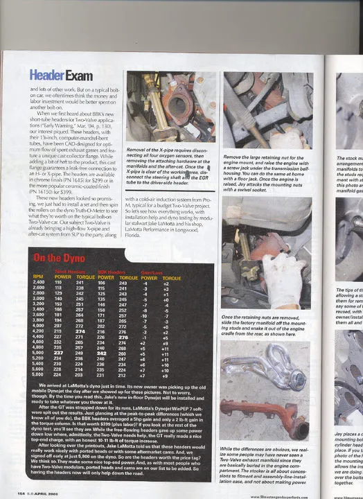

That settles it for me. If you have to do the same basic install for shortys than for long tubes, it amazes me they sell any shortys at all. I'd still like to see a dyno of an equal length shorty to see the difference. Thanks for the info.
Here's a dyno article.
