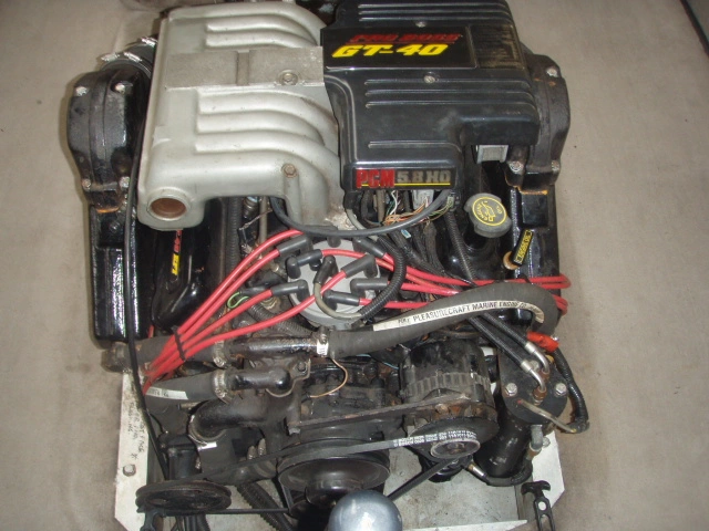

Pics Of Cobra Intake I Found And Ordered
where did you find this picture? I can't seem to find any info about this marine intake.
Google "GT40 marine engine"
if my current intake w. EGR spacer will bolt on to this fine, i will probably go with this.
That's a Ford explorer intake without the EGR passage. It will work, but you are deleting the EGR.

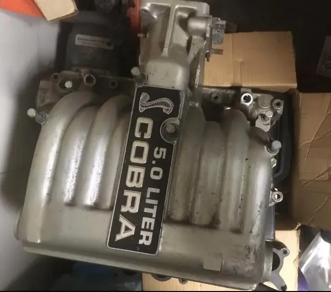

found a genuine cobra intake/lower/ spacer. Guy is asking 650 for everything. Not sure....
The price of genuine cobra intakes is going up, but $650 is too much. I've seen them complete upper+lower for $300-400.
But, unless you have a thing for the look of the cobra intake, the explorer intake is pretty much the same thing....for way cheaper
