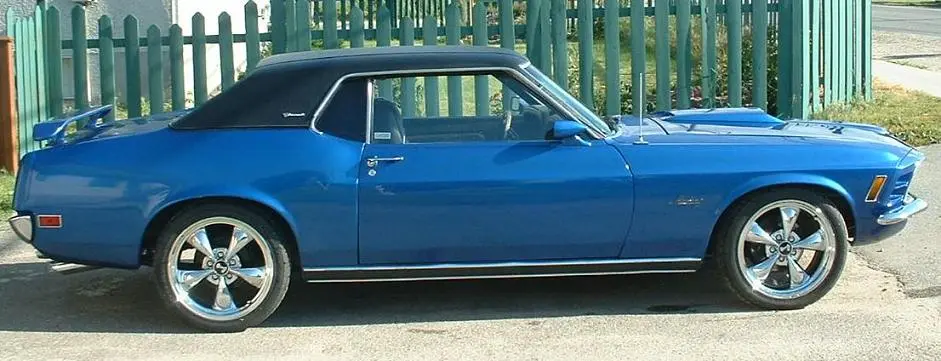

I needed wider rubber. Not a problem in the rear..I switched to 275/35/18's. The front tho was a bit of a problem. I couldn't stuff any more rubber under the fender..especially if I wanted to go lower. So I ended up sending the front 2 wheels to get narrowed 1" down to 18"x8".
Here's a pic with new 275 rubber in the rear, front wheels narrowed to 8", and lowered another 0.5" rear and 1" front (2.5rear and 3 front total).
attachment.php

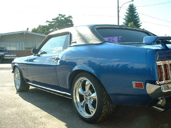

Now I think I'm happy with the new look. I ended up having to roll the front fender lips, but it was worth it. Handling is much better now also :D

A67StangMaster said:
I would drop it alittle more.. maybe 1 more inch
I like it when the tires are close to the flairs...
They are like that in the front. But in the rear they are higher. Mostly because I like a raked stance. I also don't want to worry about carrying passangers and a full tank of gas with the 275's.
It does look much better. My old car had/has the too big in the back look back then too with 14 x 10 and 50 series tires from the 70's / 80's (still have them on it right now in fact) but I will be doing the same during the rebuild.
I agree it would better a bit lower but understand stopping there.
What did you do to lower? Cut coils on the front and blocks on the back or different springs? Just curious as I need to buy springs soon.
-Stephen
-Stephen
Cut 1&1/4 coil up front (stock coils). In the rear I replaced the stock leafs with a set of 5 leaf reverse-eye springs.
Steve69 said:
Nice Pics, Did you have to use spacers on the rims?
Yes and No.
These wheels come stock with 6" of backspacing.
Before I had the front wheels narrowed, I was running a 1" spacer...after narrowing 1" I ditched the spacers (another benifit of narrowing the wheels).
For the rear I originally had 1" spacers with the 245's, but changed it to 0.5" when I swapped to the 275's.
I'm really happy with the wheel/tire fitment, since rolling the front fender lips they havn't rubbed once.
