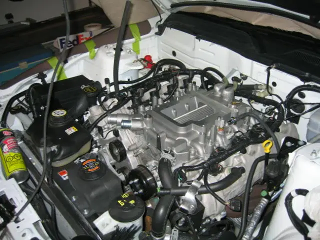

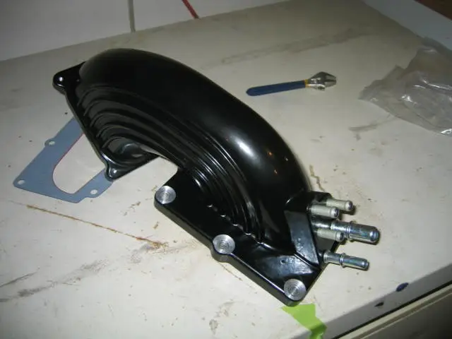

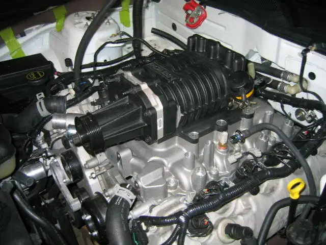

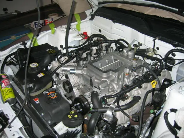

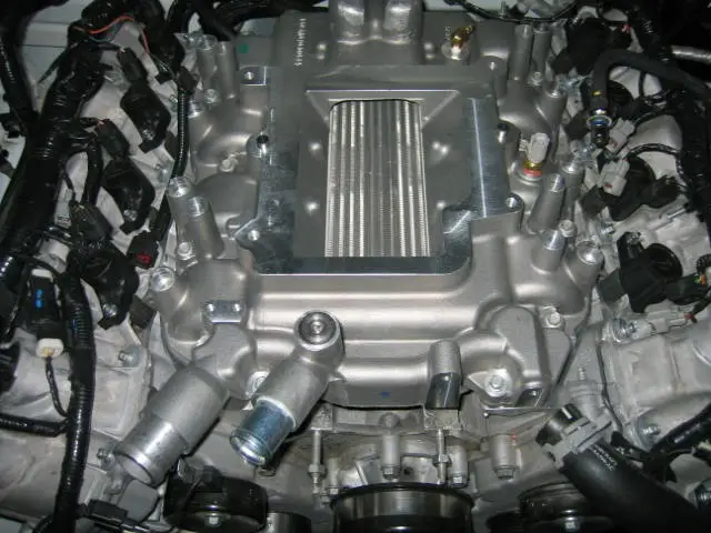

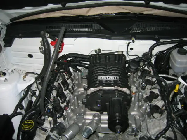

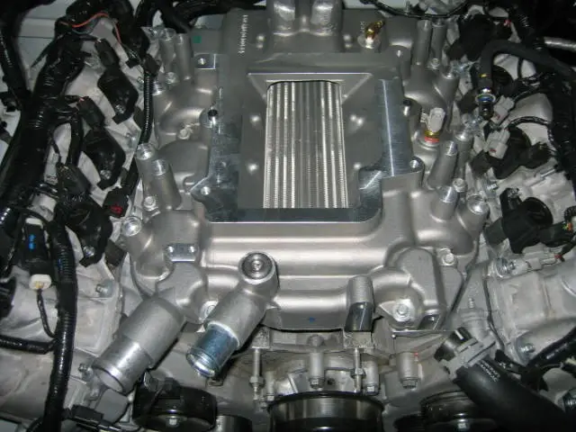

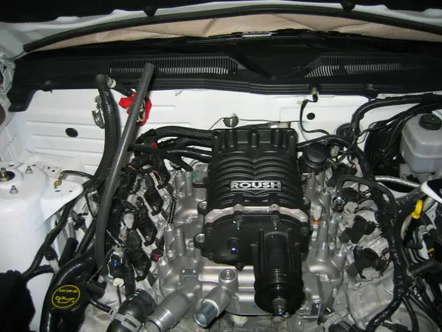

Now we are getting to the best stuff so far. The intake goes on !!!!!!!!!!!. You can see intercooler in mainfold hole where s/c will sit

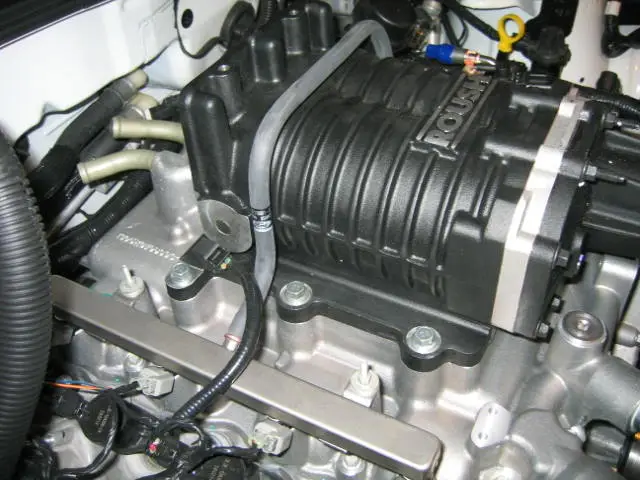

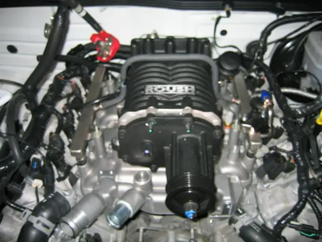

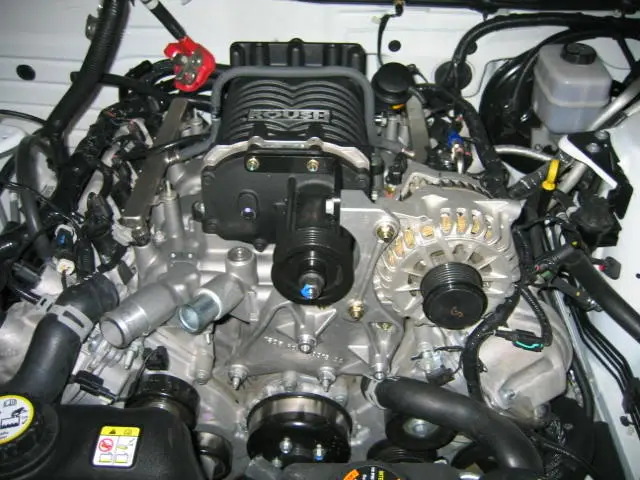

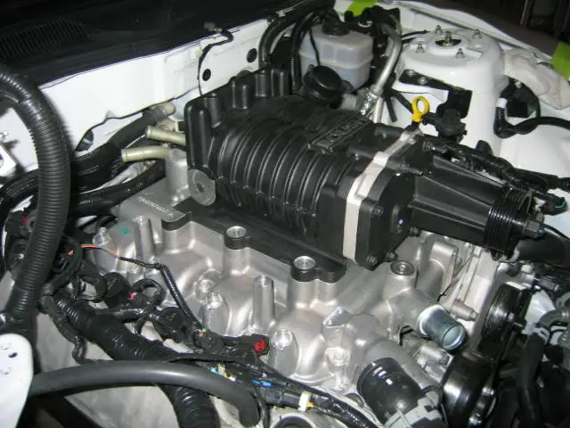

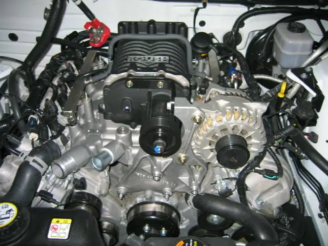

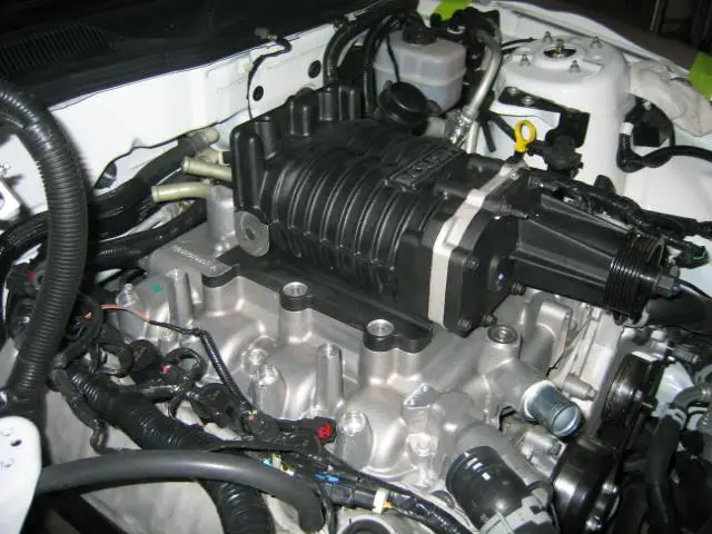

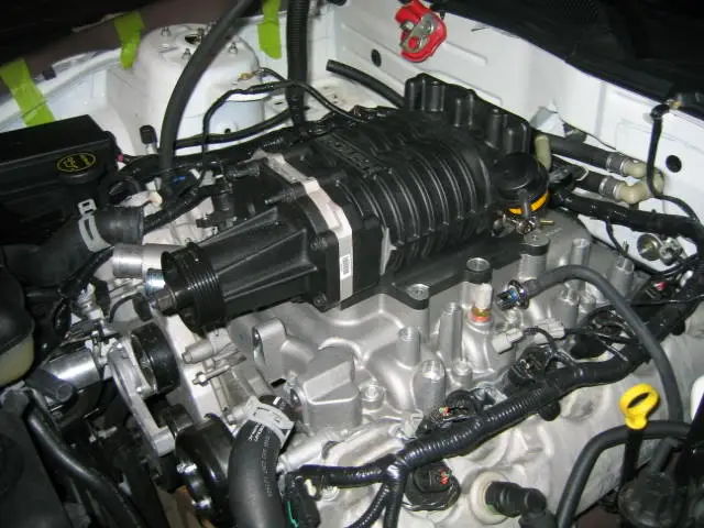

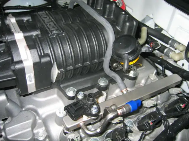

Then the s/c goes on!!!!! Now it is starting to look totally awsome now!!!!!!!

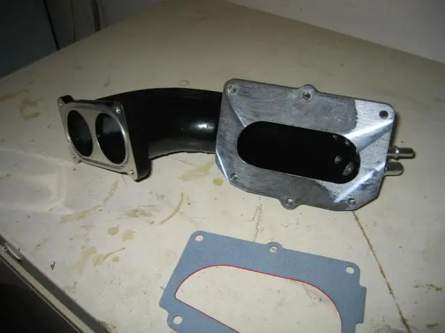

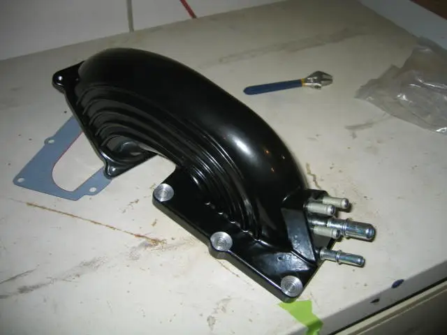

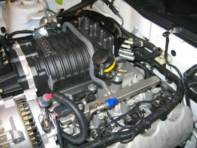

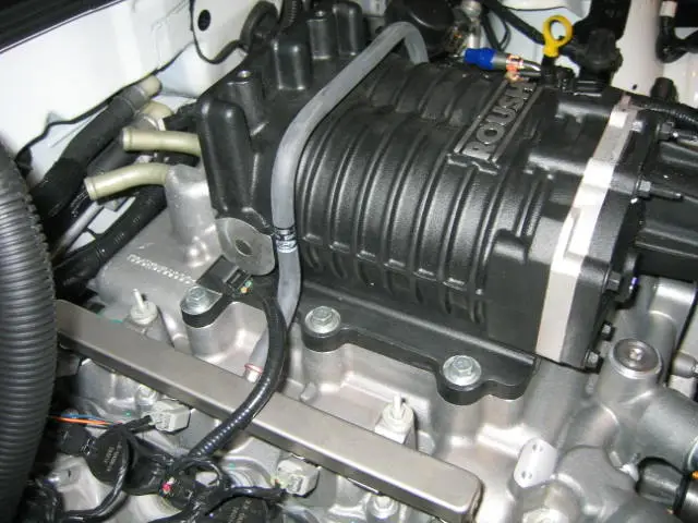

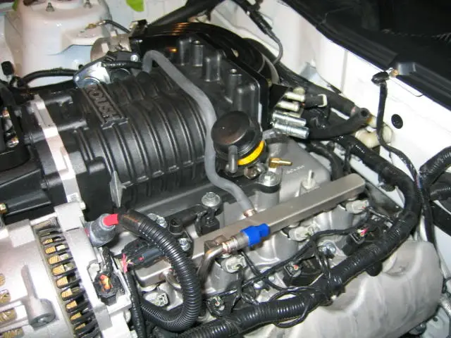

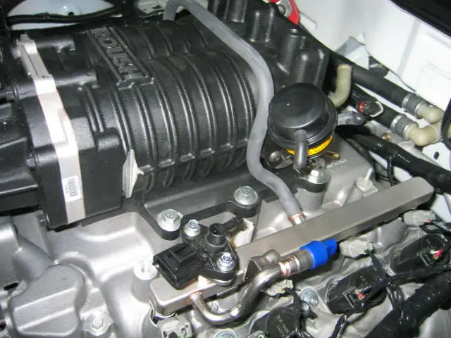

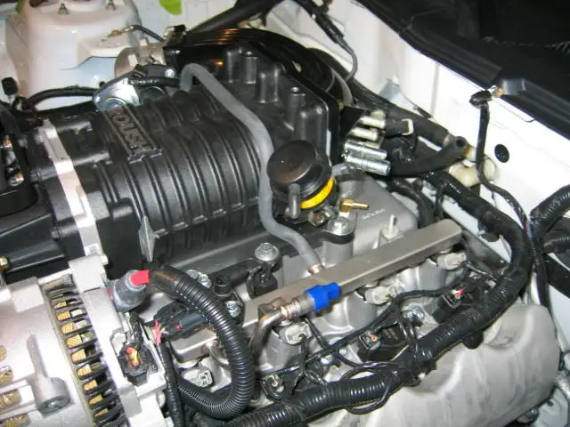

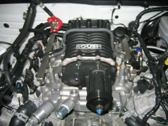

Then we installed the new fuel injectors and fuel rails. Notice how the crosover tube goes over the s/c

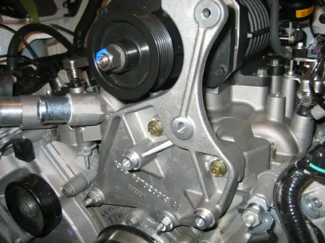

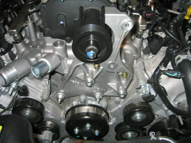

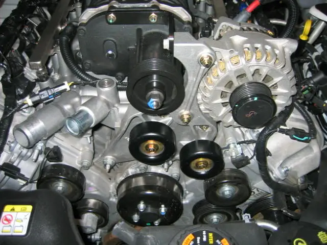

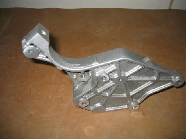

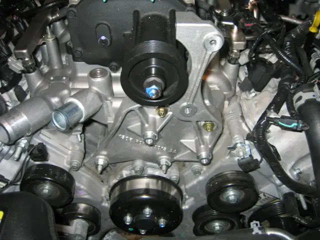

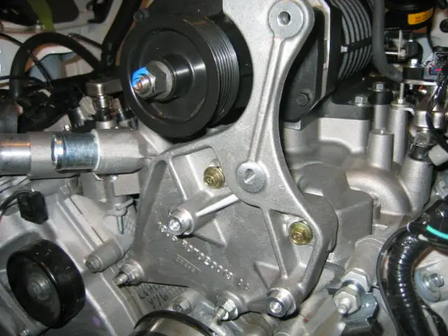

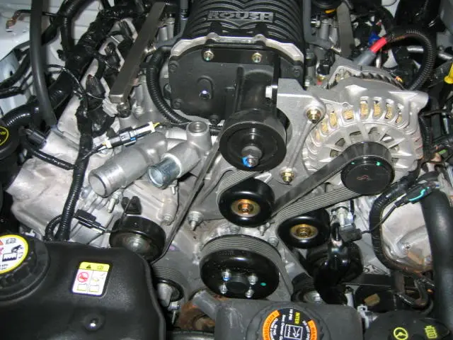

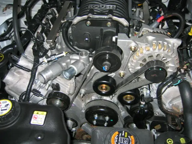

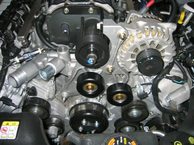

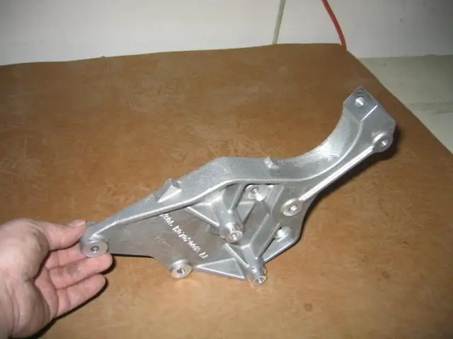

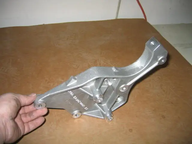

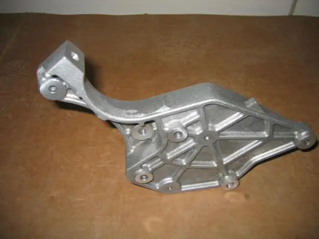

We now had to mount the new alternator bracket. It is of high quality aluminum and it mounted on the 2 studs from the old location. It Looked like a factory piece high quality when installed. .We the installed a couple of idler pulleys and installed the new belt. Just one belt drives everthing. Belt was alost as tall as me. Definetly the page that shows where the belt goes is a must keeper in car in case you ever have to replace or remove belt. Even with the instructions it was a maze lol.

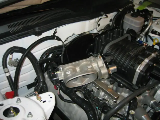

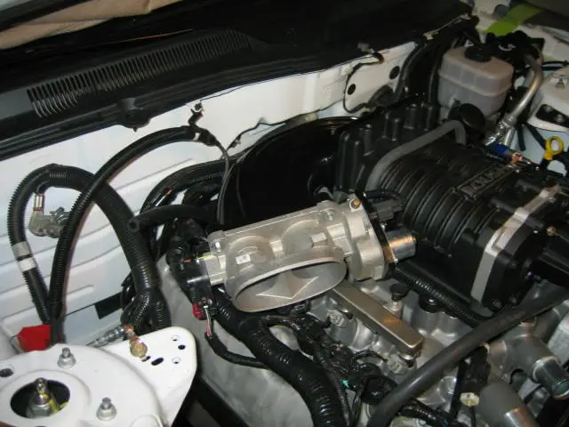

We then installed the throttle spacer and the throttle body
